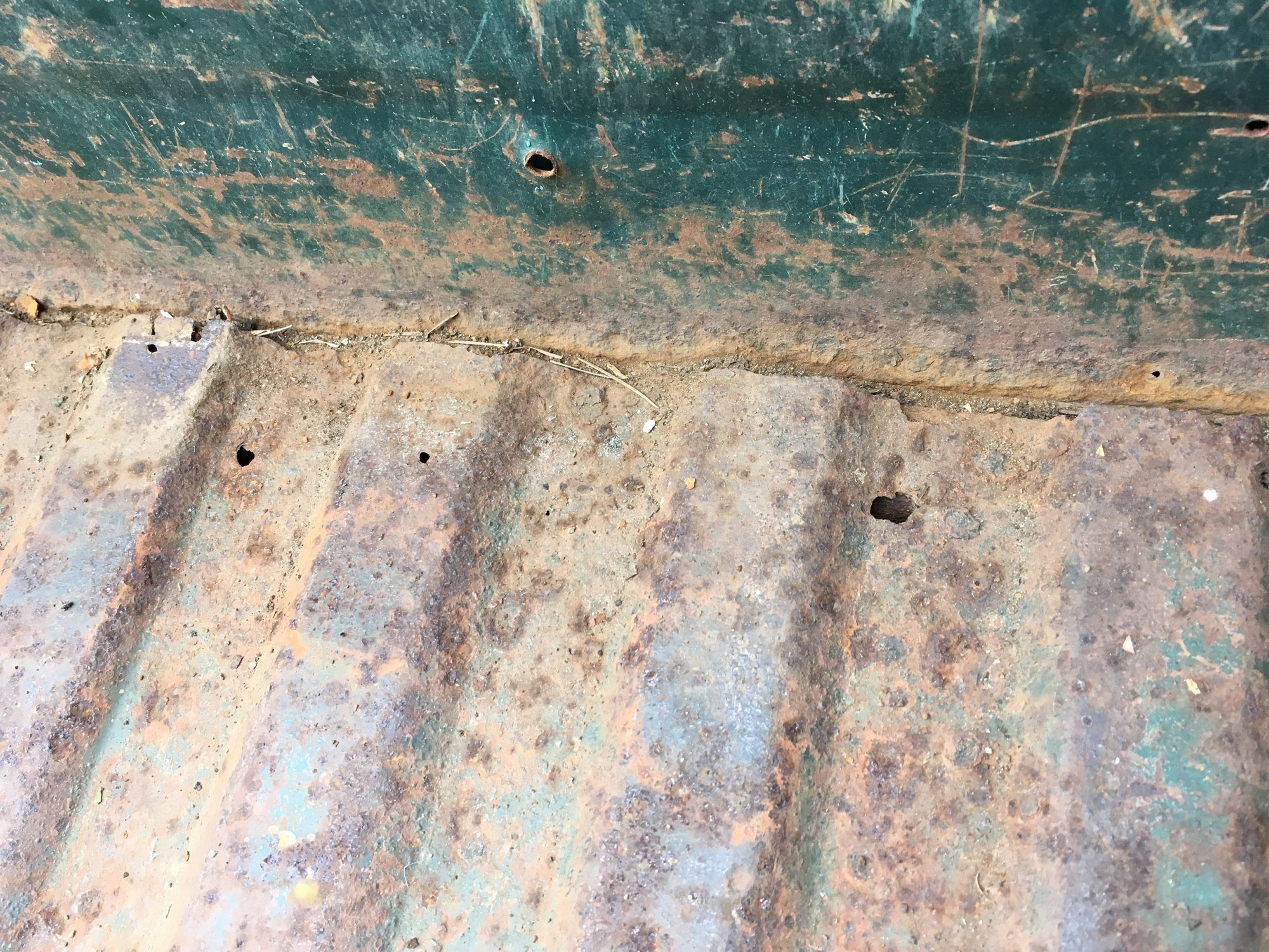

Pics
Here's my bed.

I would fix that with patch panels.....
Flat sheet metal on the vertical part next to the cab.

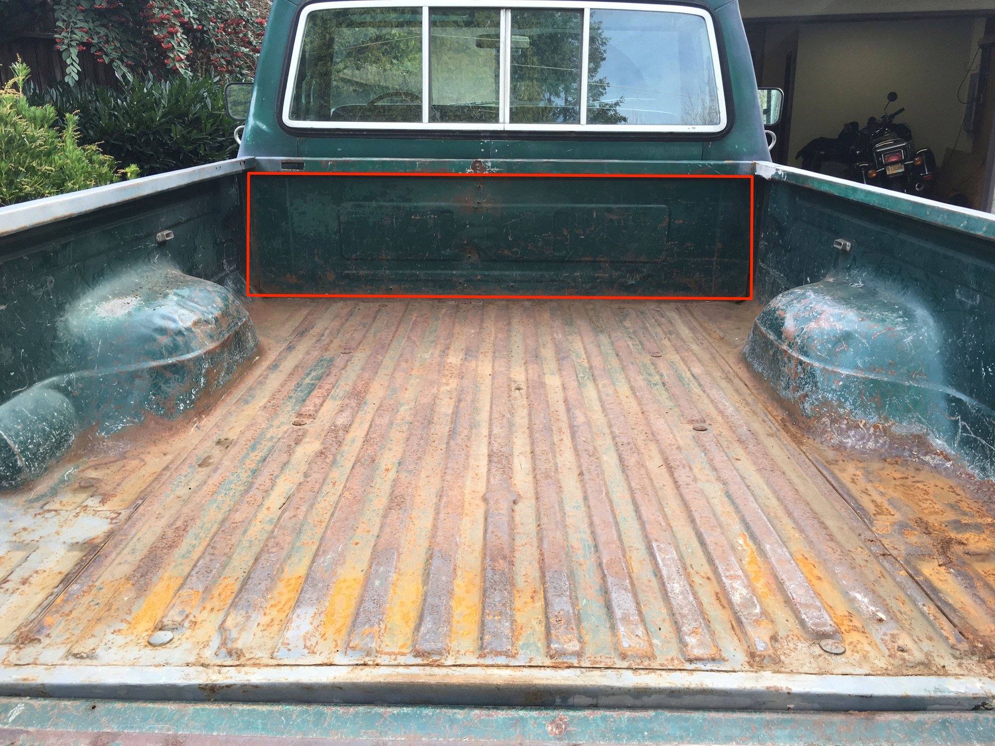

In regard to your comment "Flat sheet of metal" are you referring to this area Mike?

Yep, there is really only a small part the needs to be repaired.....
I have a wire welder so I can weld in a patch piece when I need to. I would just cut out the worst down next to the floor (maybe about 6" up) and weld in a 90 degree bent angled piece there.
