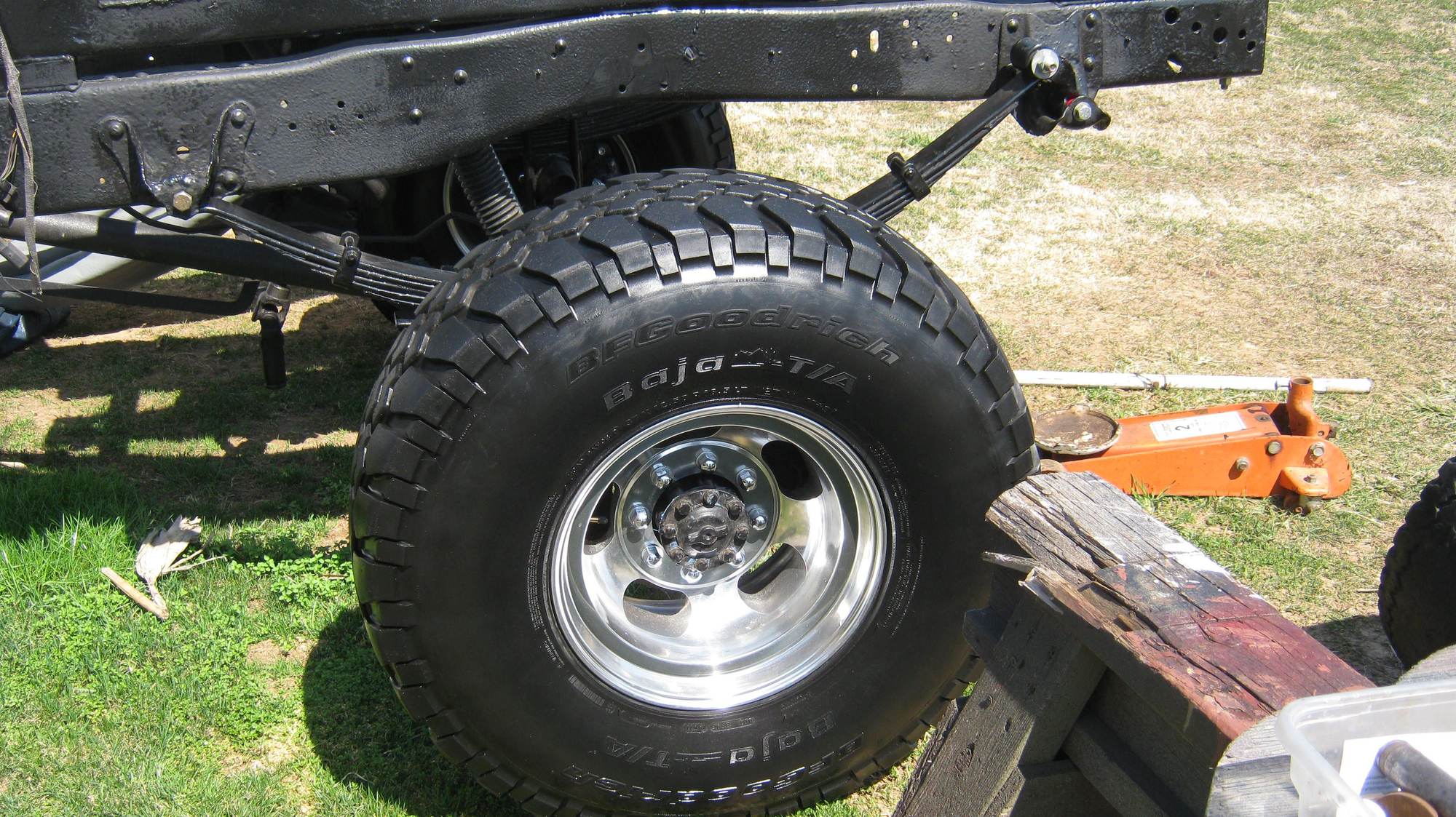

old school sloted mags
I have 16.5 slotted mags,,,that are in great shape,,,,,I bought 4 BFG Baha military tire 3 hold air real good ,one I have to stay on top of it because of leak edge,,,,,I beleive its around the bead ,any suggestions on these big 37's

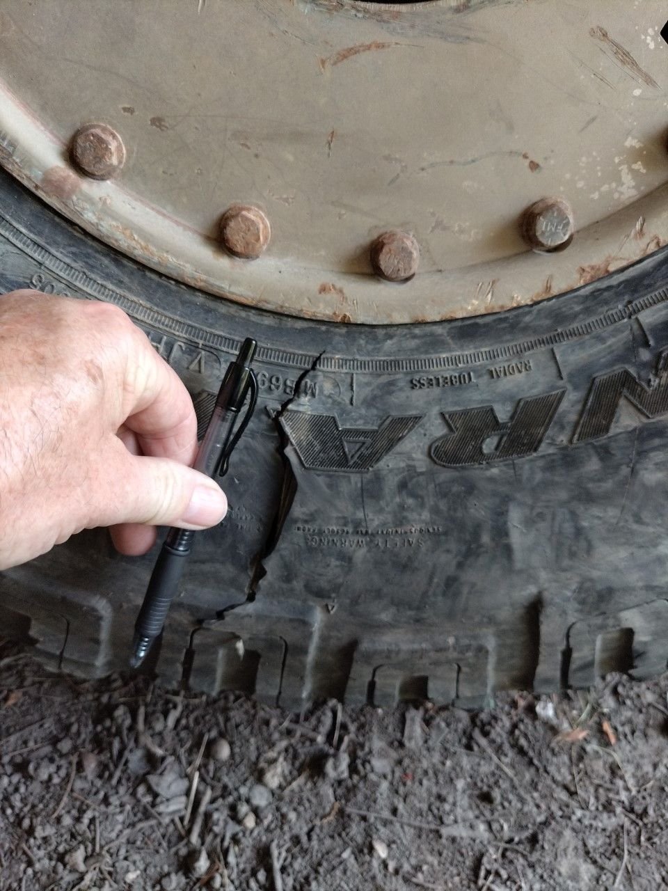

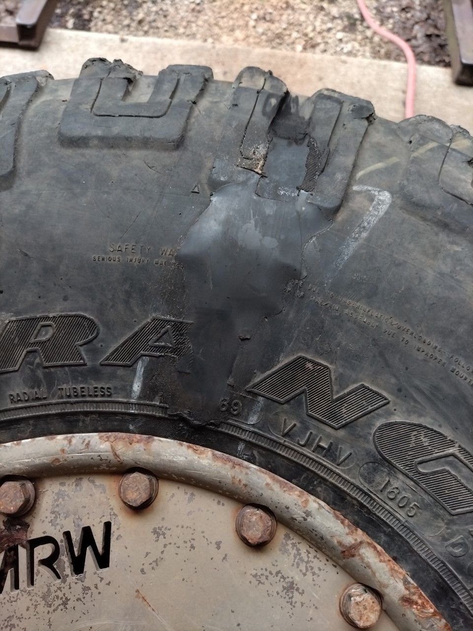

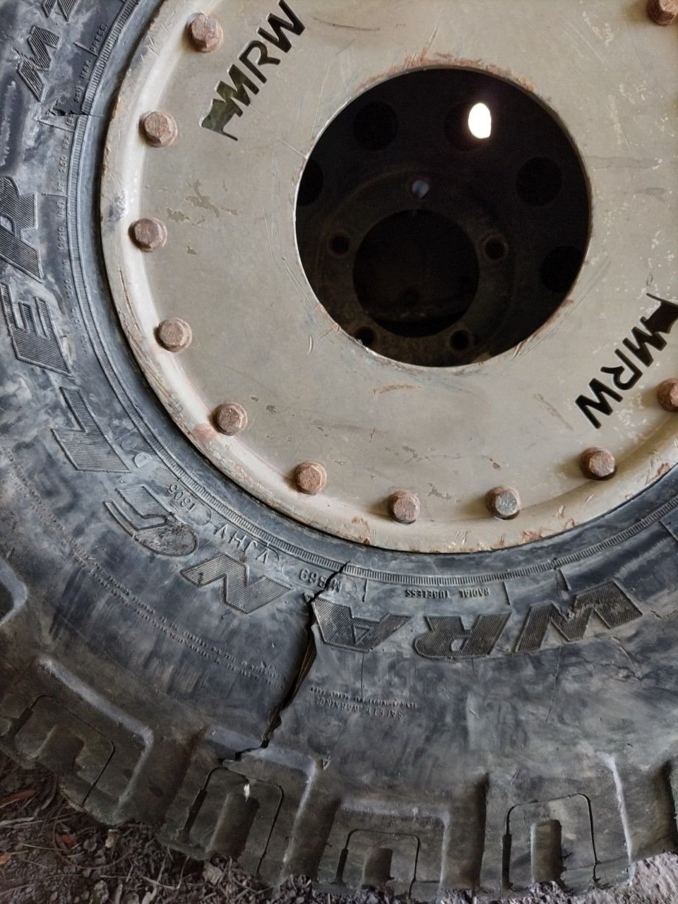

I could stick all 4 fingers in that cut. The old school farm tractor tire repair shop guy, did his vulcaniziation/boot and large patch job trick. And then put a dump truck inner tube in it. They are NOT 16.5's and are 15's on the Bronco crawler, NOT A HIGHWAY USED TIRE. Had a 1/2 more of tire bead and it would of been a goner. Only run about 10 to 15 psi anyway.
