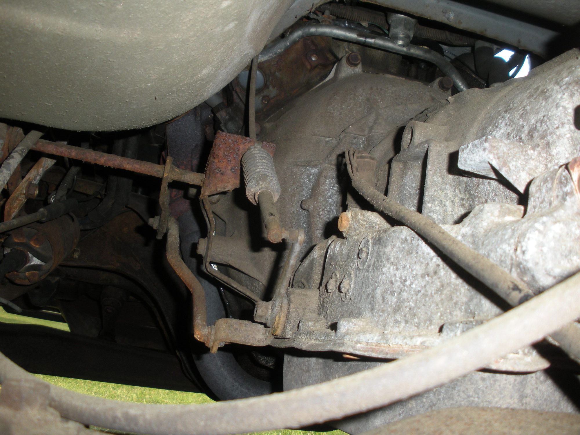

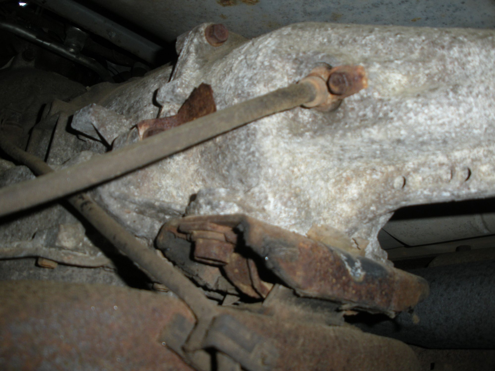

FWIW, here's my AOD.
Above is the right side, passenger side.
