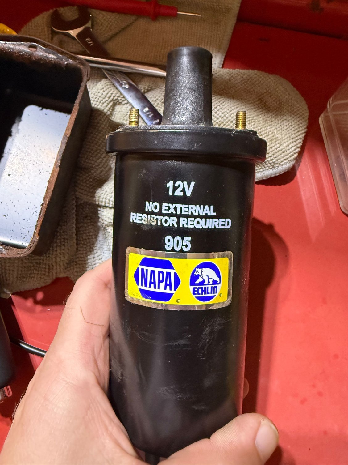

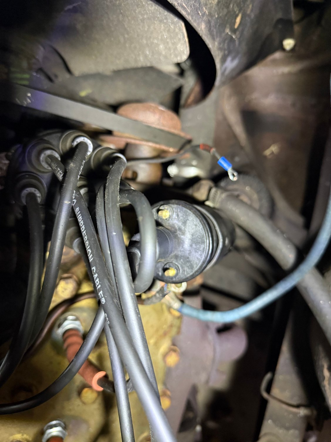

Originally Posted by OlePapaLuke
Thanks for everyone's advice! This forum is really really great. I live in Charlottesville VA now, would love to connect if anyone lives close by.
Doing more investigation, the Coil's + terminal goes to the base of the distributor. It is a 12V and states on it "no external resistor needed".
The car is set up with the original turn key + ignition button to start. The ignition button appears to have two wires coming from it
With that set up, any advice on which 12V starter solenoid to buy
Currently buying some replacement cables for battery/starter
excellent choice on coil
