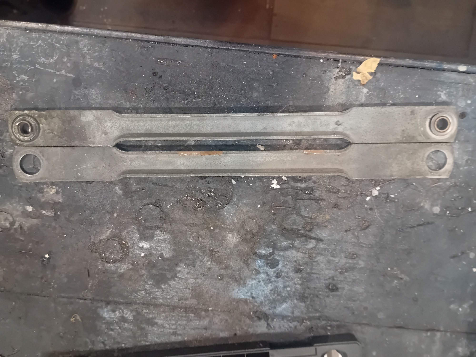

Hello everyone, I have a problem with my wiper arms because at each end there is a sort of crimped washer in which the motor shaft and the wiper drivers are fixed and on mine they are broken. I looked at LMC and DENNIS CARPENTER to buy new arms but the left side is unavailable everywhere. Do you have another solution to replace these washers ?

These are these axes

ADELEANDRE, those pieces are not, to my knowledge serviceable/replaceable, though you may be able to do something yourself. . AFAIK, no one is reproducing just those grommets. I bought the linkage arms new old stock on eBay, seem to come up fairly regularly, at least for my 66. Also, for my 66, anyway, the arms are two different lengths.

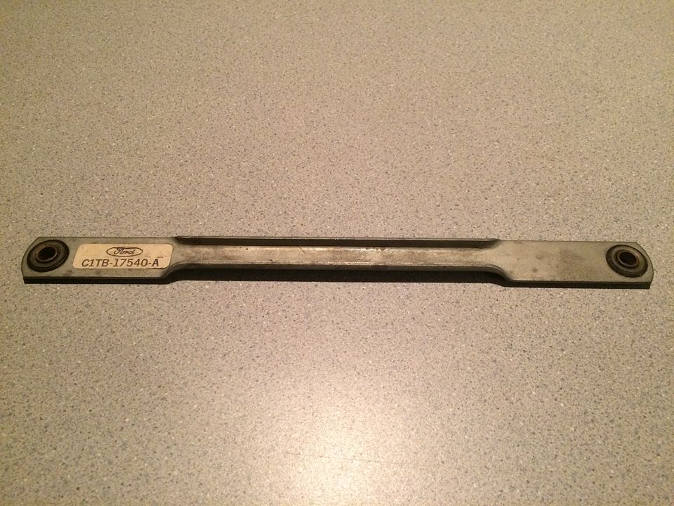

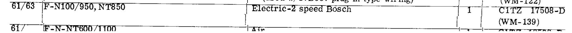

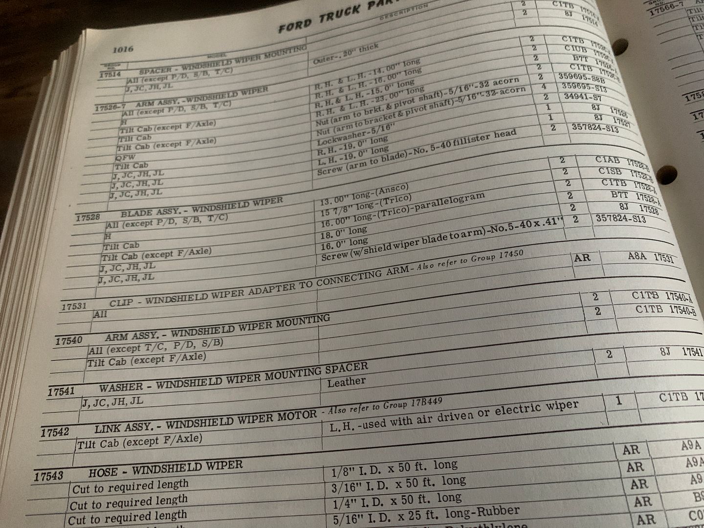

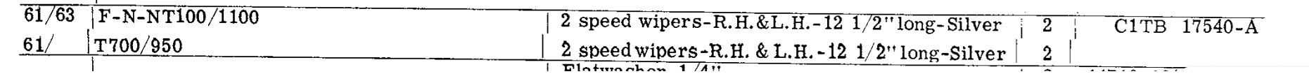

According to the 1957-1963 Master Parts Catalog the 2 speed wiper motors use the same arm left and right.
I also looked in the paper 1961-only Truck Parts and Accessories catalog, and it only shows the one number used for all except Tilt Cab, Parcel Delivery and School Bus.

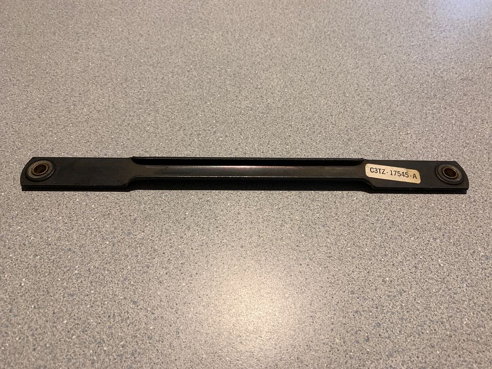

C1TB-17540-A - ARM - WINDSHIELD WIPER MOUNTING - L.H. - 12 1/2" Long - Silver
Having said all of that - if your trucks wiper arms are different than each other then I'd have to assume the other one is the
C3TZ-17545-A - ARM - WINDSHIELD WIPER MOUNTING - R.H. - 12 1/4" Long - Black
First year of use is 1963 as the C3 first two characters of that part number imply. But this is also the Right-Hand side according to everything I've read and understand from my own trucks - not the Left-Hand side. Note these places are measuring center hole to center hole instead of overall length like Ford did. My pictures are of NOS parts not reproduction so the silver and black are correct identifying colors. I think many of the places that are offering reproductions have the colors mixed up or don't use the colors at all to identify them.
Under dash wiper arm R.H. (11 1/4" from center to center of the holes) – Carolina Classics F100
WINDSHIELD WASHER PIVOT ARM 1961-66 FORD F-100 F-250 F-350 PICKUP TRUCK MOTOR-TO-WIPER RH PASSENGER SIDE (C3TZ-17545A)

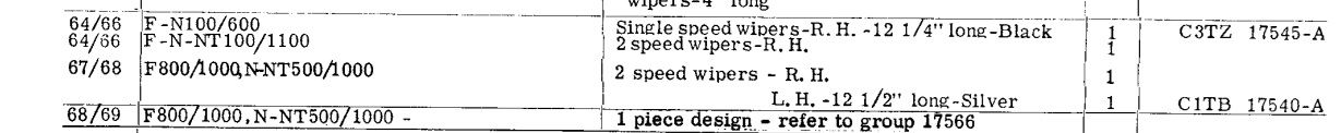

Here's the entry from the 1964-72 MPC and it also shows opposite than what Dennis Carpenter is saying. Most of the other vendors I've looked at don't agree with Dennis Carpenter, either. Examples at Carolina Classics and Auto Krafters in my first post - they show to have them in stock, too.
But you'll be able to tell there I'm sure as to which one you need by measuring the overall length or center to center of your old ones. I have to imagine that something has been changed on your truck since it left the factory. Best of luck on them working properly once you are done.

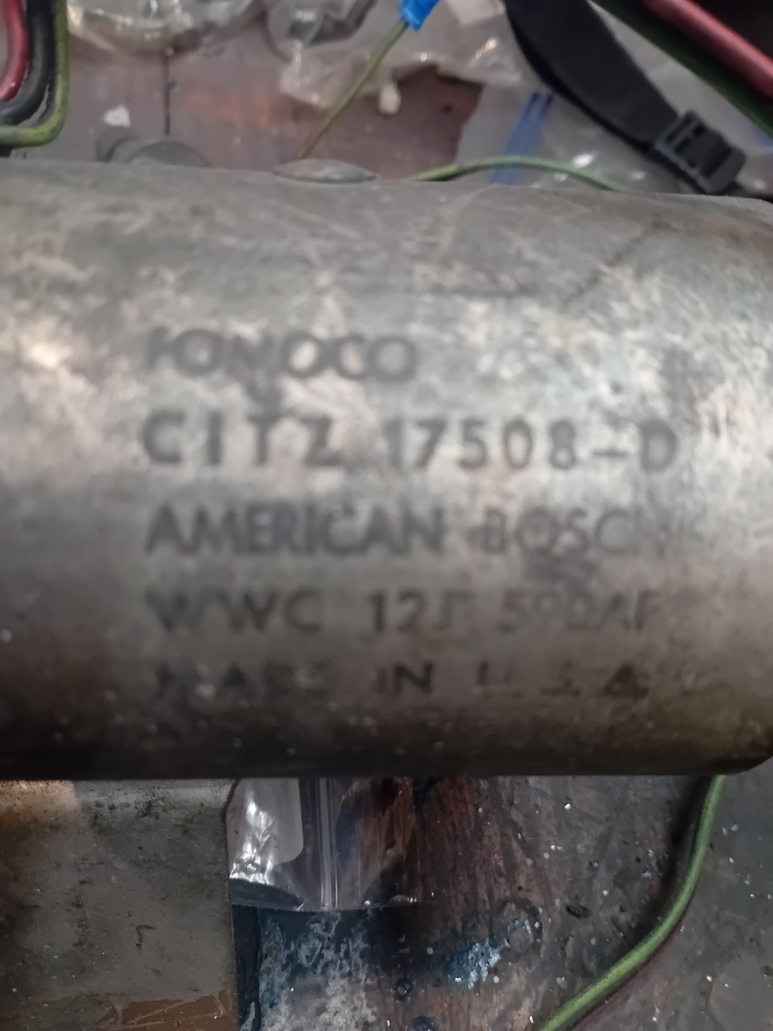

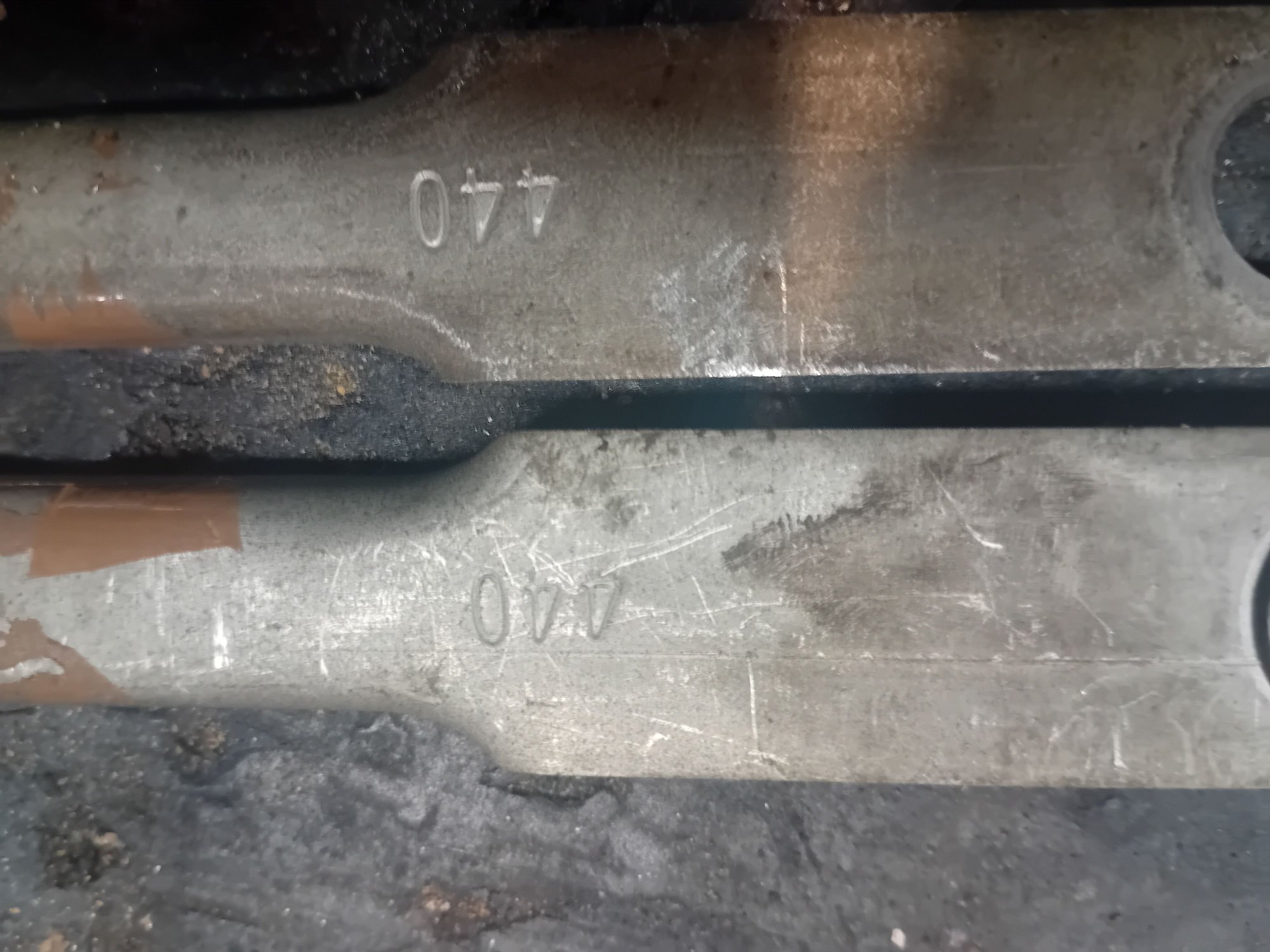

I just looked and the two arms I have are completely identical, same length of about 315mm and completely symmetrical
The motor =

Now THAT makes sense with a two-speed motor. And Carpenter has them in stock. And yes, that appears to be a 1961 era 2-speed wiper motor.

Old Sep 25, 2025 | 11:22 AM

And both of them silver, too. Everything falls in place.

ah no.... I have a center distance of about 291 millimeters which corresponds to those that are not available ...
