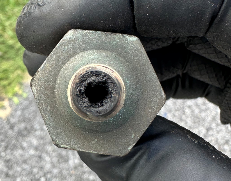

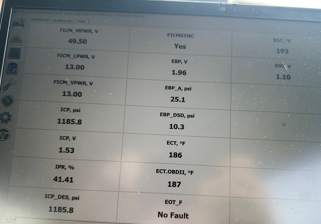

Got to connect the Forscan today below is what I got, the first pic is koeo and the second is at hwy speeds 55 to 60mph. The EBP sensor was removed and shown below, it is pretty dirty should I clean it or replace it, this is the original sensor. I disconnect the ICP sensor and try to restart and it really didn't affect the start time. The IPR while cranking read as high as 48%. I drained the fuel from the HCFM and it had more trash then normal so I will replace both filters tomorrow. The air filter was a little dirty but not enough to move the air filter restriction indicator. I forgot to check the Mode 9, rain caught me multiple times.
