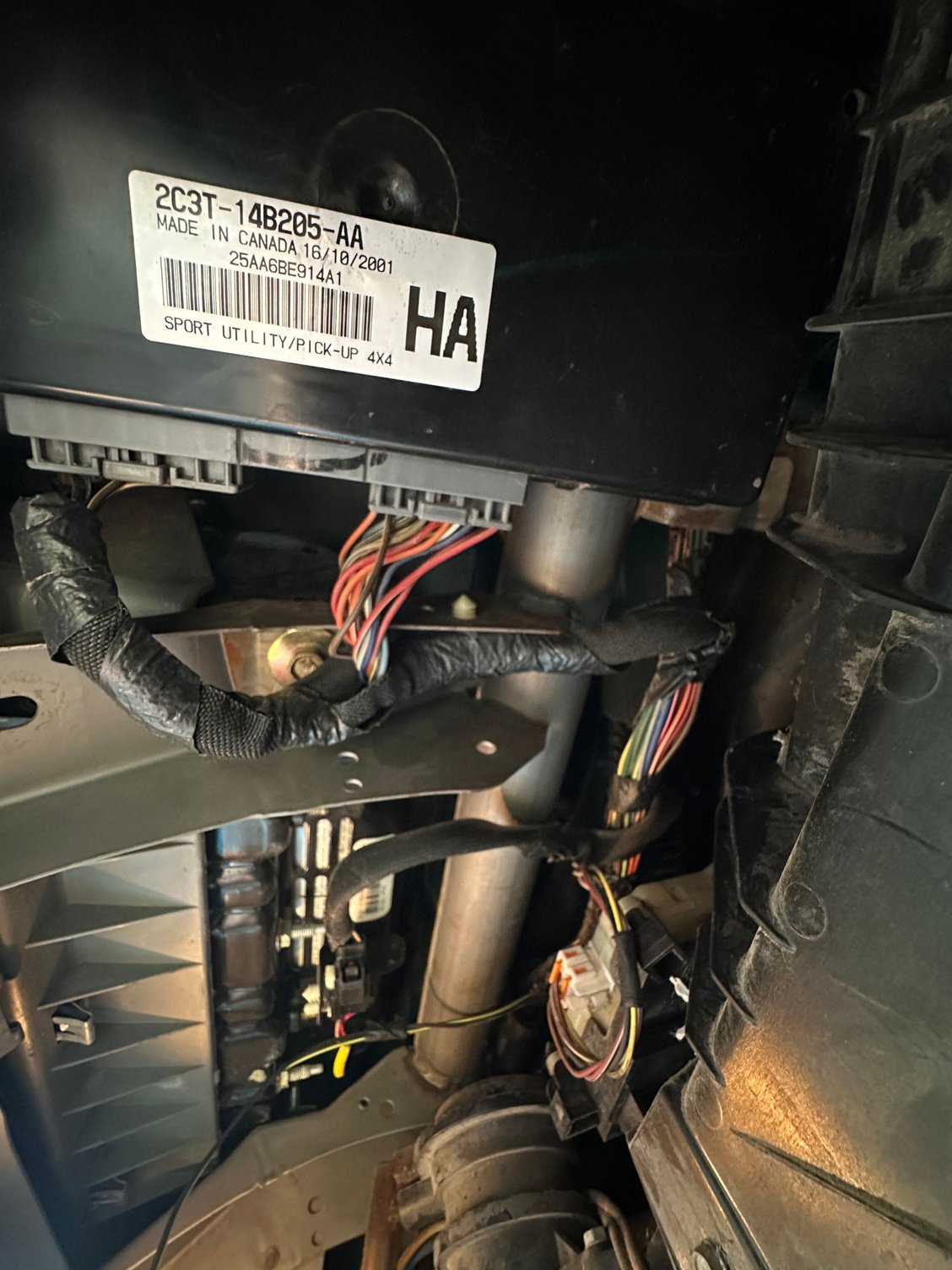

Stuck again in the mighty 7.3, this time in Cheyenne since last Thursday. Long story, much work done at Patriot Diesel here but cant be driven without the GEM module replaced.
They've been looking all week and nothing until today when they found a used one four days out for $1200 in Missouri? Is this for real so I canceled that plan and we found one at a junk yard, same exact truck, in Cheyenne, for $75 but they say the "numbers" aren't matching and don't want to damage the truck further. But will discuss with somebody tomorrow. Meanwhile we need to return home to Texas asap. I don't know WTF to do really and sitting in an expensive RV park here with no vehicle!!! Feel like giving up on my Old Betsy after 300k and 24 yrs together all over the continent.
So, can anyone on here advise me on all this because I am about to lose it!!!! My mechanic back in TX said it still has nearly factory compression but they install only certified Motorcraft so he
wouldnt be able to help on this because Ford no longer produces this part!

Wouldn't a 2002 require a VSM and not a GEM?
Also, don't quote me on this, but the truck may run with the non-numbers matching module, but some customer features like power door locks may not function properly.
If it were me and in your situation, I would give the quick access one a shot. I don't think "module experts" has any, but you could check them out to be sure.

Sir, ‘02s & ‘03s don’t have a GEM module but a VSM (vehicle security module). I have an ‘02 CC Lariat and have pulled fuse #10, I think, and the truck runs fine. However the radio, door locks & key fob all do not function as normal.
Just my personal experience.
You can look into this forums Tech Support library and find this info/experiences from other owners.

If you have a 2002 model year, and if Patriot Diesel in Cheyenne states that you need a "GEM", then you may have a problem on your hands that stems far beyond your truck. The 2002 model year does not use a GEM, and was never manufactured with a GEM.
If the shop is using the wrong terminology for the part being sought, then how confident can you be that the such a part is even needed, if the truck was never built with it?
If you are "not privy to the specifics of the electronic problems" of YOUR vehicle, then how can you prevent from becoming "insolvent" by "spending thousands" with shops "who are unable to complete the job" without installing a part that never existed on your truck? This is a certain recipe for being ripped off royally.
This isn't said to come down on you. Rather it is said to warn you. Your spidey sense is working. You stopped the shop from ordering a part for $1,200 from several states away, when you found the same part for $75 in the same town that you are stuck in. Regardless of whether or not that part is even needed, something told you not to take the shop's word for what they could only find in Missouri.
Your path out of Misery is to BECOME PRIVY to the specifics of your truck. It is your truck, and your money, and no one else on this planet deserves to be more privy than you.... so get real privy, real quick.
In your shoes, the first thing I would do is disconnect both batteries, remove the Edge Evolution Tuner to restore the OEM calibration of your PCM, and then check the connection integrity of all power and ground circuits.

If it’s SOTF there’s a separate 4x4 module on the passenger side of the truck behind the glove box that is part of the 4x4 system. There’s also relays and a transfer case motor. There is no GEM on these trucks as stated before. If you don’t need 4x4 right now I’d grab the truck and find a different shop that knows the difference between a GEM and a VSM.

You can just remove the electronic 4x4 actuator on the t-case and turn the shaft to 2wd by hand with an 11/16 wrench.
If 4x4 is the issue, sounds like your module up under the dash above the glovebox may be dead.
My 02 is this way, I ended up running manual linkage setup on the t-case and gave up on electronics
