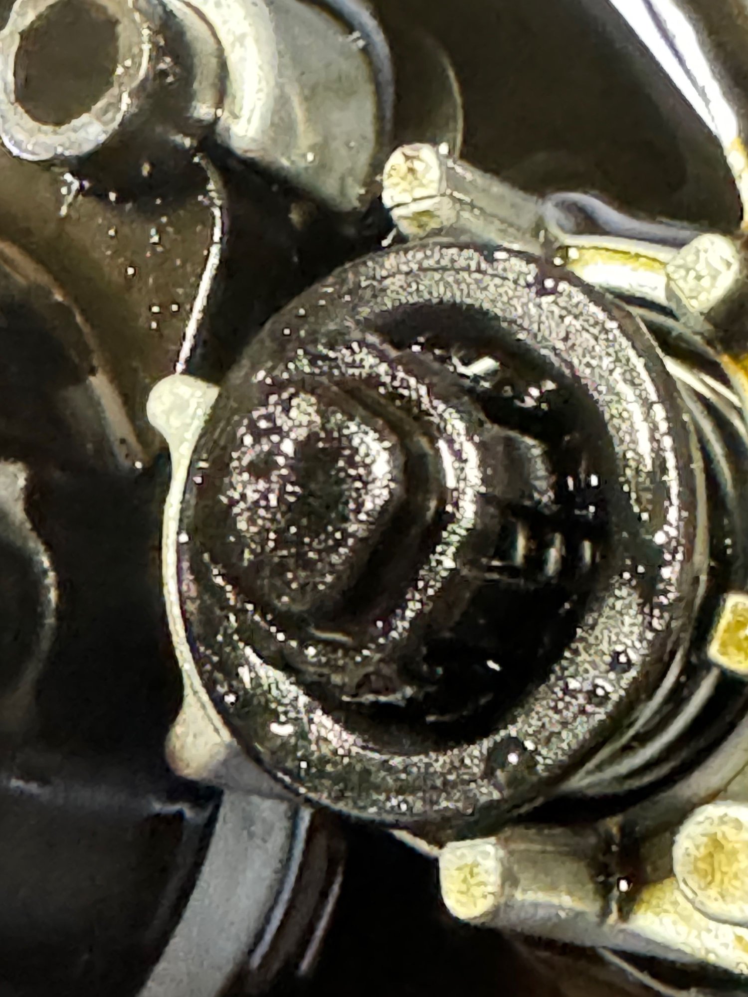

I think ECTs were fine. I believe EOTs were high based on delta and condition of oil filter standpipe. Engine itself does not act or appear cooked. But based on the temp delta, I had it replaced within about 7 miles from point of purchase.

We know that the plastic in the oil filter BEGINS to melt at 300 degrees F (significant deformation). So it wasn't simply a slight over-heat. With any significant melting at all, it was easily 10+ degrees hotter than that. IMO this will damage almost all o-rings and gaskets. And if plastic "flowed" into the engine internals, who knows what may have happened.

Yeah, I think you are correct about that EOT guess. And I have a similar concern about incidental damages. Based on standpipe condition, I think the plastic deformed, but plastic from it did not flow anywhere. But I get the point. And I wish I had more information about what they saw when they did the oil cooler. But that shop stopped communicating when I asked about the condition of the old sump screen. I wanted to know if the old sump screen was torn or displayed signed of heat damage. Based on the fact that the wiring harness was not re-secured anywhere, the EGR cooler is missing a bolt, a CAC tube blew-off, and the intake bolts are finger tight, I'm guessing they phoned-in the re-assembly and do not want to talk about it.

Oil filter standpipe starting to melt around 300 degrees F isn't a guess btw ................ so plastic component softening, maybe begins 20 degrees or so cooler.
Cheezit showed us that years ago.

Sorry- I meant "guess" in reference to how hot the utility ran EOTs, not in reference to when the standpipe begins to melt. I wish I had the standpipe the shop replaced. And the sump screen. And the oil cooler.

Standpipe Photo
Found a photo of the oil filter standpipe that was replaced at the time of the oil cooler and EGR cooler.
