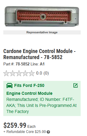

Yoy can order from, O'Reilly's

Oh, I hadn't seen those from Oreilly's. Thanks for pointing me that way. I had to call and they said they would have to call cardone to see if they had any available. This rarity is one of the reasons I'm looking to see if I can put a different number in there.
