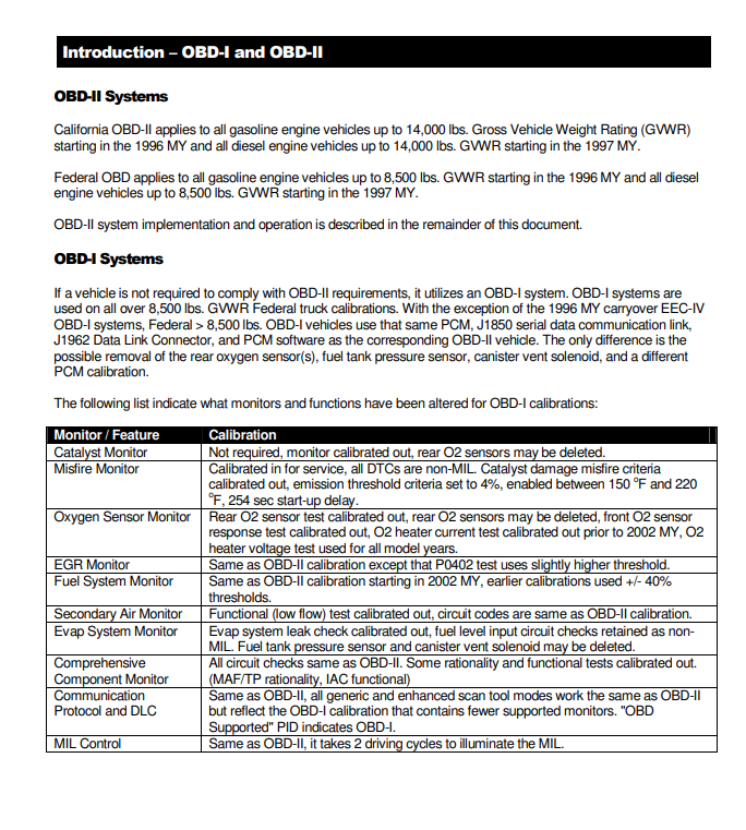

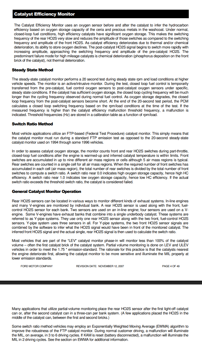

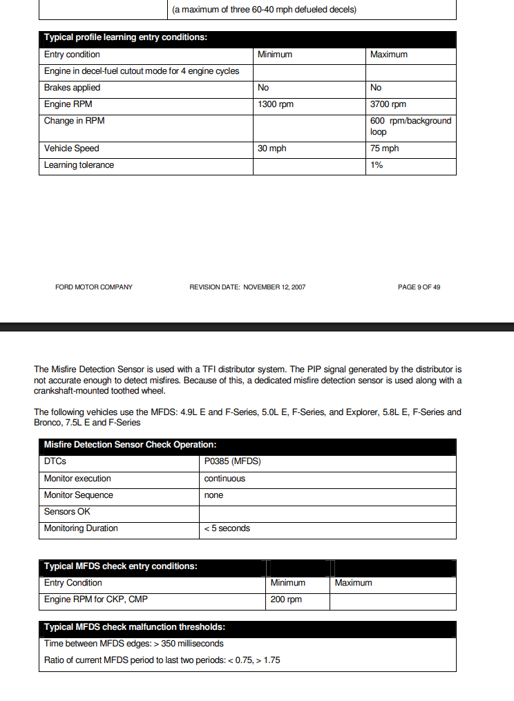

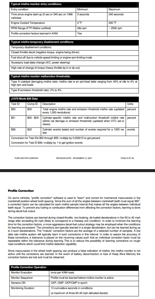

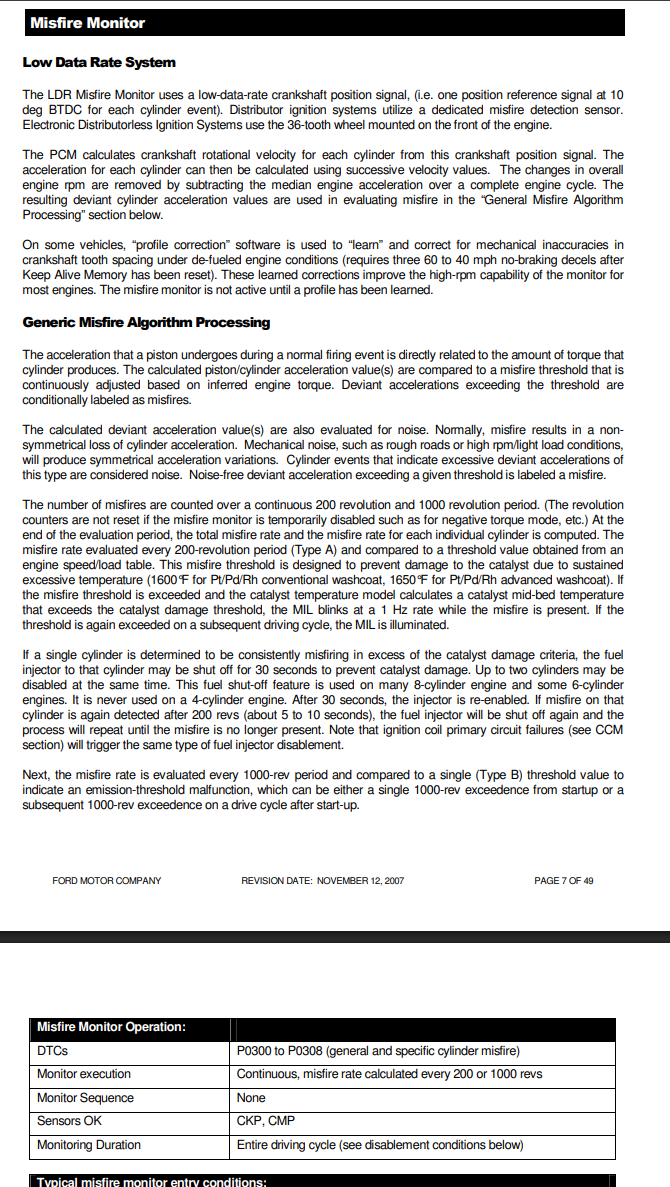

yes it does. its the exclusive purpose of it on the OBS fords with obd2 and gas engines.
Its also charted/graphed. If i have a loose spark plug in cylinder 2 and i dont notice it shaking (with wherre its at and the wire being over it just such a way)
The obd2 live data tells me there is a present msifire situation and then it flags the misfire has occured in this ignition cycle, and then it starts a running count of the misfire counts in cylinderr 2 while the rest stay 0.
The reason for this addition is not to prevent engines hurting themselves its to prevent the damaage of cat converters and allow cat converters to be extended in lifespan by allowing the monitoring of the most damaging kinds of misfires (misfires below this threshold are not required to be monitored/controlled/corrected.)
The Check engine light will flash if the misfire condition will cause the vehicle to emit (1.5x more than normal and if they continue it will damage the cat conveter irreparably, iirc)
The post o2 sensor is also used for monitoring the lifespan of the cats so that when they are not doing their regulated/required job they are identified and replaced.
Based on obd2 compliance windows for gvwr vehicles differed, and epa allowed exemption on passenger cars to 99 usually when requested (ford used it more than GM)
2004 was the year for the trucks that were in the class of "heavy" duty light duty trucks, which did not require OBD2 compliance till that year either in part or all.
So thats how you got your F250 and F350 HD in 1996 and 1997 because they were in the exemption. this meant 2003 super duties wouldnt have to have a post o2 sensor or have the check engine light indicate the level of catalyst damaging misfires or have an obd2 connector etc......
They thankfully did use a majority of compliance lol. this also meant service data wouldnt have to be made available or special tools/ made available the same way on those models either.
Heres the specific part of the eec-v engines compliance wise
