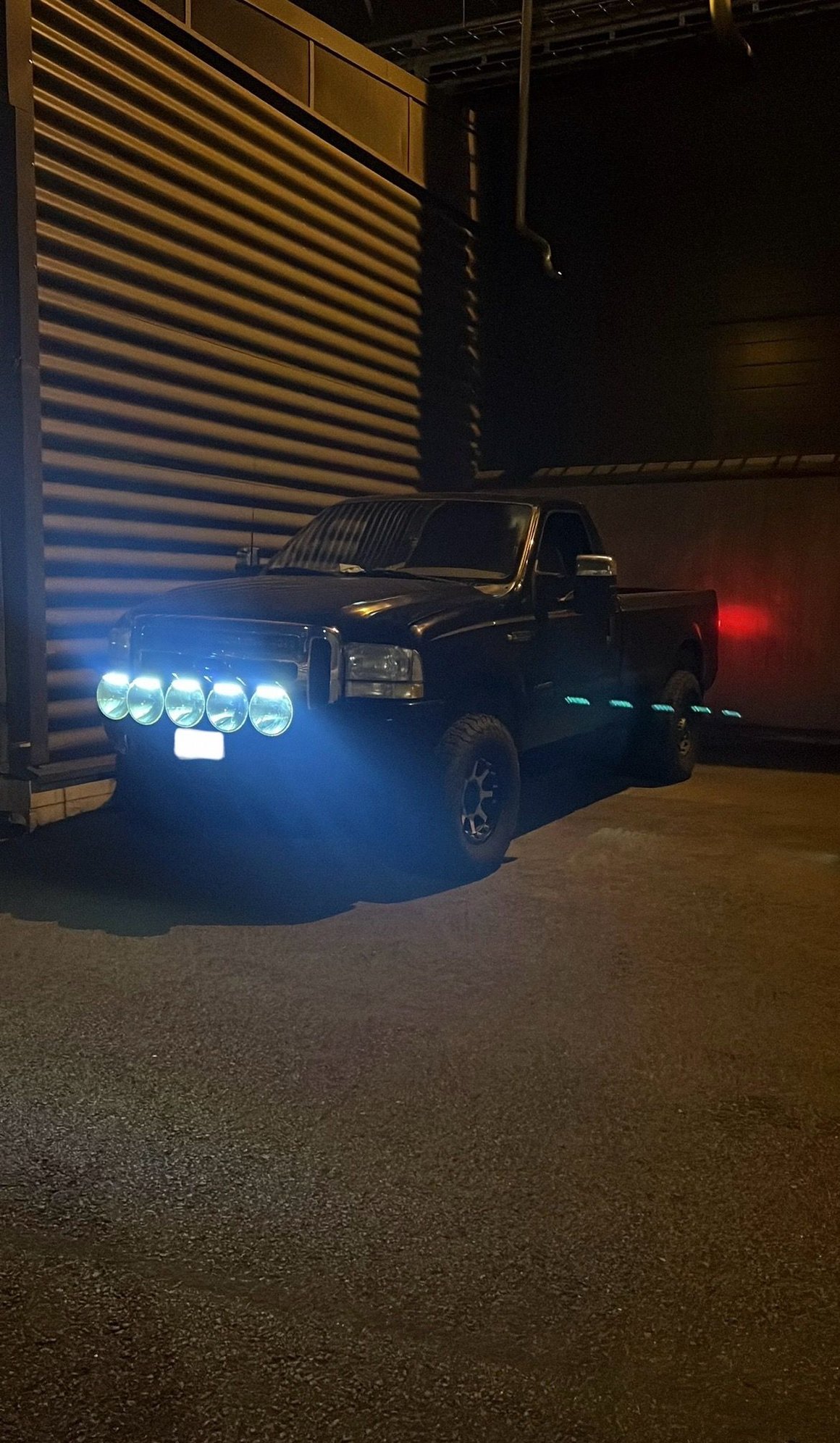

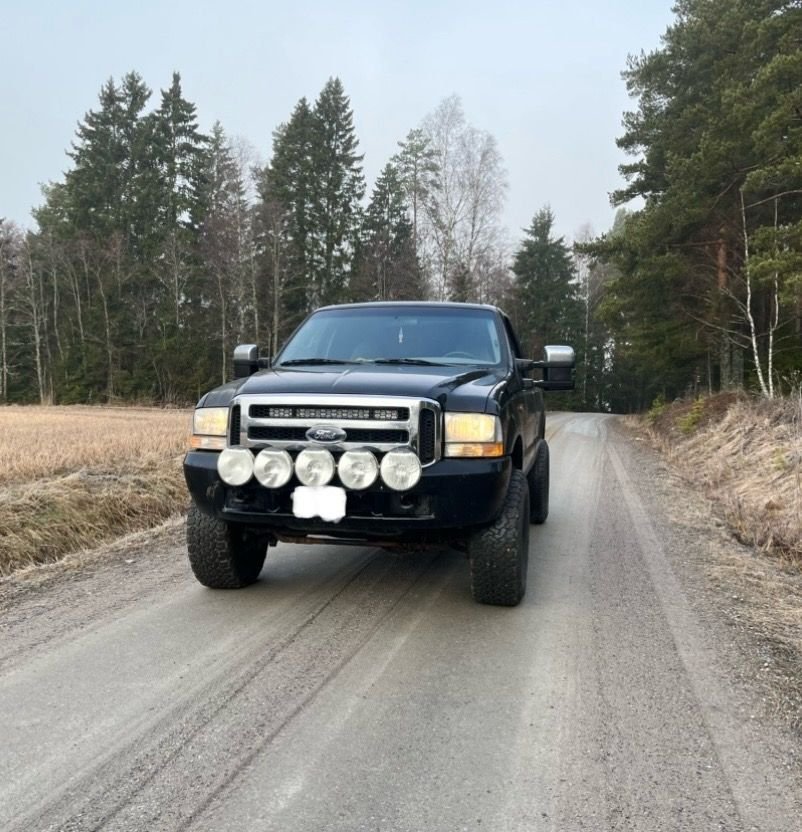

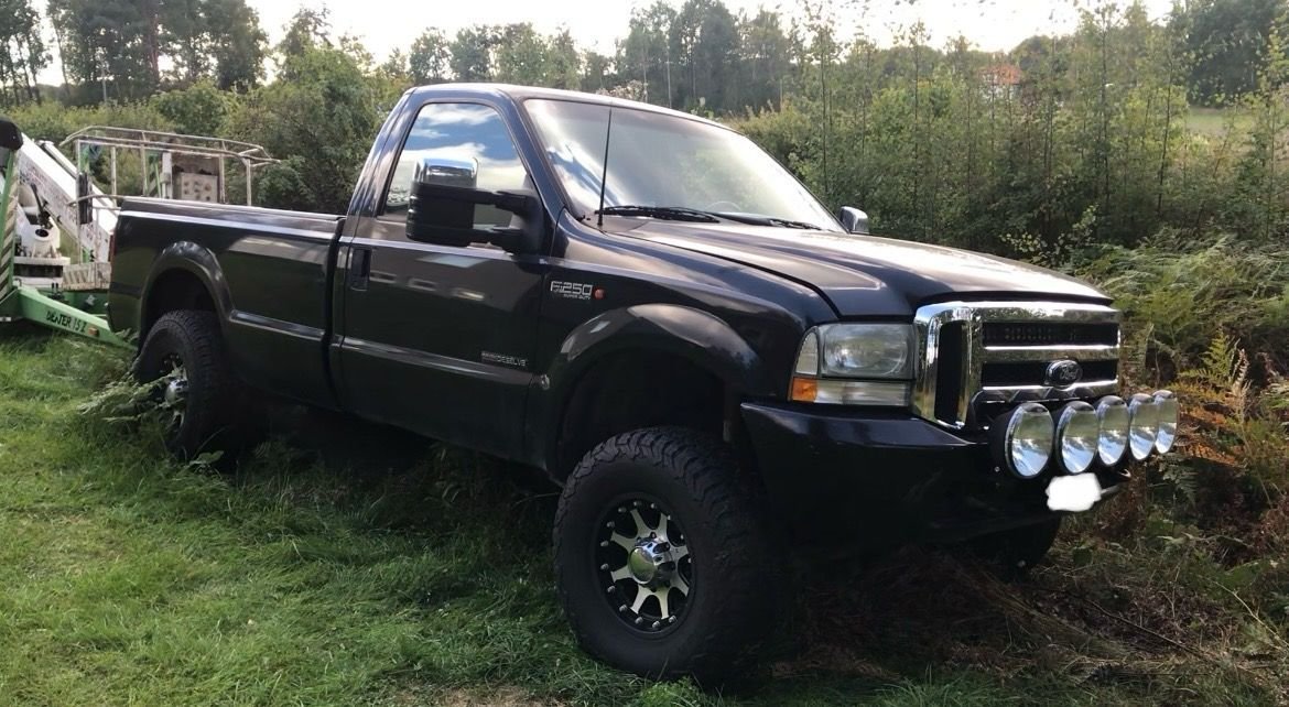

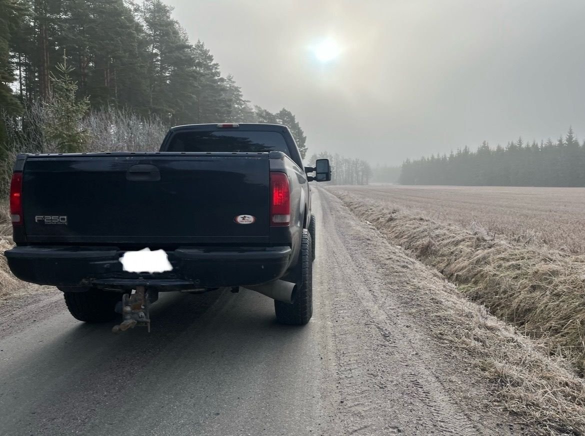

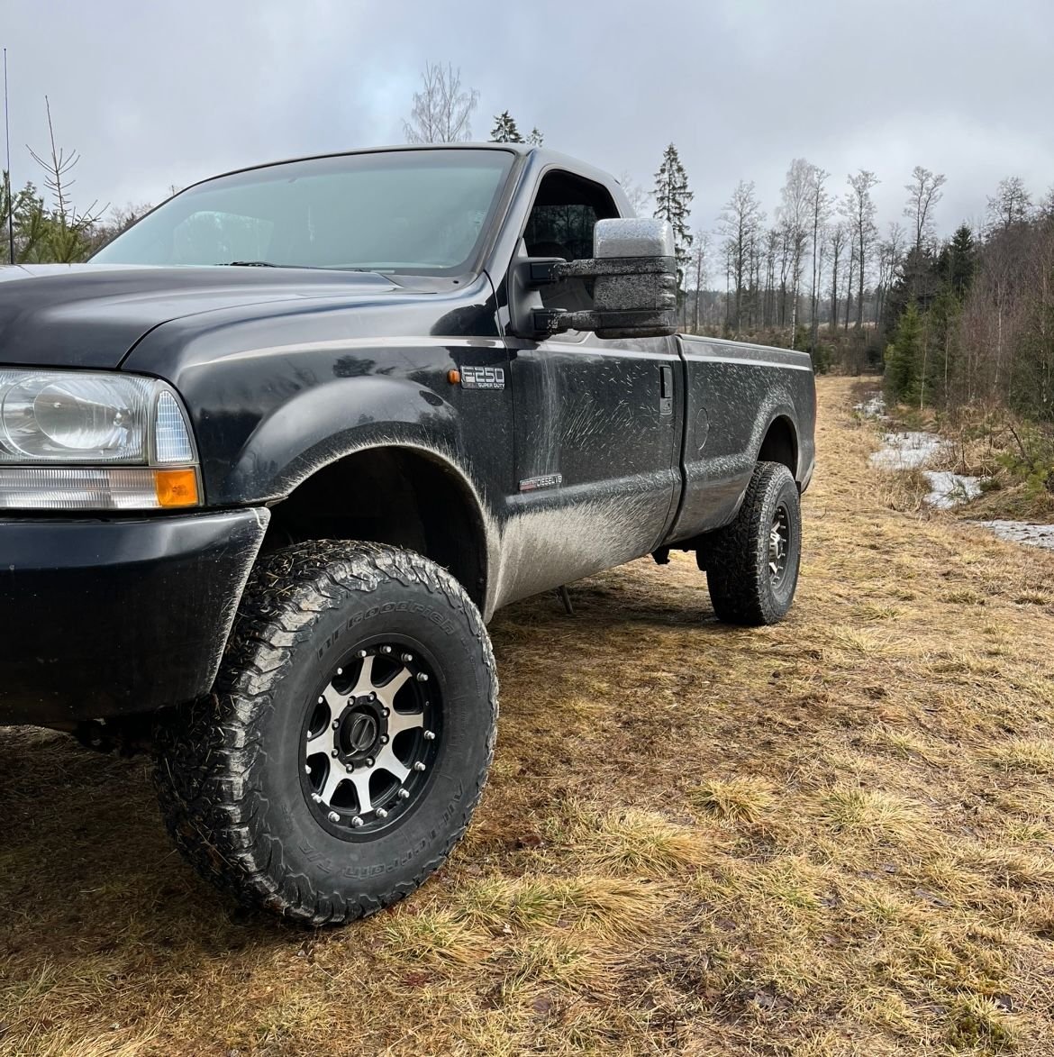

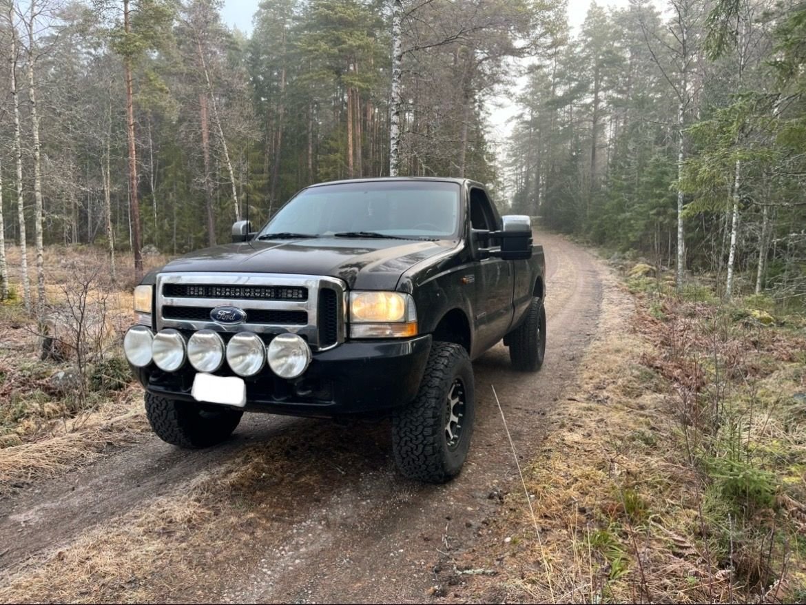

Some background, I have a F-250 7.3 SCLB 4x4 year 2000 that I bought a couple years ago. Searched for the right truck to buy for a few years, I don't live in the US and the 7.3 is kind of rare here and I absolutely wanted a SD 7.3 SCLB 4x4. Parked the truck after running it for some time since it's in need of an overhaul / restoration. Now I'm able to get started with all the work. The truck is an auto but I always wanted a manual, doing the swap with all the work isn't something I'm afraid of so that wasn't a big factor when buying the truck. As of recently when I've begun looking around sourcing parts for the truck I've started to think about building the engine to 500 hp or thereabout. That power goal is further in the future, I'll probably do some engine work when the cab is off but nothing too serious, I want it back on the road first. If I were to keep it stock-ish I'd absolutely do a ZF6 swap but I'm not sure anymore with that "new" power goal. Unfortunately I don't have the possibility to test drive a manual diesel truck of any kind, that would maybe have made it easier to decide.

Got any pics of the truck?

I’ll try to attach some pics.
