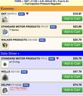

Are you saying the one you bought had two bolts instead of three? That’s on you for not knowing what you needed. A quick on RockAuto would have told you that. I would use any of the “daily driver” regulators

I HAD purchased one from rock auto before (walker) and it is now malfunctioning. I had picked one up on ebay. The listing didn't show all 3 mounting holes ...only 2 but the seller indicated it would work on a 5.0L engine. The mounting style was not triangular so it would not work. Finding the exact part # from ford for the model year proved an exercise. But I found it. Looks like they are not easily had. There are others I know (SMP, Delphi, walker, etc.). Just had a bad experience with them.

Walker is not in the “daily driver” section. I would not hesitate to use Standard, Wells or Delphi that are listed.

will pick up a delphi when I get to florida and bring it back north. thx. getting stuff shipped to canuckistan is becoming very spendy and time consuming.
