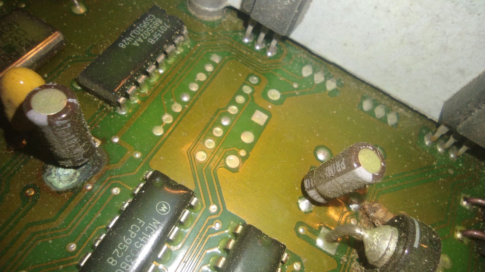

I decided to have another look at that PCM. I looked at the capacitors. There are two that have some corrosion near the soldered joints. I'll let you guys look at them and see what you think. One of them feels like it's hanging on with one leg. I'm going to order these three capacitors right now.

Typical leaking capacitor(s) problem plaguing these old trucks. I see signs of a resistor is also compromised from the leakage.

For anyone looking for these caps, here is where I found them. I hit the buy it now yesterday. The seller listed the ratings on these - some sellers of these do not (duh). When they get in and I get the PCM in I'll report back.
Ford 80s 90s Computer Premium Capacitors Kit PCM ECU 47uf 16v 10uf 63v | eBay

Got the new capacitors in. Test drove the truck, and the engine seems to run smoother, but not quite all the way. I'm going to be looking into it more.
