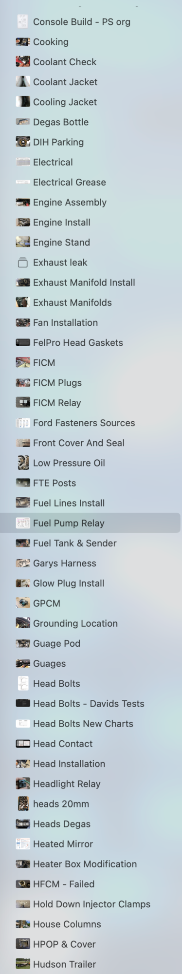

No, there are not. I think Mark wrote up what he did ... somewhere.
I started a video of different ways to do this, depending on your model year. It's a stupid design, where other vehicle platforms within Ford at the same time use a replaceable relay. What hindered my completing the video was my hard drive corrupting many of my video files and iMovie files. And it happened twice. Then my life got crazy.
Mark and a few others have asked me to see if I can finish it. And it would probably be one of the first I do, if I get time. There are several threads within this site where I've discussed this and provided diagrams.
The early trucks like mine can have a few wires spliced and cut behind the CJB to make the HFCM heater relay become the fuel pump relay. Or you can put a relay in the cab based on existing wiring, which is simple. Or you can add a relay in the engine compartment, especially if you have the belief you need more amps. The HFCM at full pressure uses 5 amps. It's not a high-load circuit.
It's not like I didn't have just a few videos in progress. I usually had 6 to 8 videos being worked on at the same time. Wiping out all that work sort of takes the wind out of your sails. And this is a partial list, some made, some not.

EDIT: Here is the link for the external fuel pump relay installation (this is simply how I did it, and it definitely wasn't a sophisticated piece of work .......just functional!):
https://www.powerstroke.org/threads/...relay.1383012/

Yeah, there are tons of information in that other thread, including parts. And a few diagrams that I had on my other computer, which failed first.
