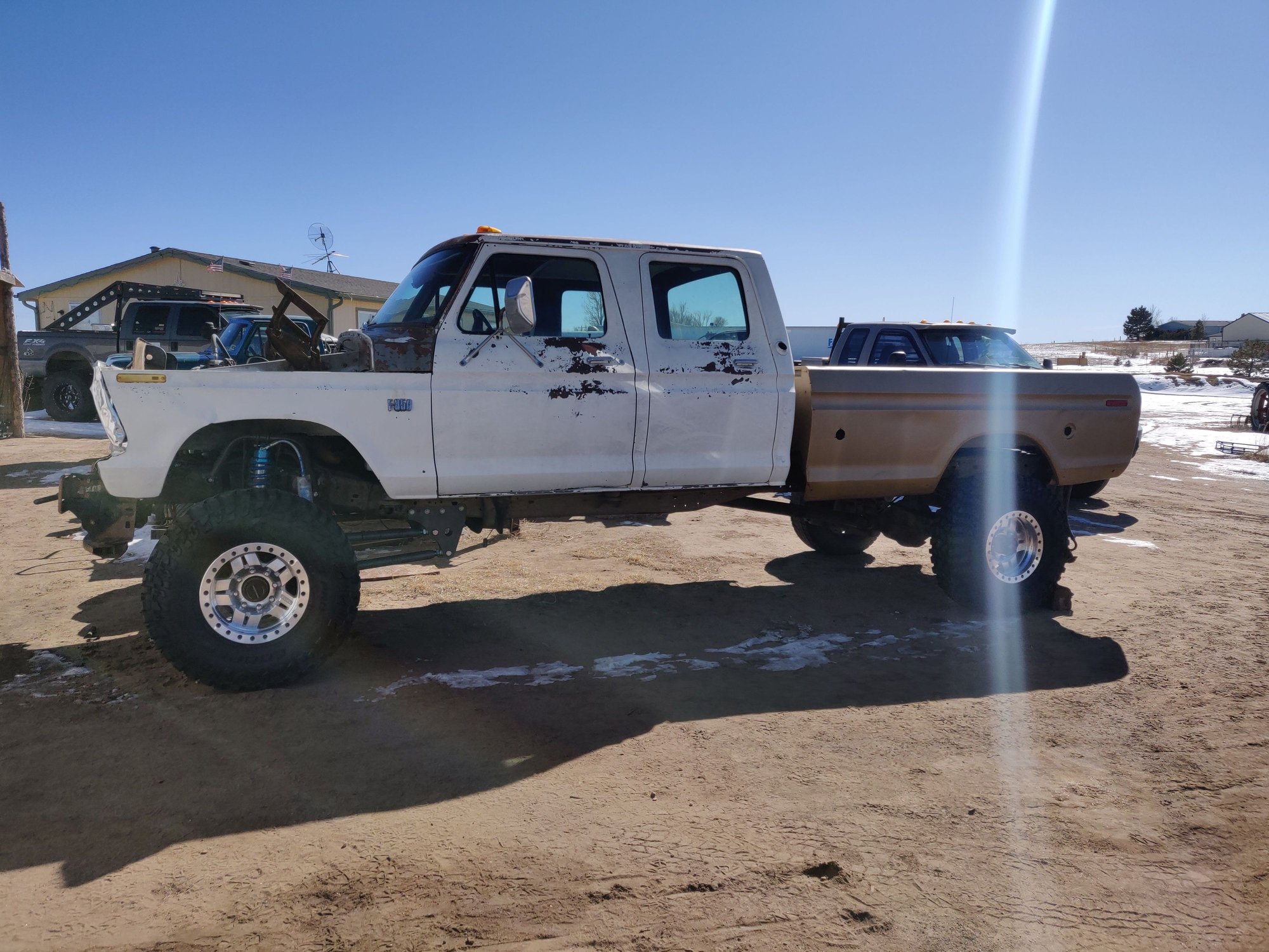

Which 7.3 did you end up going with and what transmission/transfercase are you running?
Looks like a 05+ D60 setup in the front those seem to be pretty popular with 4wd converting these trucks.
My 73 is using highboy parts to convert it to 4wd so im still on the original F35 chassis but with highboy parts shoved into it.
Ive been looking for basically that exact bed that you have on your truck for my one 76 highboy farmtruck restoration im doing.
I need to get back onto that project been on the backburner since about November of 2024.
I had got the whole truck apart and sandblasted the whole chassis and painted it but I havnt gotten around to putting it back together yet.
I dont have a whole lot left on it thought. Need to replace the front leaf bushings in the frame and replace the floor pans then I can start making it look like a truck again.
I need to track down a 76-77 D44 Big Hub, D60 narrow frame rear axle, and a divorced NP205 for it.
Picked up a 71 360/NP435 setup awhile back I need to rebuild for it and after I get all the parts and a bed for it I think ill be ready to sell the truck.
