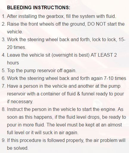

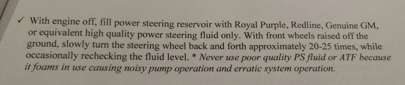

You still have air now is has to set for a while to let the air break up. Go get breakfast....then try these insturctions. I think the 1st set of from Red Head.
