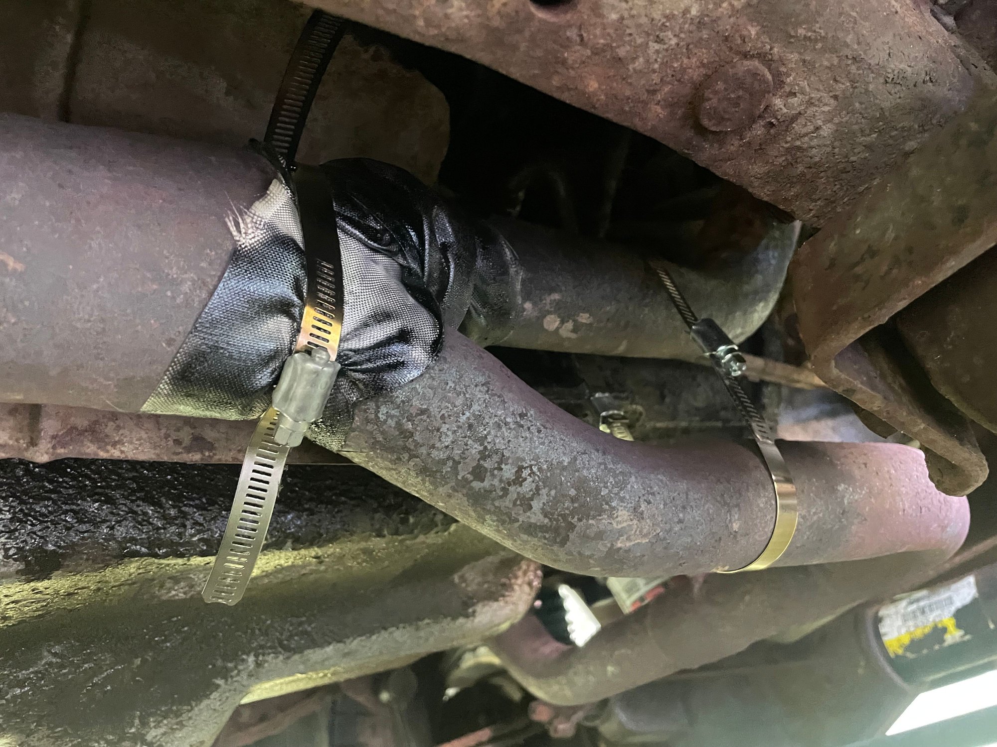

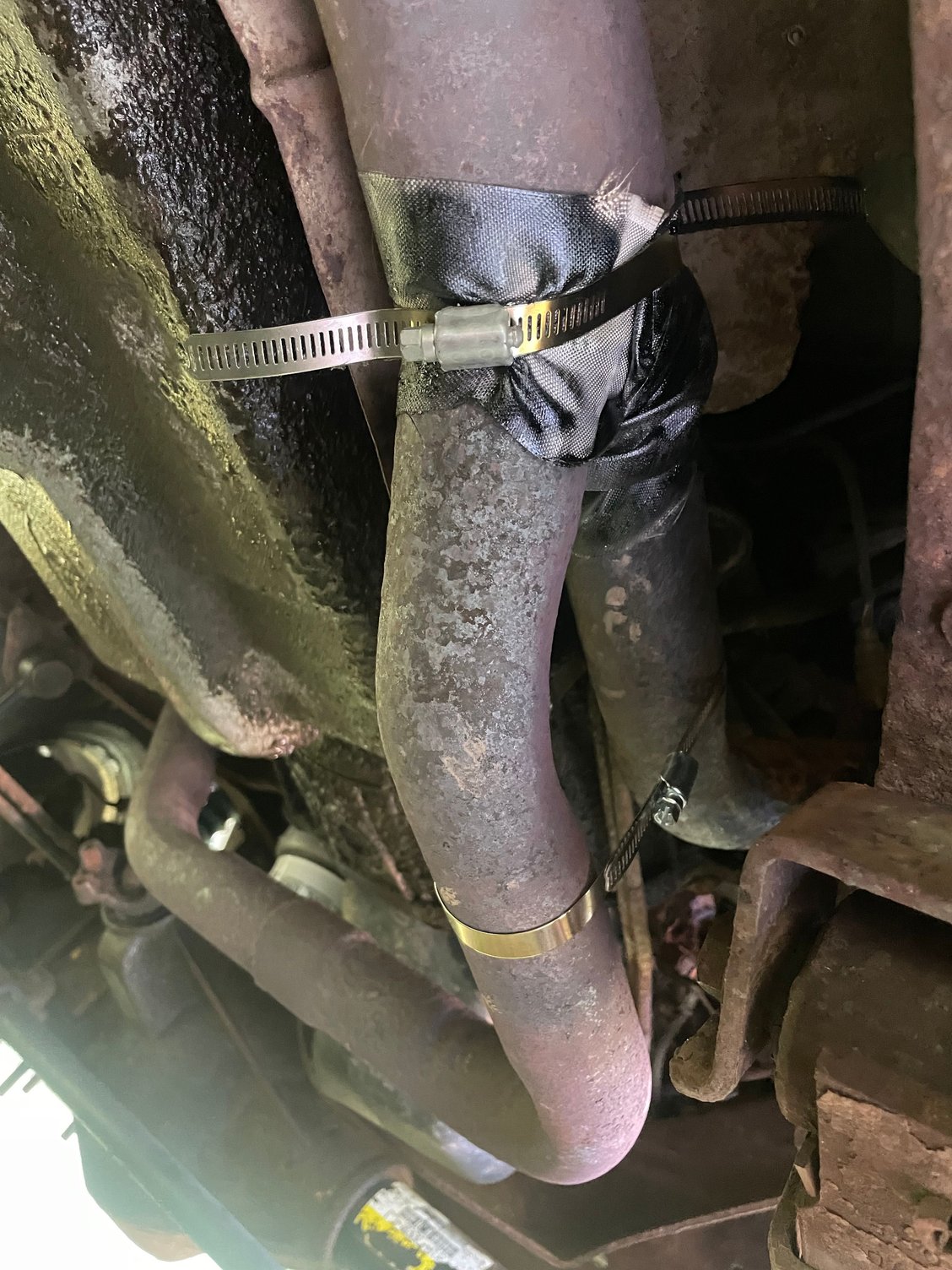

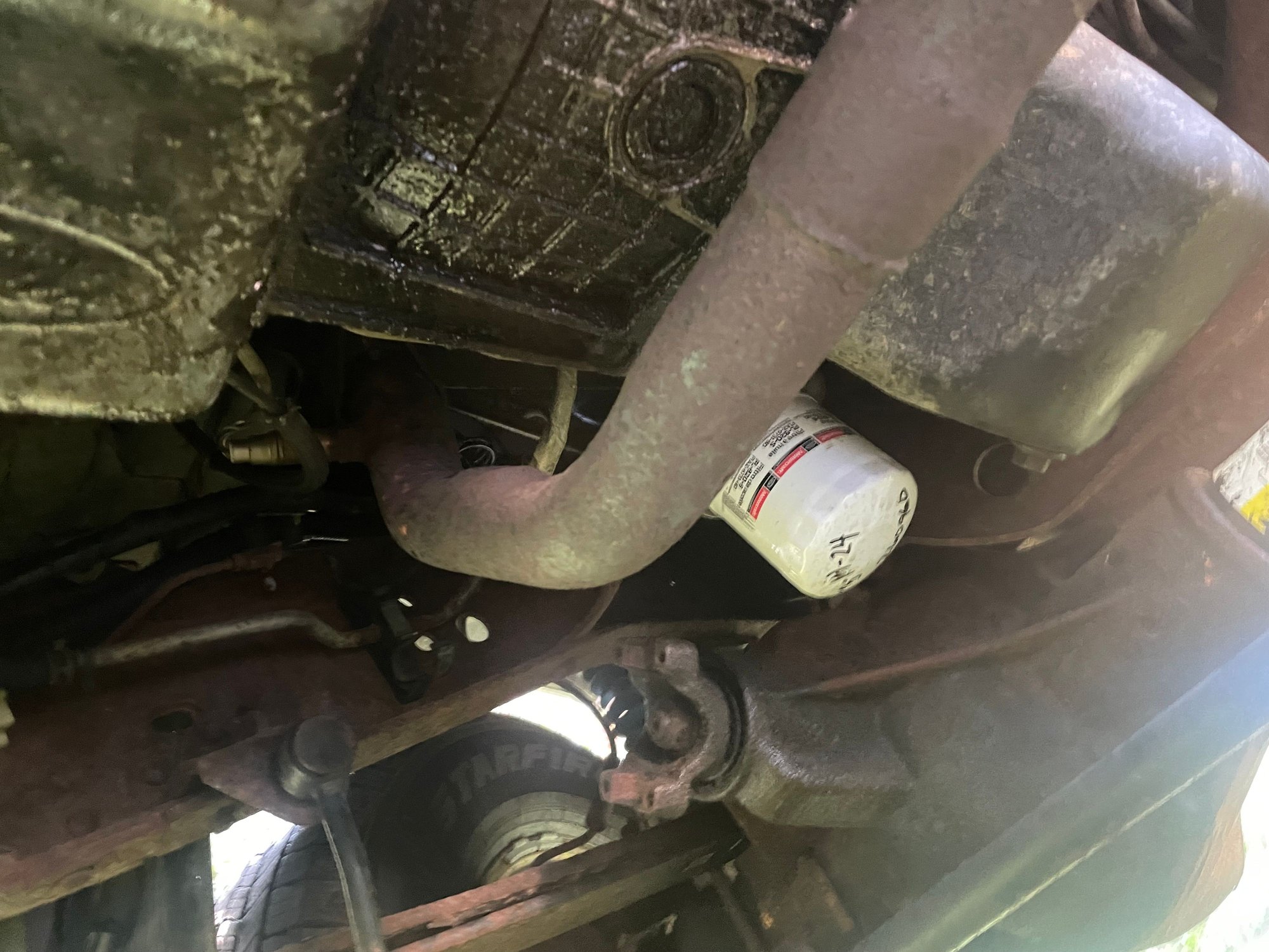

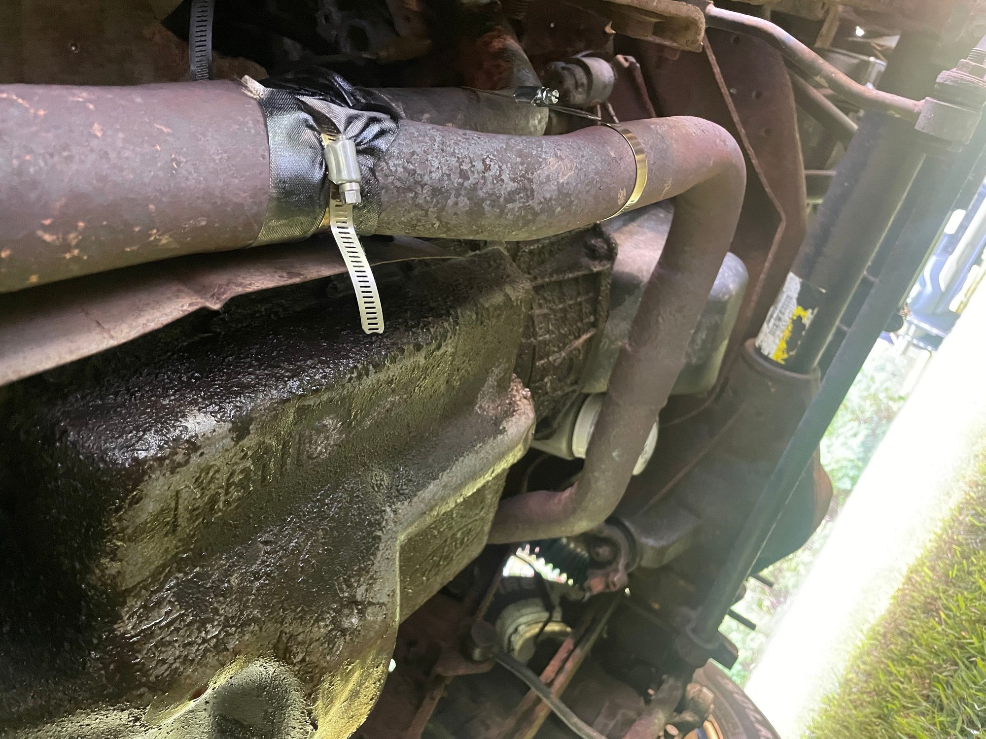

I was wondering if anyone recognizes this Y pipe assembly. It’s on a E99 f250 v10.

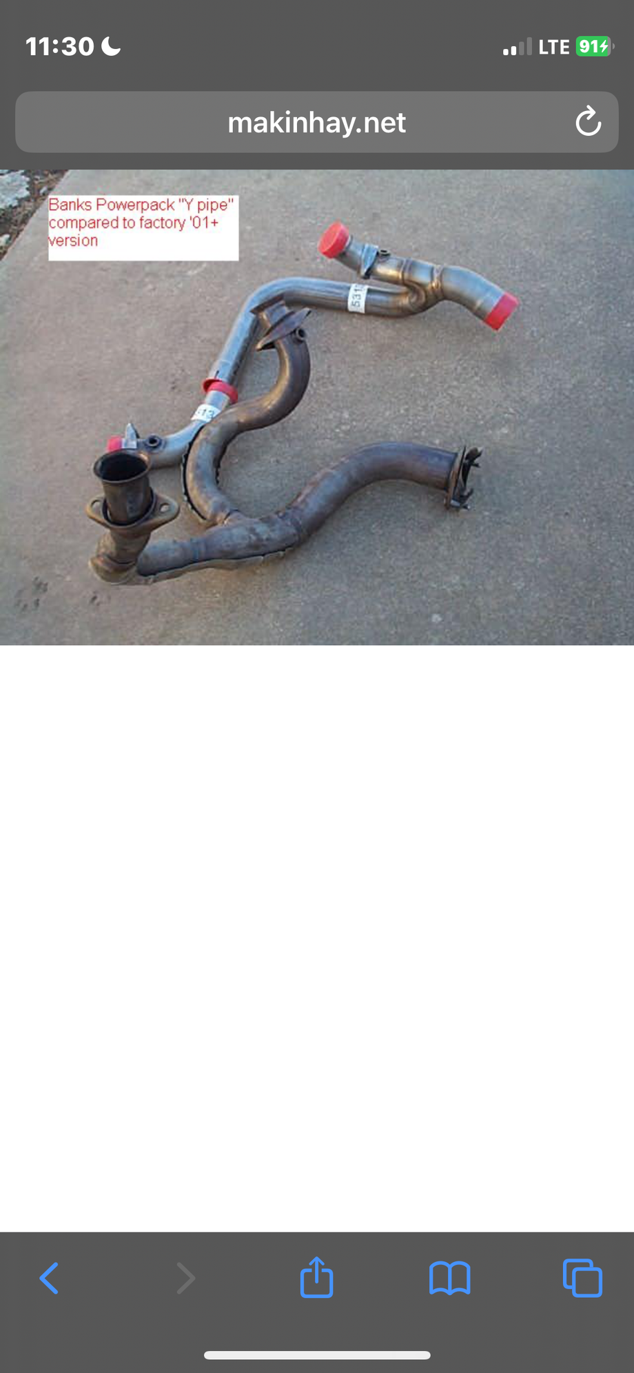

I found one odd photo that implies it was a banks piece before the headers were made.
I would like to replace the whole unit as this one broke heading home this last weekend and is likely as old as the entire truck build date is June of 98 if that matters. Thanks for any input.

By the looks of it, I'm thinking its factory - the pipe cracked at the Y weld & a PO mickey moused it rather than getting it welded or replacing it. I couldn't fid anything for a 99 E250 but here's a pic off the Rock Auto website for reference if that helps any. The link is for a 06 F250 with a 6.8 V10 - again, I couldn't find anything for a 99 E250 with a V10 but hoping this will give you an Idea of what you have going on.

Yeah that looks like a factory setup that just failed after time, and someone said 'oh I can fix that.'
Proper way is to pull it and re-weld it, or just replace it completely. Given the amount of rust I would fully expect the studs on the exhaust manifolds to break, unless you REALLY soak them with some PB Blaster for a few days. Or just buy headers and hopefully don't break the manifold bolts off in the heads.

this is a E99 (early ) F250. I have found the y pipe mods that are similar to this but slightly different I don’t think there was a stock pipe like this. I was hoping someone could say they had the early banks power piece and it was a match. I’ve found some of this info after my post.
Note the upper pipe it’s the same but different as what I have as the lengths look to be shorter.
