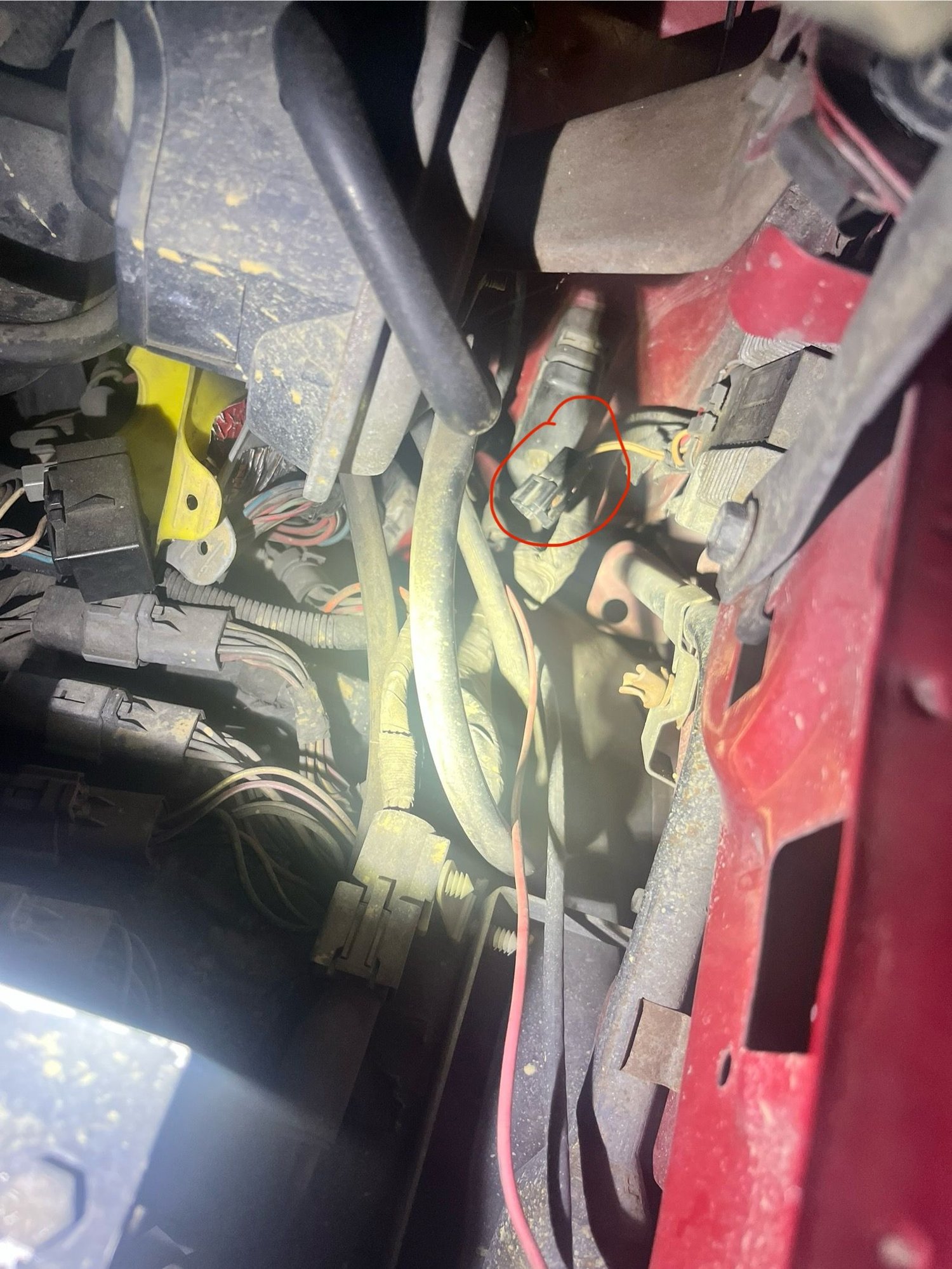

I appreciate the feedback. I did indeed set it with this plug unplugged. I assume it’s the SPOUt connector and not the octane one. How do I differentiate them?
Here’s the connector I’ve been playing with.

That is the SPOUT connector.

Correct, spout is the one by the module
THe other octane shorting bar is buried in the harness somewhere, so normal folks do not find and mess with it
