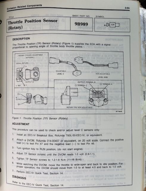

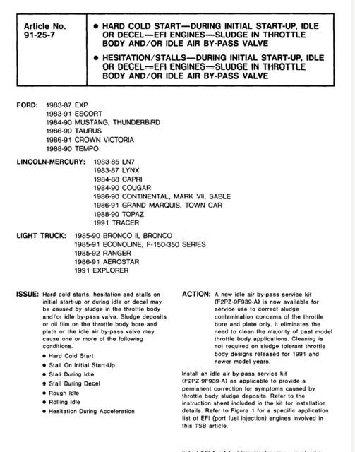

How are you adjusting the air on your EFI engine with the stock computer without a tuner?
With the factory ford part# F2PZ-9F939-A.
Ford TSB: 91-25-7
Are you adjusting the throttle stop screw? You can’t really do that since it also changes the TPS voltages.
No, that is to set your TPS to be <1.0 volts, like 0.95v.
Also, it stops the throttle blades from being 'stuck' in the bores.
Just like with timing set at 10*, why would you or not increase the TPS to more than 1.0V........because the ECU assumes these things.
Without any tuner, those settings should be set to factory.
Ford TSB: 91-25-7
Seattle FSB on bronco put this on his 408 emissions build, because of his cam size, at first.

Even at idle the computer is constantly adjusting the timing which you can watch with a timing light. The computer adds more timing and if it is too much it backs it off so it does not use a “fixed” setting of a x rpm and load is going to be y degrees of timing. You determined air with your foot and the computer is using various sensors to add or reduce the injector duty cycle.
You introduced a new part to the equation. That kit was not designed for that purpose and would only be effective with the throttle closed.
If I remember correctly, Mustang guys used that to fix rolling idle issues.
Wrong. The only purpose of that screw is to keep the butterflies from closing too far. Nowhere in the manual does it say to adjust the stop screw
Thanks for proving my point that you cannot adjust the throttle stop screw because it changes the TPS voltage. I can and had to adjust the screw for the engine to idle but I can also recalibrate my TPS.
