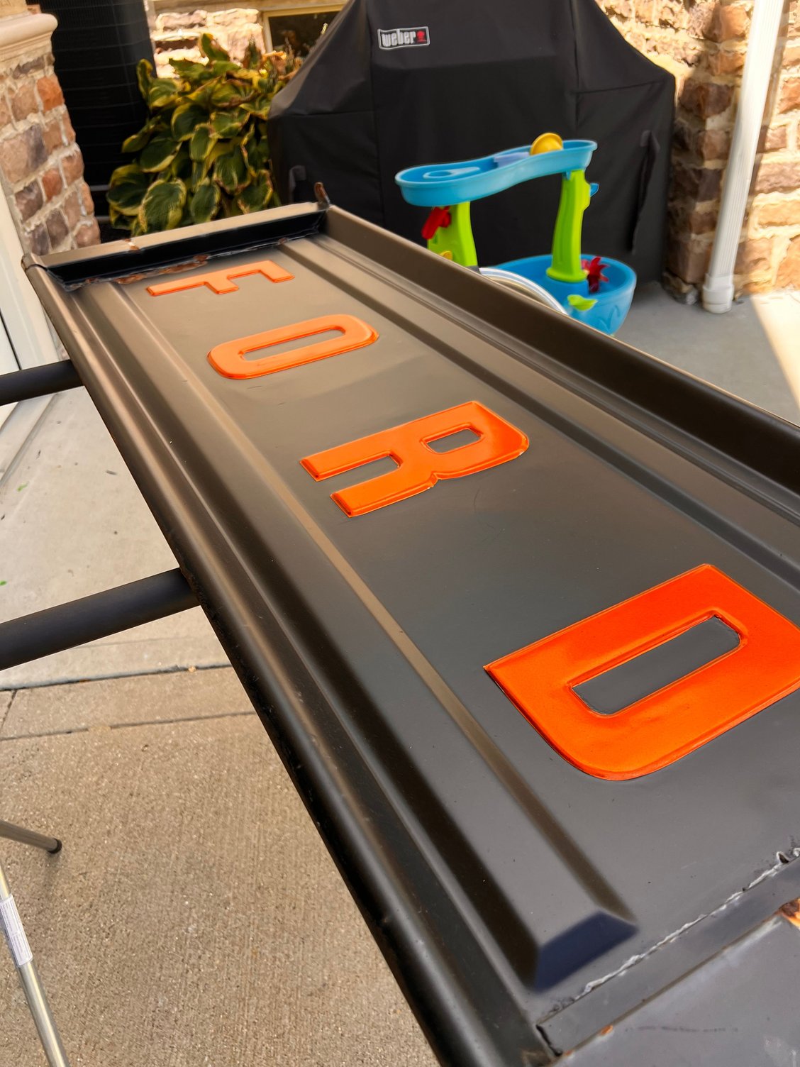

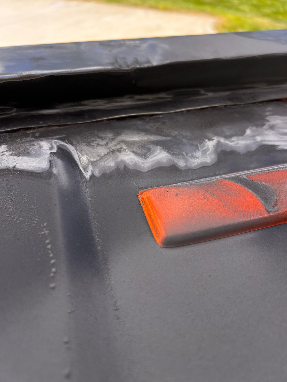

Starting in the tailgate. Old paint bubbling at the sides at these seams. Any idea how to mitigate this without tearing it apart? I was thinking of shooting some rust reformer in there with a straw.

I'd soak it with OSPHO and then seal it with POR-15. maybe the rust belt guys have a better idea, but it works on my fertilizer equipment.

OSPHO ordered. thanks for the recommendation. I tried whacking the wavy part of the sides w/ a hammer to flatten it out and was able to get a bunch of rust to flake out. I'll repeat this process, soak several times in OSPHO, and then try shooting some rust reformer in there on a straw, WD-40 style. I'm assuming rust reformer has phosphoric acid in it.
