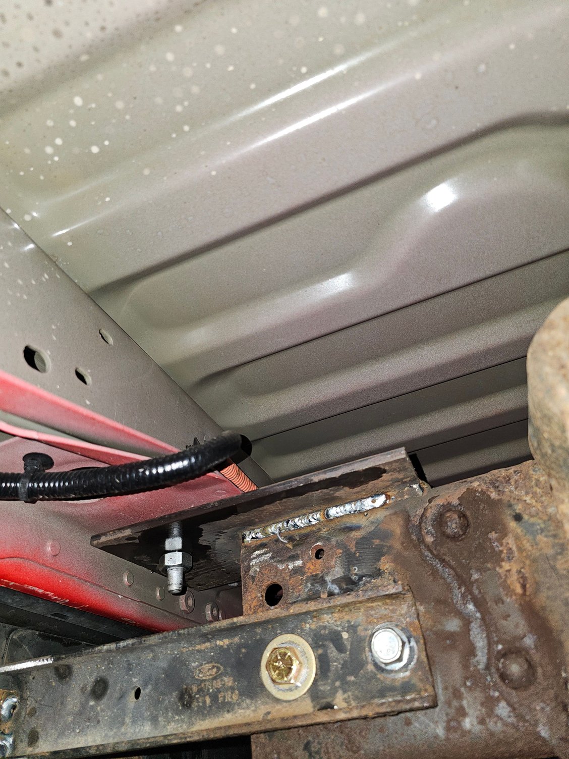

Once mounts were fabbed up I used a paint marker to mark my drill points through the new bed into the old frame.

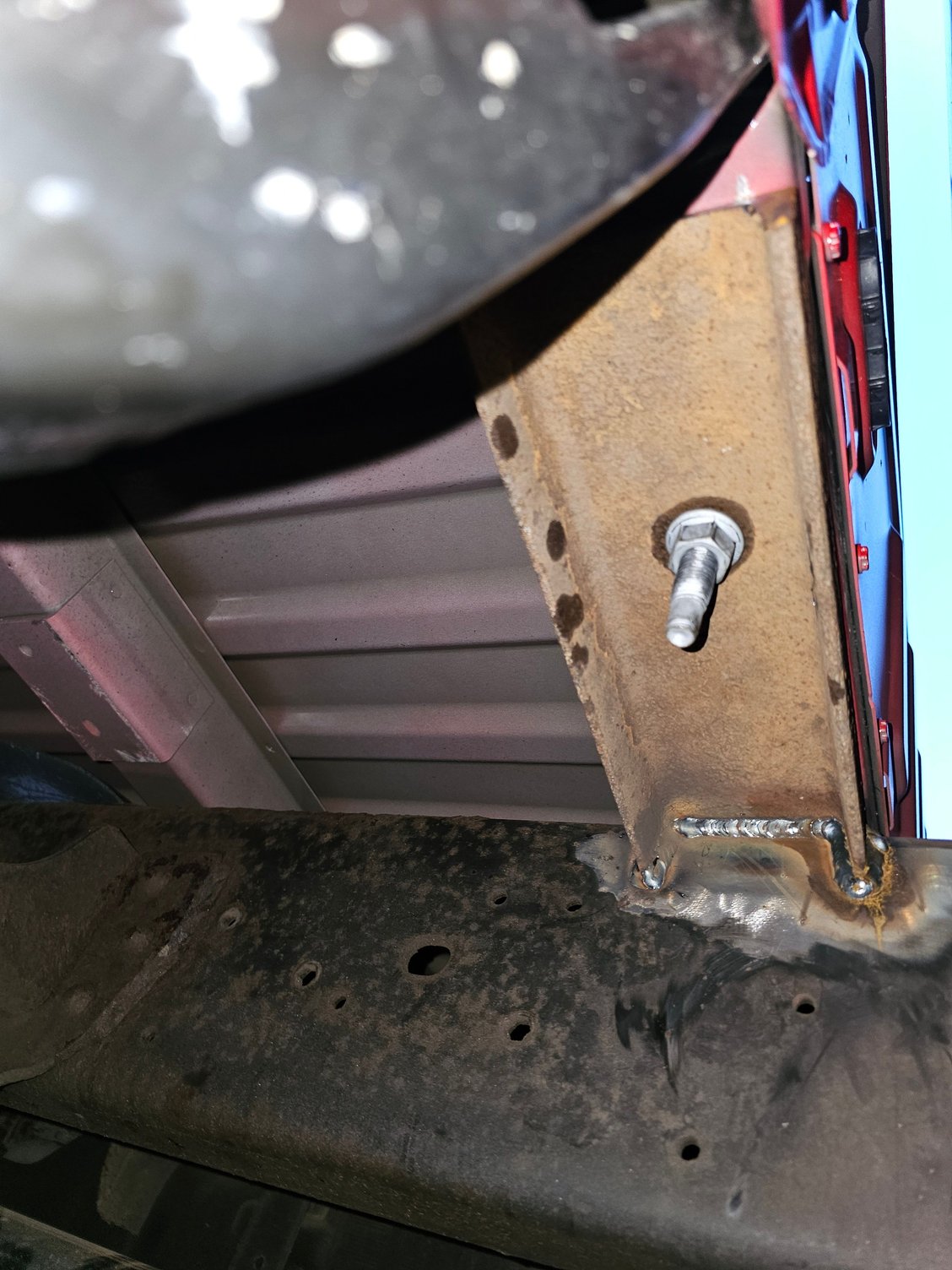

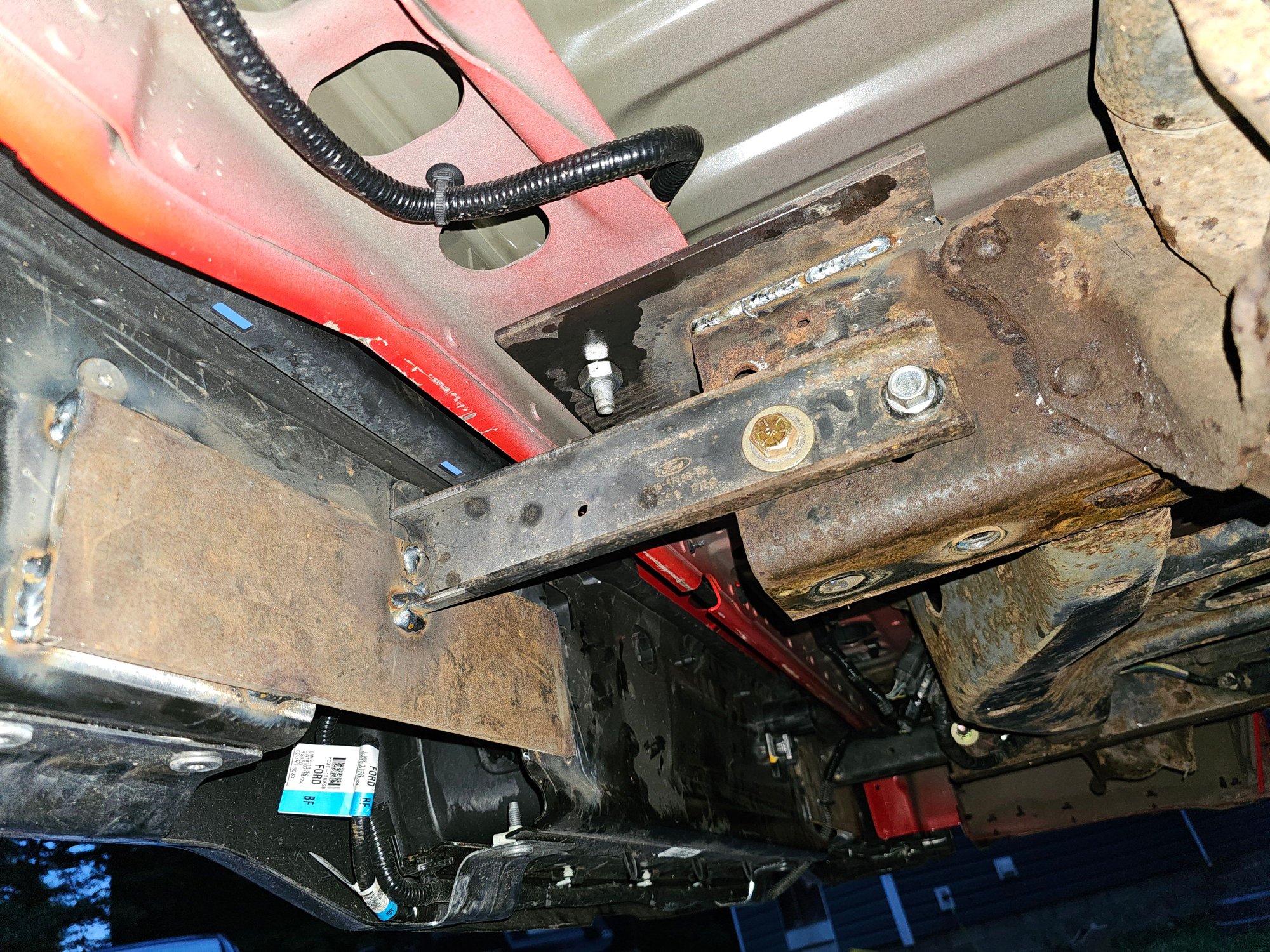

Step 6: Front Bed Mounts
The front two bed bolt holes were several inches off.
Solution: Welded 11.5" long pieces of 4" C-channel to the frame, squared to the frame and touching the new bed.
These became the new front bed mounting points.
Step 7: Mid Bed Mounts
The next four bed holes only required new holes drilled into the frame.
Drilled and bolted them down with the OEM 2024 bed bolts.

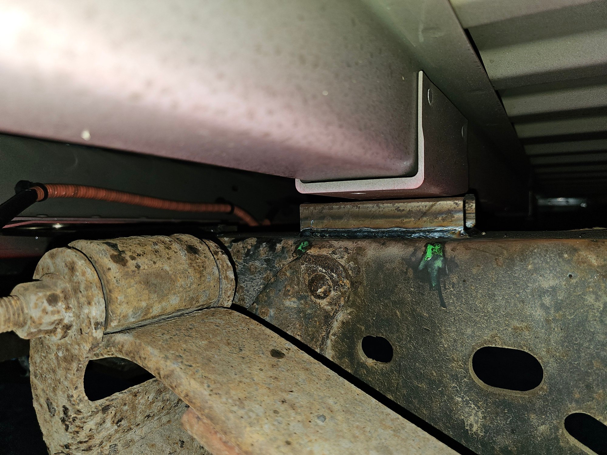

Step 8: Fifth Bed Rail Mount
This mount sat about 1 inch above the frame.
Fabricated a spacer from 3" wide x 1" tall steel tube.
Welded the spacer directly to the frame, there isn't any bolts on this rail I placed a piece of small rubber between the bed and metal.
Step 9: Rear Bed Mounts
The rear mounts were way off.
Fabricated ¼" thick x 6" wide steel plates and mounted them on top of the frame extending the frame out a bit but I was still 1/4 off in height due to starting with a 1/2 inch gap between the bed rail and frame.
Bolted the bed through them, using extra washers to take up the gap.
Drilled and pinned the bolts for insurance in case a nut works loose.
Note: two rear bolts were hardly long enough. Longer bolts are recommended.

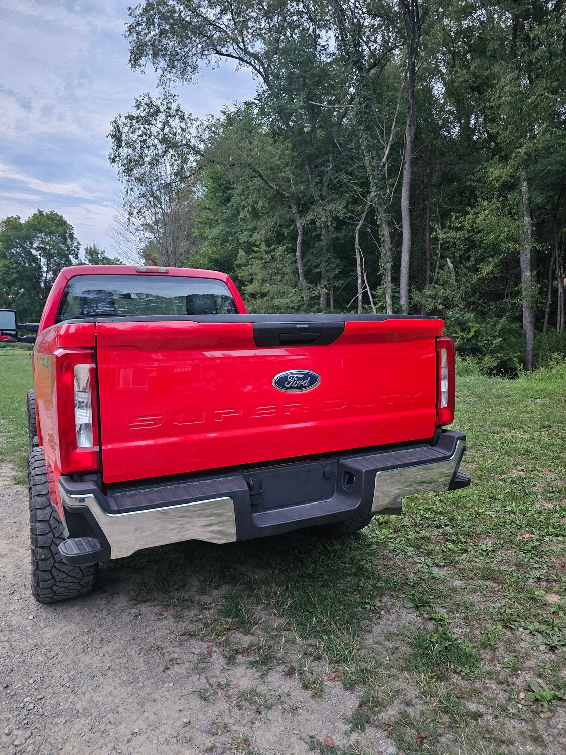

Fitment isn’t factory perfect, but the modern step bumper and aluminum bed look good... To me.
Cab will be painted to match the race Red color in the future.
Wiring was the biggest headache, but mechanically the swap was straightforward once mounts were fabricated.
So now I have a functional, rust-proof 2024 aluminum bed on a 2011 F-350, solidly mounted and square with the cab, with a modern look for a fraction of the price of a replacement steel bed.

We need a straight on side shot to see how centered the wheel/tire is in the bed opening. Also, you need at least one more vote option between Sharp and Park it haha. From the pic angles that you took, it looks better than I would have thought, but its definitely not as "sharp as glass" but is above BTN (better than nothing) A for effort!!

I am concerned about the stacking of washers though.

Here are a few more photos. I added one 1/4 inch washer to the last two bolts I couldn't imagine it going to change a whole lot but I'm certainly not an engineer lol ps won't let me update photos claims they are to big 😑

Did you put any insulating material between the aluminum bed and the steel frame supports? If not, there might be a chance for galvanic corrosion between the aluminum and steel metals.
