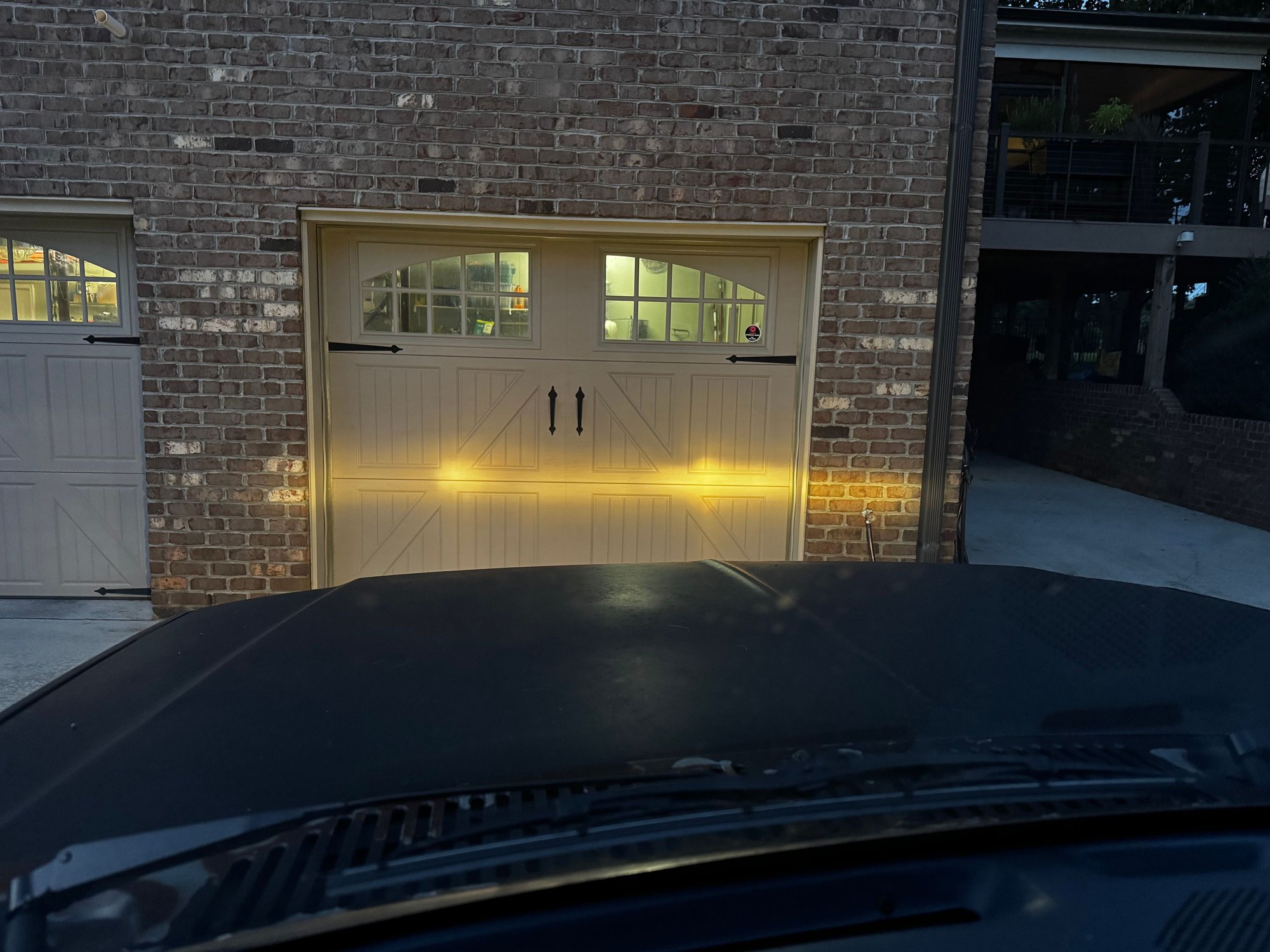

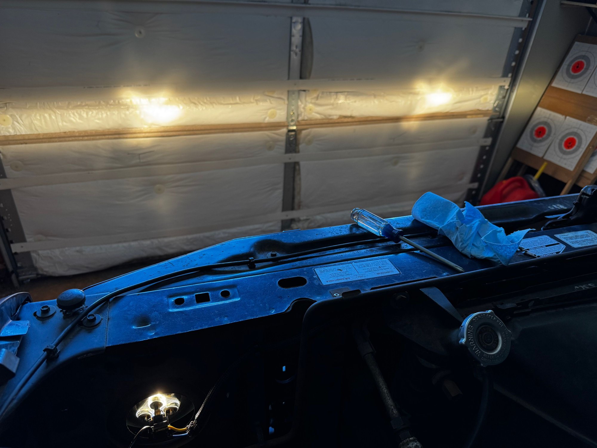

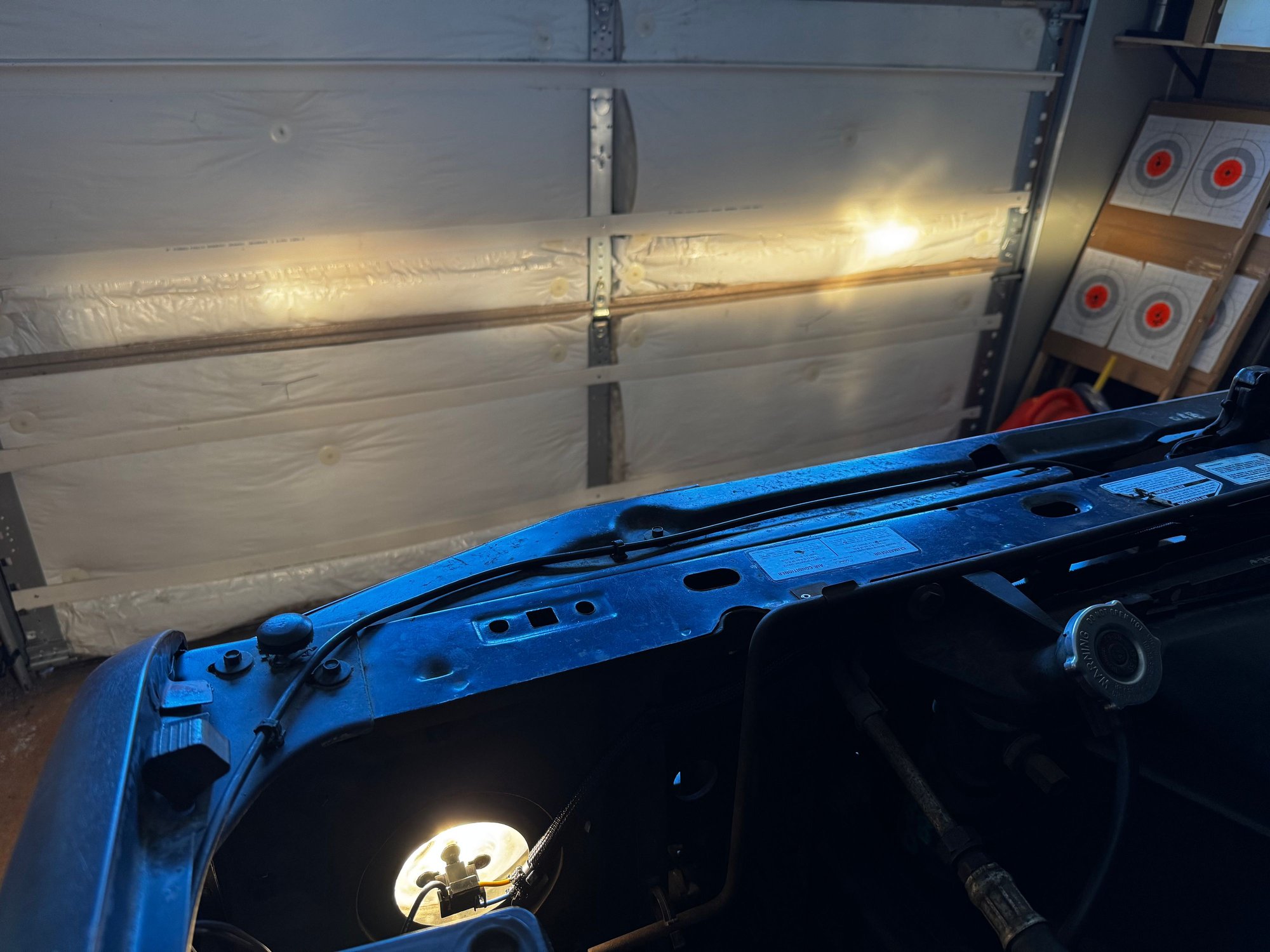

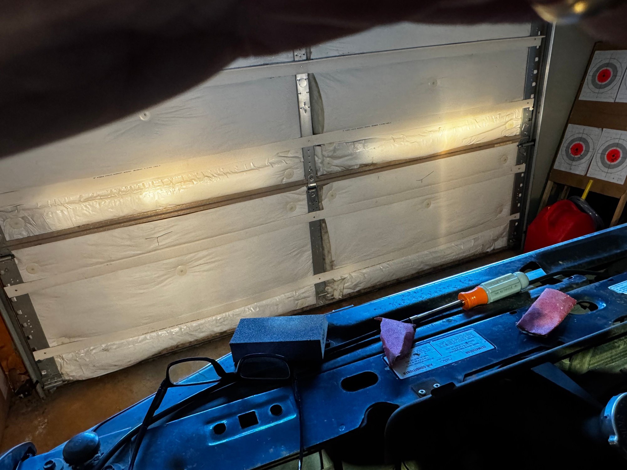

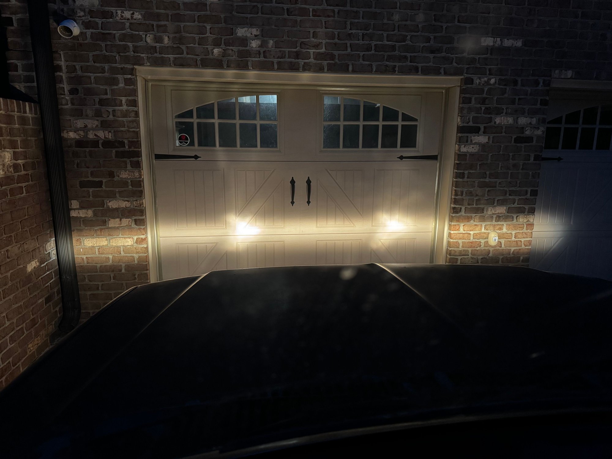

Got the lights done, put in the relay harness and upgraded sealed beams from LMC.
Old lights
Old lights
Old lights with new harness
New harness and new beam on Right
Two new beams
Two new beams
New beams outside, big improvement!
The old beams had a lot of corrosion and flaking on the inside surface, which I’m sure was a big part of why they were so dim.

Good job, I can see much better now.

Looking good a much brighter whiter light I think you will like them.
You may need to adjust them to work better for you.

Took the truck to work this evening, home at midnight. Lights are so much better! I do need to adjust them a little bit, the low beam pattern is too close on both and the driver’s side needs to move left a bit, but shouldn’t be a big deal to fix, I did put a bit of PB blaster on all the adjustment screws and make sure they were free when I did the installation. I won’t be looking for anything brighter. Thanks for the advice!
