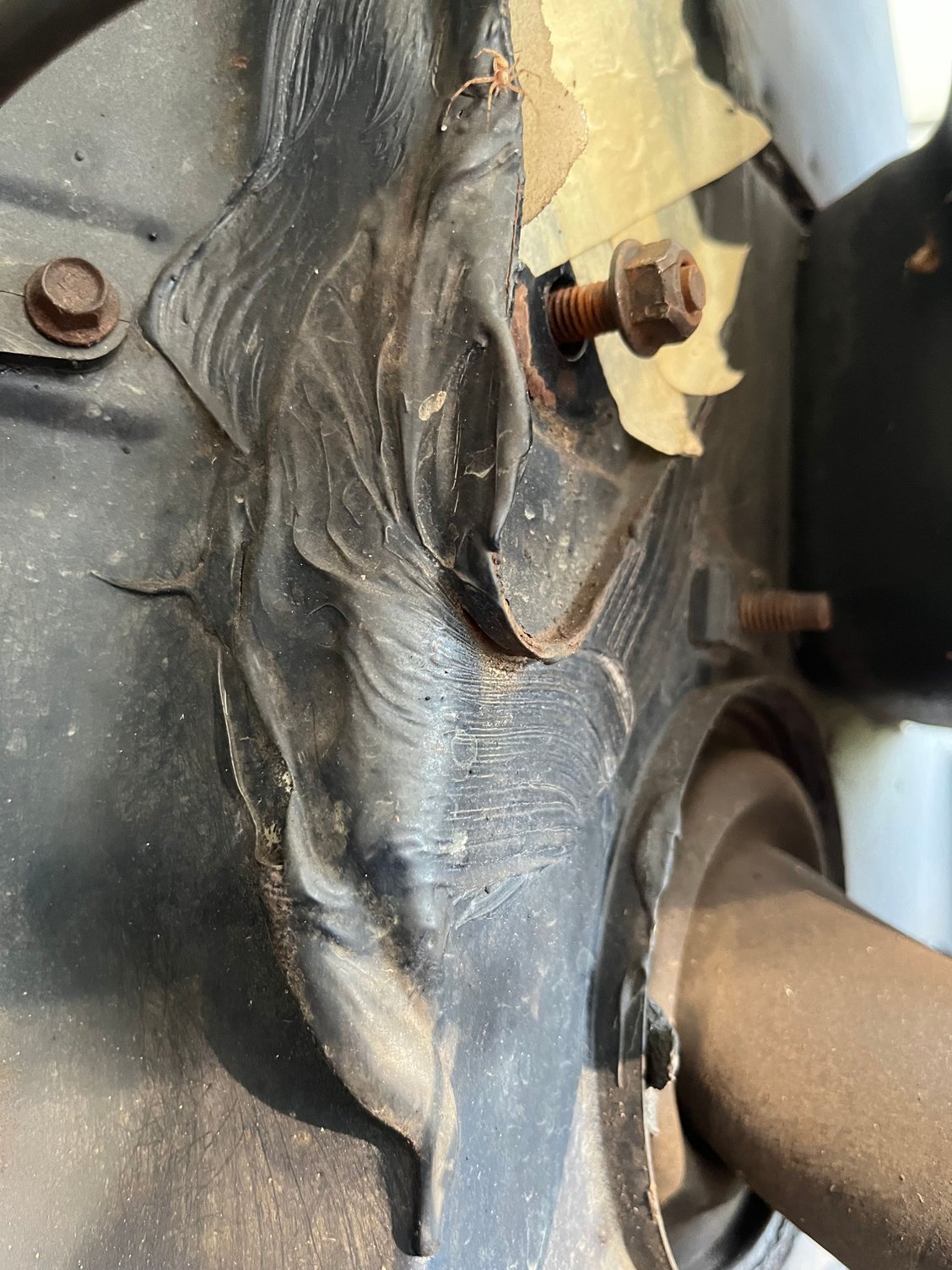

I'm slowly restoring my 92 F-150. I just got Por-15 on the frame, now I'm preping the firewall for paint. The old seam sealer is extremly sloppy. It doesn't come from Ford like that right? Probably something the previous owener did. Anyways I'm going to try to get it all off with a razor blade. In some places the seam under the old sealer is very tight with no gap. Will just paint be enough or should I re-apply a small bead of sealant?

That's how Ford did it. On mine, I put a pretty healthy bead of fresh seam sealer (butyl) all over the whole mess again,
after I cleaned out the rust, neutralized it and repainted. Mine was leaking at that seal...

I agree. The seam sealer in the picture looks like it was done at the factory.

Ford did a sloppy job of installing the seam sealer pretty much everywhere. I’ve been removing any loose or cracked sealer and using a paintable urethane sealer.

Thanks for the advice everyone. I did what @HydroDog suggested and removed any cracked/loose sealer, and the ugliest looking parts. I'll reseal were needed.
