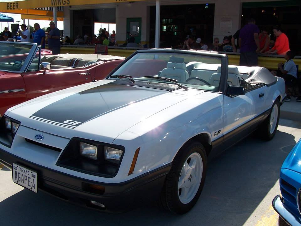

Nice, what color? Spent alot of time back in the day with a copper on tan 84 GT T-top. It was a Ford rental program car my good friend had that we ran hard and put up wet. The following year he got an 85 GT vert, he special ordered it knowing he would take the buy out at the end of the year...so it was babied, mostly highway miles between Houston and Lubbock Texas. This is the car I have now, it's purdy much stock with some Ford Racing parts...modified stock 4180C carb sitting on a Ford Racing high-rise dual plane intake, re-curved distributor with Ford Racing 8.8mm wires, E303 cam, GT40p heads, Ford Racing stainless steel headers, off road X-pipe, 8.8" rear diff. with 3:27 gear set, etc. Just enough to let it breathe and still be a nice weekend toy for the wife and I...
