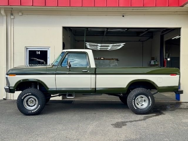

Good morning! I’m new to this group. Excited to be on board. I’m currently restoring a 1978 F150. Trying to decide on wheels and tires. My original plan was 35x12.5x15’s. I have a 4” lift and put in new 4.56 gears. Im running the original but rebuilt C6 tranny with a slight stall and 203 transfer case. The engine is the original 360 FE block with a 445 stroker kit. Can’t wait to hear her fire up for the first time. Anyway I believe I have the perfect set-up for 35’s but recently decided I’d like to go bigger. I want the more aggressive look of the bigger tire but worry about gear size and lower RPM’s for the big 445 stroker. Cruising around town she‘ll rarely be over 55 mph. Anyone running 37’s on 4.56 gears? I put in aftermarket radius arms that run parallel to the frame and kick out at the end for more room so I don’t believe clearance will be an issue at all. Thanks for your help!

If you like the look of bigger tires with less lift go with the 37s. I liked 35s with no lift on mine, but it rubbed a bit so I went with 33s. 33s with 3.50 gearing isn't too bad. Helps if you do end up on the freeway. From charts I've seen stock tires with 3.50 gearing should be pretty much the same as 35s with 4.10s or 37s with 4.56s. If you think stockish gearing would be ok, again, go with the 37s. If you want more gearing and don't do much highway you should be able to go quite a bit higher numbers than 4.56 with 37s.

The gears would be fine with 37's, but that is pushing it pretty hard for the front and rear axles. Most off-roaders recommend 35's max with the standard Dana 44. The center section of a 9 inch is legendary for it's strength, but wheel bearings don't hold up well under increased loads. That's why the F250 had the D60 rear and heavy duty duty D44 or D60 up front.

37's are pushing it on a 4" lift. From what I see, most 4" lift kits/systems say 35" max tire size.
When I bought my truck it had 36's on it. It looked like it had plenty of room around the tire. Friends said I probably had a 6" lift, but I have no idea what I have. So I went up to a 38" tire. Too close for comfort and could possibly hit off roading, so I added a 3" body lift. That was cheaper than new tires. I'm guessing now that I have a 4" lift. This time around I'm going back to a 35 or 36. No body lift and hopefully my springs aren't whooped. All I can say is, don't buy too big a tire and then wind up using a body lift to compensate.
Also, I always liked the larger brakes with the larger tires. So that would be my other reason for picking the 35's on a 150.
