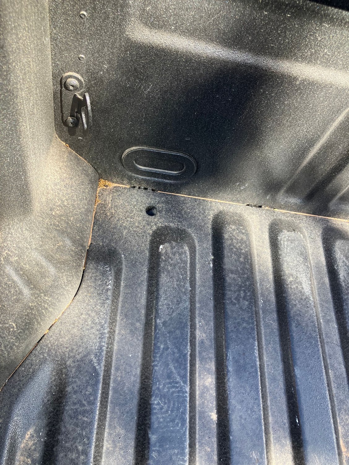

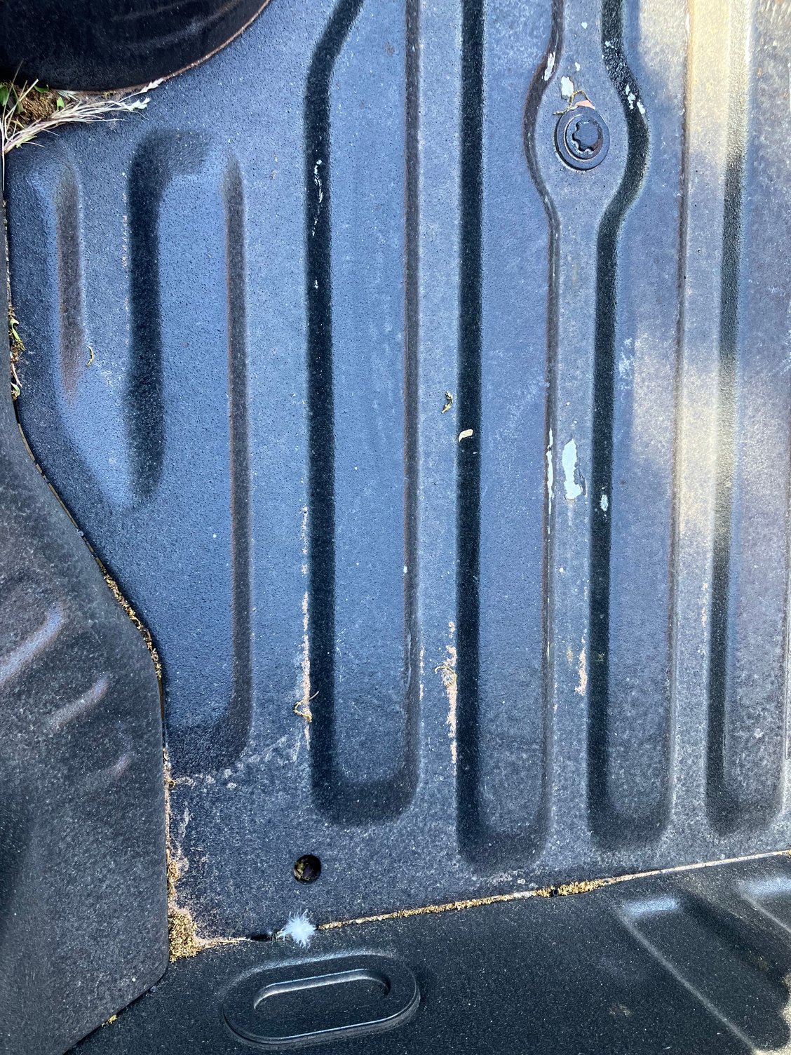

My 2020 F250 6’8” bed has what looks like 8 bolt holes but only
4 are filled with bolts. Is this normal? Is there a part number for these bolts and does the washer come with them?

Looks like someone drilled those for drainage. Look under there and see if there is a crossmember and a frame mount there. If not, no bolts needed.

My 2022 F250 has 8 bolts attaching the bed.........there is plenty of drainage in the bed, you are missing 4 bolts.

I don’t believe that’s a bolt hole, as mentioned before, that looks like someone drilled it for drainage! The bolts are all for the most part in line with each other.

Look at your bed.........the two bolts at the front, and the back are offset to the outside of the bed. The four in the middle are in line with each other.

2 rears are W718818-S902
6 others are W719365-S902
Weird thing is they come as packs of 4
I'm seeing some sources pricing them and apparently selling them individually, and some saying sold as a pkg of 4 only. Hopefully the nuts are still on the frame.
I owe you an apology, I’m use to looking at F150 bolts, and they are a little different. I pulled my bed mat up today, and you are correct sir, those are the front box bolt holes!
