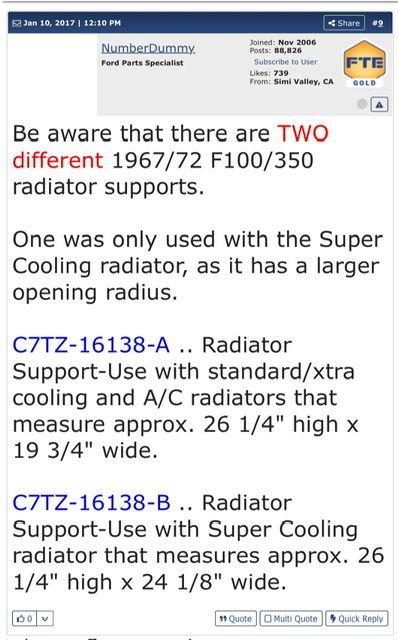

Yes, there are different core supports. I believe there may be three different ones actually;
1) 6cyl core support with the smaller opening.
2) 8cyl core support with larger opening.
3) 4x4 core support.

Screen shot from a NumDum post.
Anyone heard from Bill, lately?
