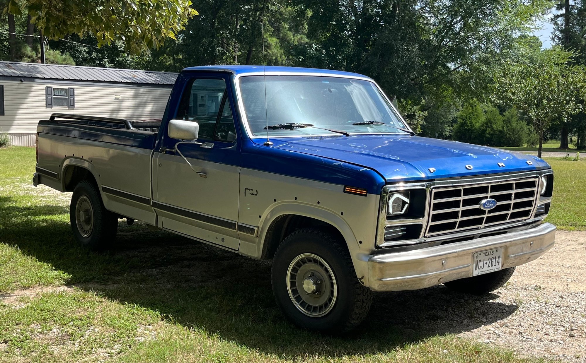

thanks Dave, its an 84 f150. Rwd longbed, stock springs and standard rake but about 2-3 inches lower (26”) on the rear under stock height (28”). Im sure the front is low and weak also, it bottoms out on a few potholes near the house and so I'm planing on replacing the front springs with a set of progressives that will give it about 1-2” over stock height on the front. I like the stock ride, kinda prefer levelled. But need to take turns at highway speeds so im thinking of adding a leaf or helper springs to balance it out as there is some side to side imbalance as well.

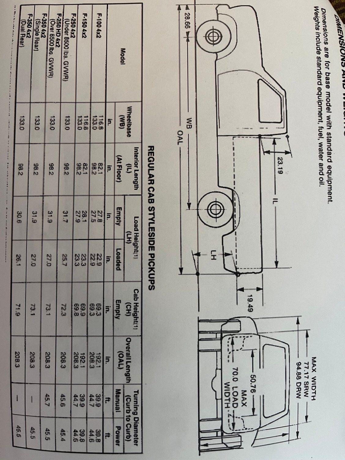

The 28” ride height came from the dimension drawings at the garagemahal. Its measured from what looks like the ground to the bottom of the base trim back by the rear bumper. Im assuming the front sag given i still have what looks like a natural rake.
https://www.garysgaragemahal.com/dimensions-and-weights.html

It sounded like you are measuring from body lines or bumper and that is not how it has to be done.
All measurements have to be from flat level ground to the frame, either the bottom or factory measuring points.

From what I am seeing they are measuring "LH" load height (both empty & loaded height) from the bed floor to the ground not the bumper.
I also dont see this being true as the bed could have been removed and replaced now with new bushings or shimmed higher because the cab has new bushings and sits higher.
But it is better than nothing I guess.
What does note (1) say?
I am not seeing "CB" cab height on the picture so I guess from ground to roof top?
Again not good if the cab has new bushings.
Dave ----
