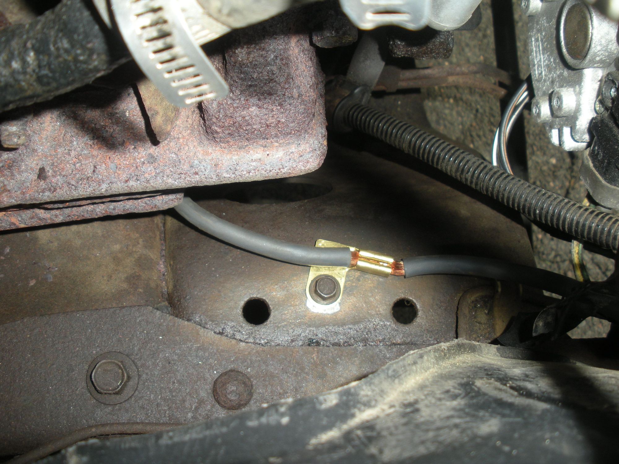

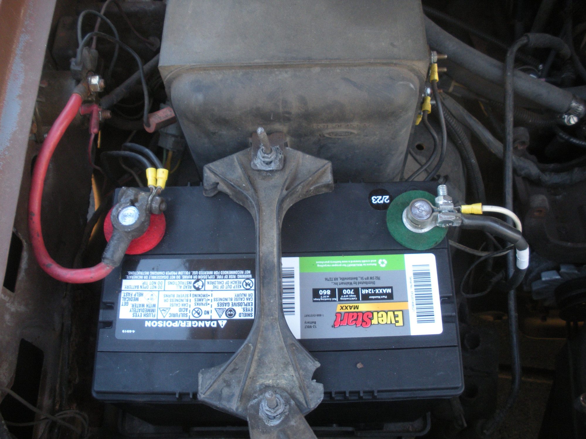

Max Capacity's Avatar
Max Capacity
Joined: Jun 2013
Posts: 5,690
Likes: 1,173
From: Tolland, CT
Timing was my first thought too.
Do your battery cables look like this ? Or do you have some clamp on terminals ? That's the chassis ground in the 2nd pic.
How old is your battery ? Most auto parts stores will test the battery for free.
Battery is brand new. I will send some photos when I get home. My battery cables on the terminals positive and negative are replaced within the last year
