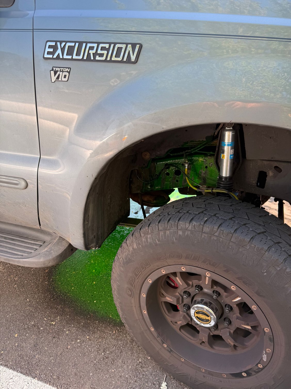

Guys,
Any ideas on this leak? Has new radiator and hoses. Just had this leak fixed and 2 weeks later it just exploded into a free flow waterfall while the car was just turned off after a 20 minute drive. It used to just be a slow leak, that was addressed two weeks ago.

Check all the hoses that run on that side of the vehicle. There are a bunch of coolant hoses that run on the side of the engine on the passenger side for the front and rear hvac. Head gaskets don't normally leak that much that quick.

Looking like it is the heater hoses and Water/Heater Control Valves. Does anyone know where I can get these parts and replace new. My mechanic is saying he cannot get them (or the parts are not made anymore) and the hoses have special fittings. He also says they are filled with scale.

If it's the hoses at the connection where they go through the firewall, they are a real pain to get to. I normally do my own work, but when mine started leaking there last year I took one look and said I ain't got time for that, dropped it at the shop.
They found, as you mentioned, that you can't get those fittings, or at least not easily. So they used some elbows and hose clamps.
Next time I was at the picnsave I pulled a set off a wrecked ex and have them on the parts shelf if needed.
I think you may need a new mechanic... Generic 5/8 heater hose, hose clamps and these are all you need. I don't recall if that is the right size so double check that first. Any autoparts store can get the heater valve also.

They did manage to find the Heater Control Valve and have it installed. Really hoping this is the last of this issue for the leaks. They did not manage to replace the hoses, it seems they think it is fine after flushing the hoses, with some chemicals, from apparent scaling. Believe I might take it somewhere else to have the hoses replaced, I do not want this thing coming back to haunt me when I am far out in the desert.
