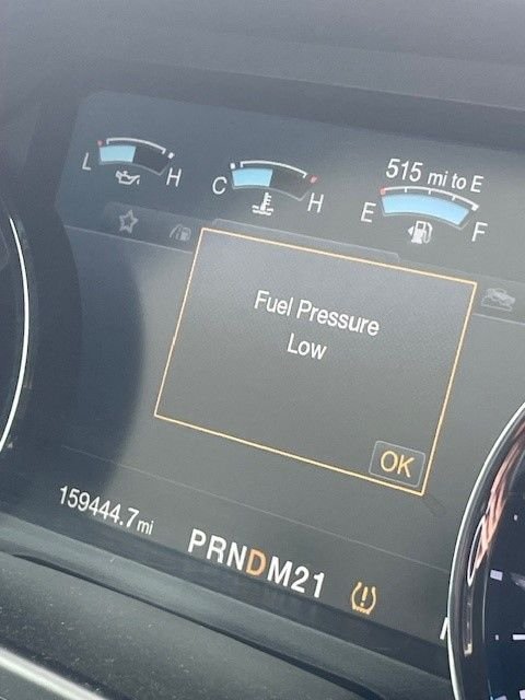

Update on my situation
So I drove the seven hours back to PA to get my truck from the Ford Stealership (Parsons Interstate Ford in Shippensburg Pennsylvania) once the repairs were completed. $14,380.30 later..... My wife drives the truck & follows me the 96 miles to the rental place to return our rented truck. After dropping off the rental when we get back in my recently "FIXED for damn near $15,000" truck when she starts the truck the same low fuel pressure warning shows up on the dash!!! I immediately call the dealer and he tells me I need to return to them at once so they can check the truck out... NOT Happening!! We pushed Ok on the steering wheel and the warning went away. The truck seemed to run fine the rest of the way home with no issues or warnings displayed. I have an appointment at a local trusted diesel mechanic to have the S&S DPK installed Wednesday next week and have the low fuel pressure pump tested as they explained that the lift pump in the tank may not be providing enough pressure to supply the CP4 that was just replaced. I am terrified to even drive the truck at this point but I have another camping trip scheduled for 8-20 and it is a 4 hour trip to our destination. Oh yea and I got the call from my insurance company yesterday saying that insurance does not cover this repair even though it was noted several times throughout the report that Fuel contamination was the reason for the failure. I am sick to death over this whole situation and I am way too far deep into this to ever recover. I just want a dependable vehicle that I am not scared to drive when its needed. Anyone else have any ideas why I am getting the low Fuel Pressure warning again there are no codes shown when I use a code reader.

That's frustrating. I'm starting to wonder if a bad lift pump was the culprit to begin with.

I wonder if low pressure from the primary pump possibly took out the CP4.... or added to it.
I feel for you and the family. Not only are trucks expensive (new and used), to have this kind of unexpected cost.
I changed out the CP4 on my DM to a CP3 at 75k miles. Best thing I ever did...but wasn't fun in my garage 4 weeks after foot surgery but that was my fault for eating a big bowl of ******* for breakfast.
You already have a new updated CP4, I would put a bypass kit and an external lift pump on your truck. Enjoy it for another 200k. I like the AirDog over the FASS.

Thanks! That's the plan... I have an appointment to have the S&S DPK installed next week. They will test the lift pump pressure then. I will be adding the external lift pump as well at some point but really hoping I can wait a bit to recover from the SH*$ ton of money I have had to spend in the last few weeks. If they say the pressure is too low I will just have to dig deep and make it happen now somehow!!
