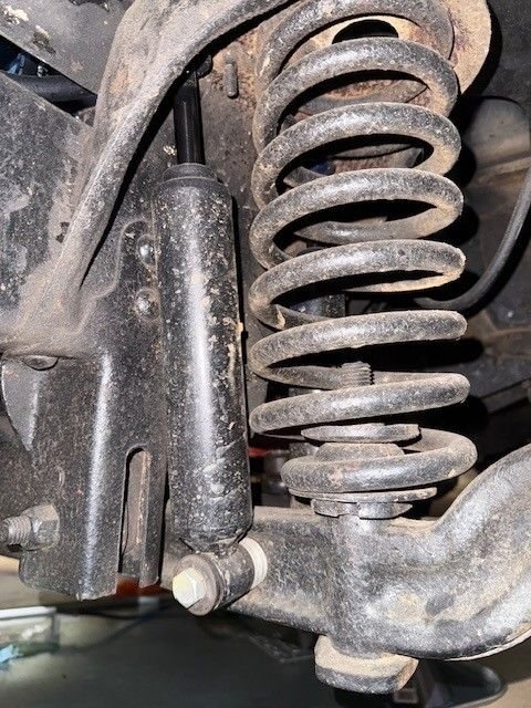

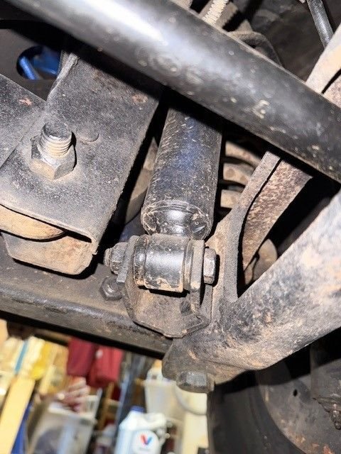

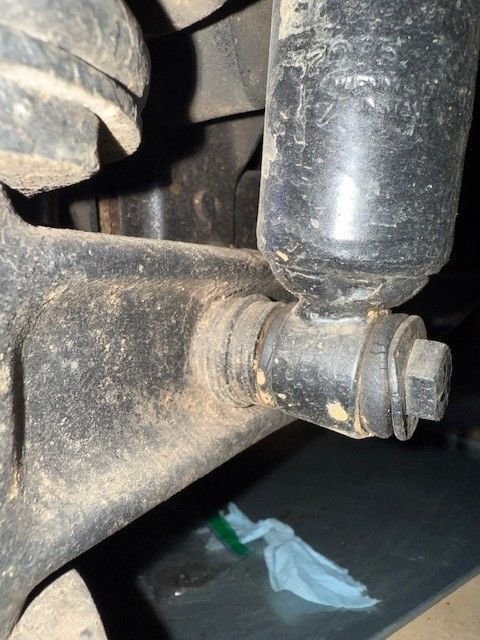

I'm thinking of replacing the shocks on my 1978 F100 (302, C6). Upon inspection, I have quad shocks up front, but I'm not sure they're legit. The rear shock in each pair is attached via a bracket to the radius arms. Makes sense. But the front shocks (those in front of the coils) are attached to the I-beams with a bolt and a stack of washers. From what I've seen, quads required add-on brackets. Does anyone have info on quads? I believe they started the quads in 1978 - but I don't know if they were available on an F100...and they seem completely unnecessary on a 2WD, small, city truck with a 302, 2.75 rear diff gearing, and stock size tires.
Do I replace the shocks behind the coils and delete the fronts? Replace the quads? Thanks!
Passenger side - showing the pair of shocks on either side of the coil.
Rear shock in the front passenger pair
Front shock in the front passenger pair (note the stack of washers to build out the I-beam surface)
View of the front shock on the driver's side. The washers are easier to see.

I was expecting to see an F150 4wd front end, not a 2wd. That looks home made to me, I'd try it without the extra shocks & see how it feels.

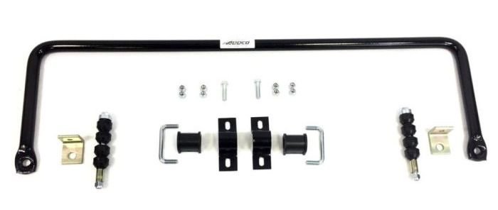

Does anyone know the mounting bolt distance for an aftermarket sway bar? My truck doesn’t have a sway bar - but the holes used for the shocks look suspiciously similar to the holes required for a sway bar like this. I wonder if the PO yanked the sway bar to add more shocks.

I think is a home grown addition. I never heard of a quad or dual shock option on a 2wd, only on some 4wd trucks.
