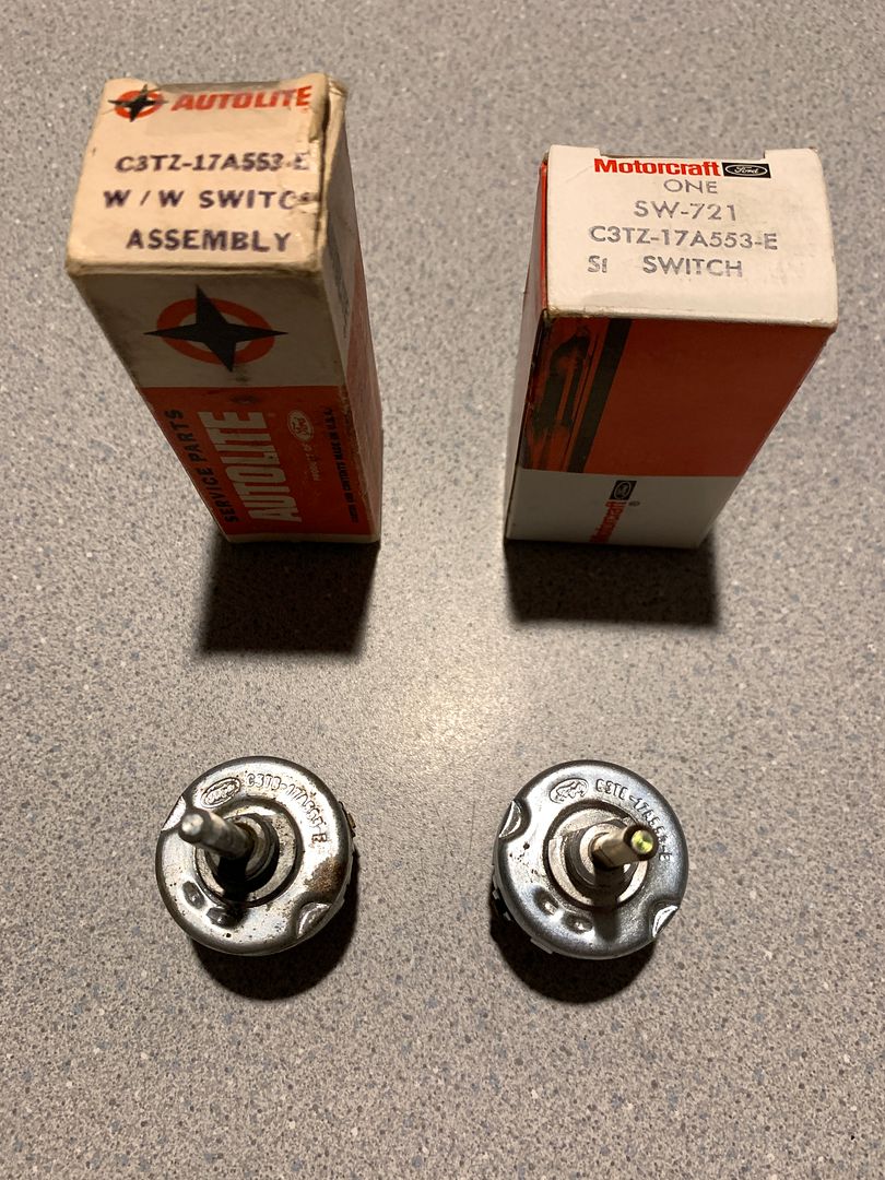

Assuming you have a 2-speed wiper motor this should be the supersede part number.
C3TZ-17A553-E (SW-721)
NOS Ford windshield wiper switch 1964 1965 1966 E100 F100 600 two speed | eBay

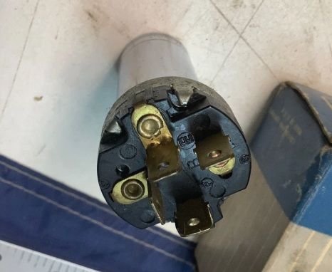

Look at the one at the link to eBay above and see if the terminals look the same as what you need. I think they do just rotated so it might look a little different initially. I turned it 180 degrees and this is what it looks like
They are fairly common. I have a couple of them on the shelf just in case.

Read this thread for the older part number. Not sure if the newer number I gave interchanges for sure. The terminals look the same but maybe the pinouts are different.
2 speed windshield wiper switch - Ford Truck Enthusiasts Forums
