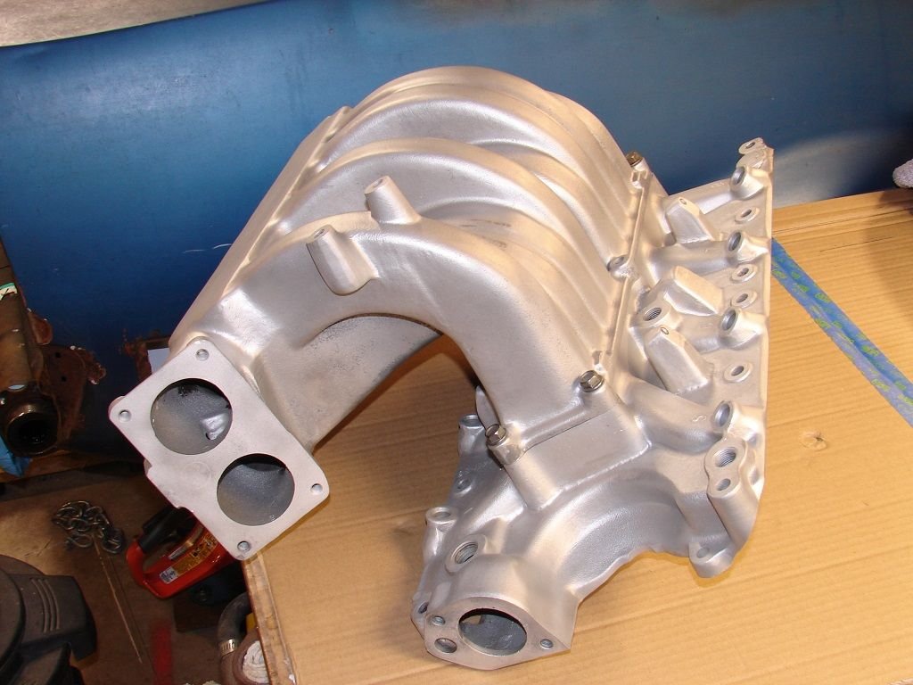

Thanks for all the replies! I’ll just start working my way down the list till I get it cleaned. I sand blasted the whole outside of the thing so I’m not going to paint it unless anything wrong happens during cleaning. I cleaned my lower intake with a bunch of stuff and wire brushes and aluminum brightener. Turned out good enough for me so I like to upper to match cosmetically. I’ll attach a picture to this post. Sadly the picture was taken before I installed my scorpion rockers so they will not be in the picture.

You're going to need to paint or seal it, or it'll be covered in white corrosion soon.
This is my first 5.0/5.8 hybrid intake.
First is after bead blasting ($15 @ my machine shop)
Second is after VHT hi temp natural aluminum paint.

Thats why I started paint them also, they turn white with corrosion and also suck up every drop of oil and look bad in no time.
