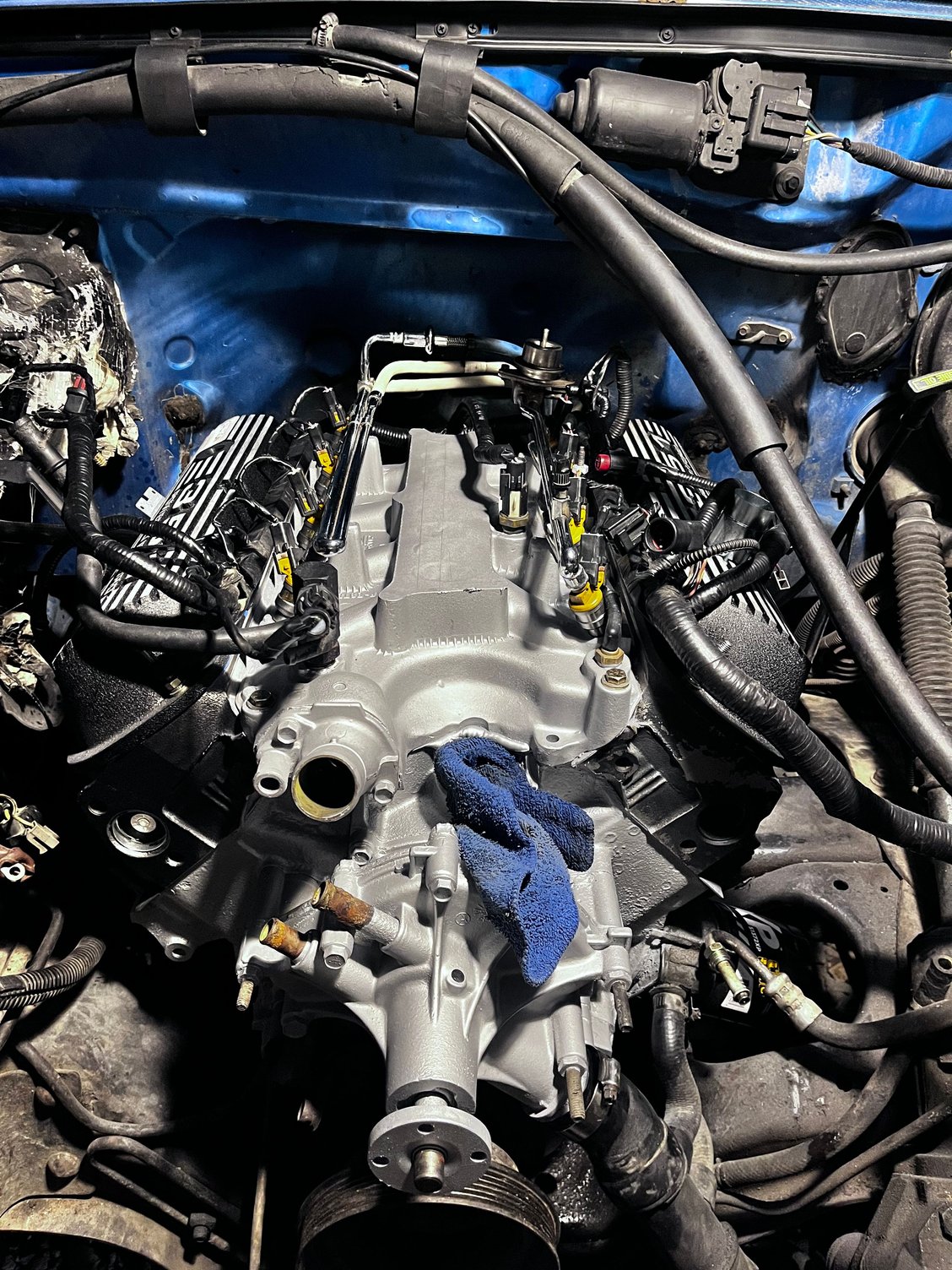

I would just throw towels or something over everything else and spray away personally.

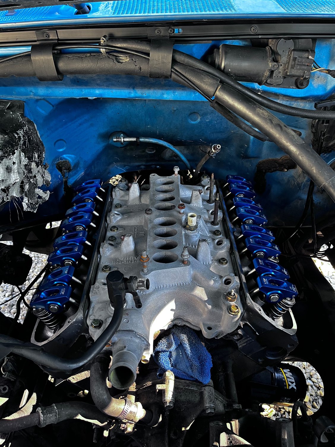

Old Jul 24, 2025 | 09:51 AM
Nmaykdm's Avatar
Nmaykdm
Joined: Jan 2018
Posts: 226
Likes: 11
From: Branson West, MO
This is how it looks now
Old Jul 24, 2025 | 10:35 AM
Scndsin's Avatar
Scndsin
Joined: May 2006
Posts: 12,338
Likes: 1,314
From: Central Mississippi

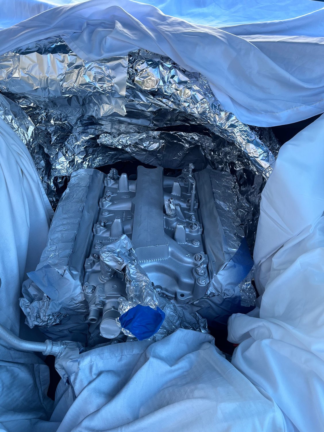

Tape it off, paper, aluminum foil, clear plastic wrap... it all works.
Take care with injector boss.
Old Jul 24, 2025 | 11:12 AM
HydroDog's Avatar
HydroDog
Joined: Jan 2007
Posts: 337
Likes: 100
From: Salkum
In places that it’s hard to tape, I have used light grease and a fine paint brush to apply a light coat so the paint will not stick. Just wipe off when your done.

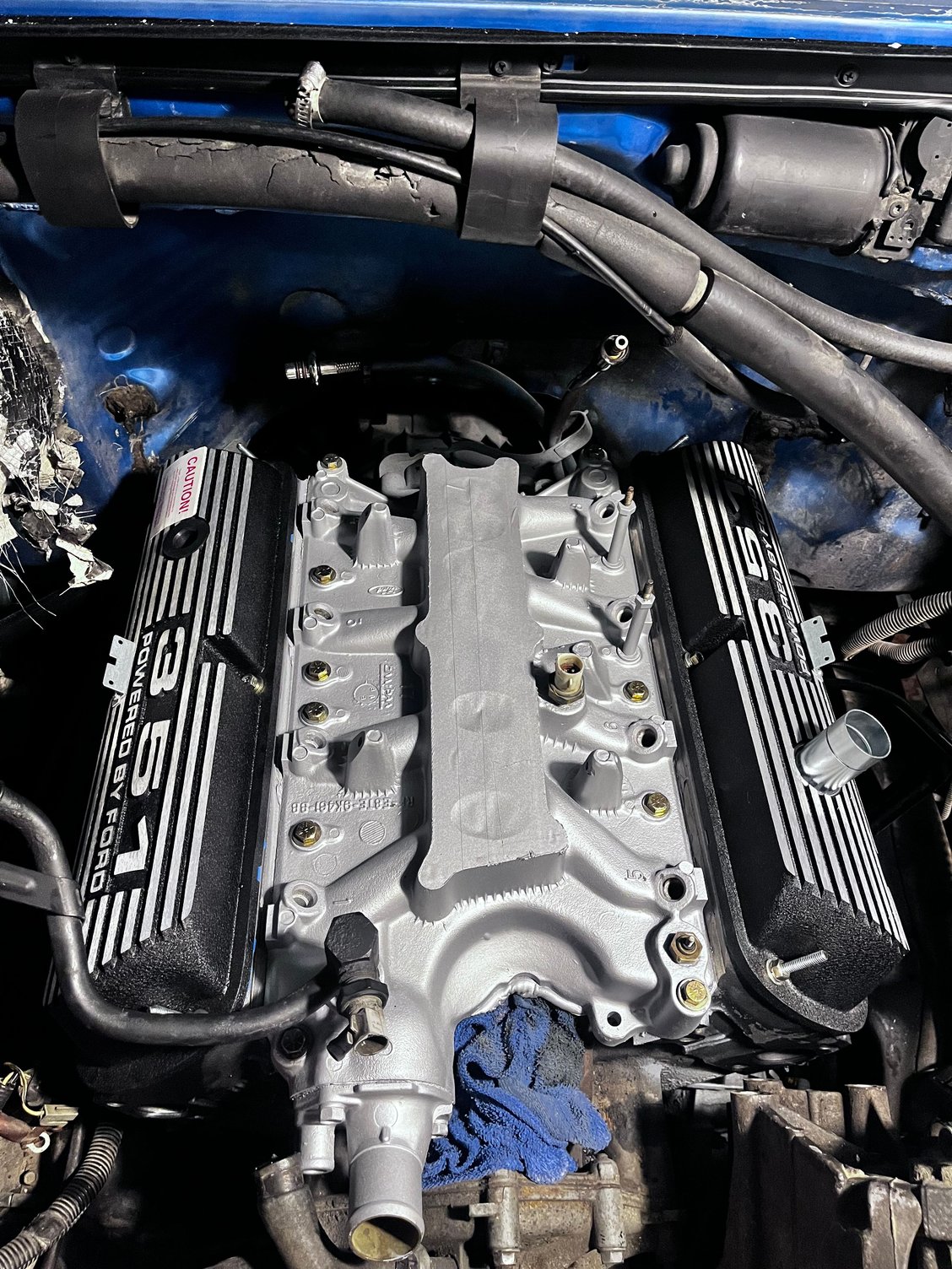

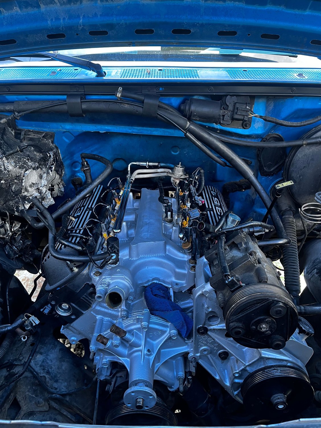

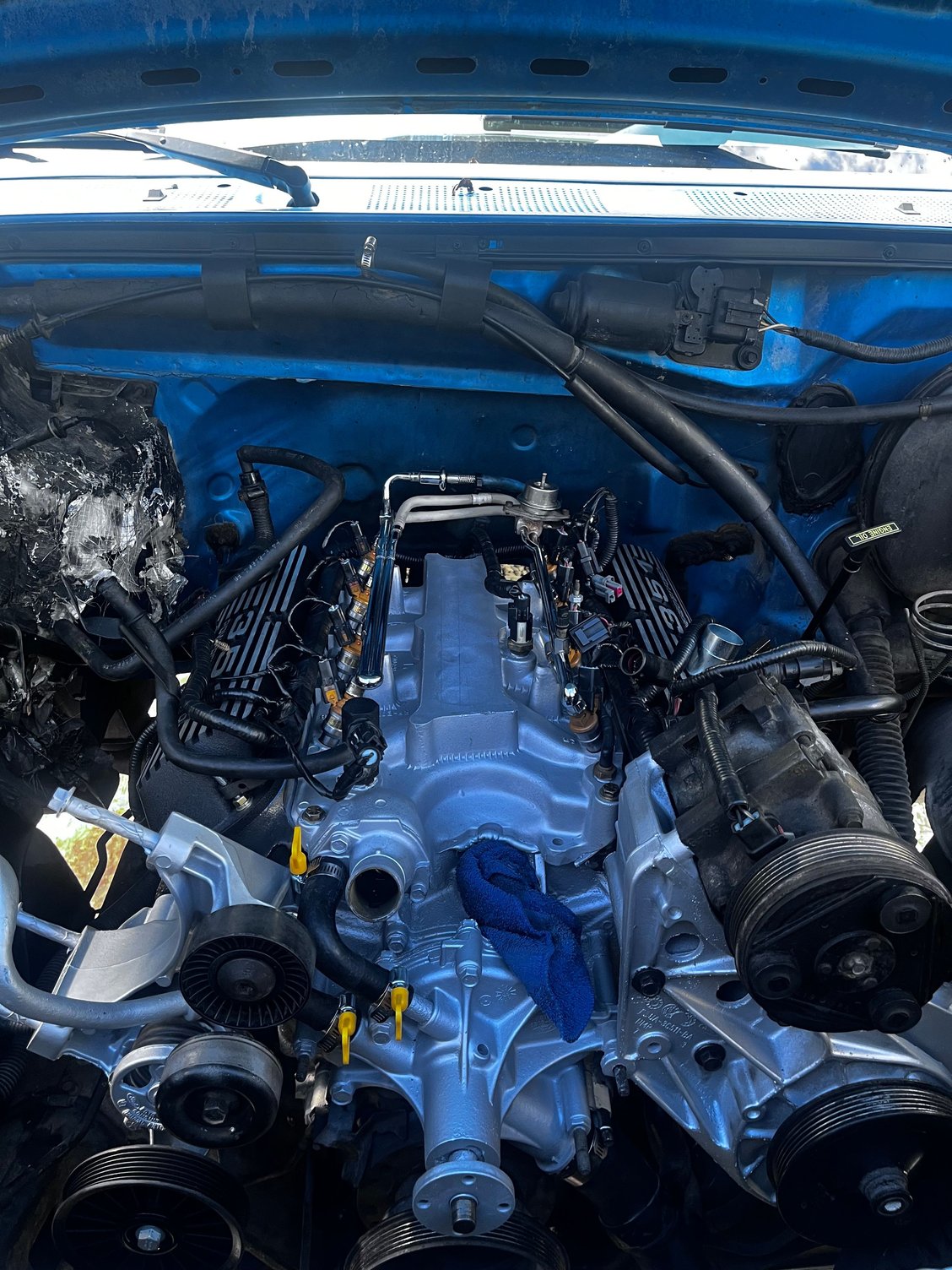

Old Jul 27, 2025 | 01:05 AM
Nmaykdm's Avatar
Nmaykdm
Joined: Jan 2018
Posts: 226
Likes: 11

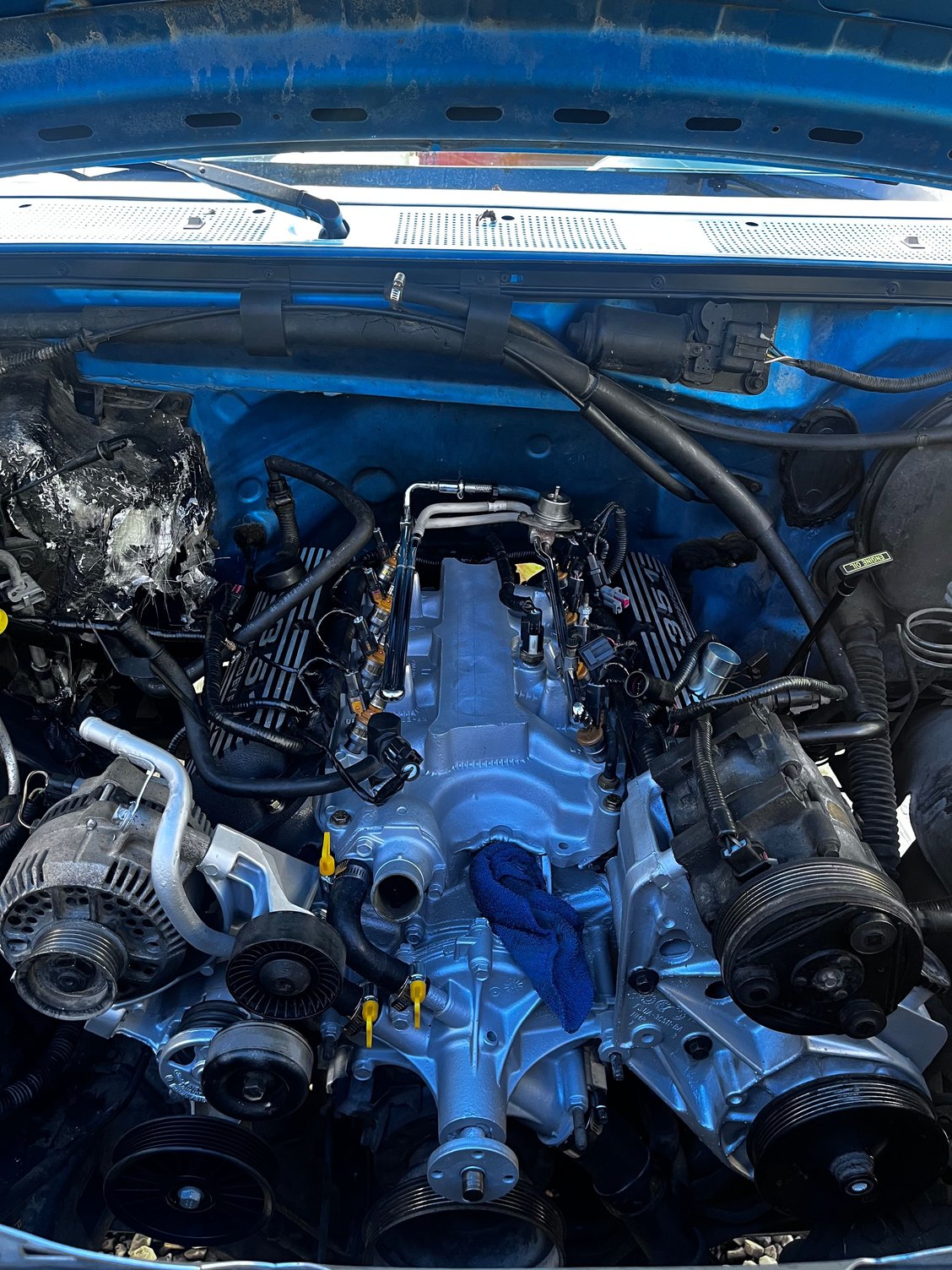

Current update. Painted pulley brackets are next
Old Jul 27, 2025 | 01:20 AM
Scndsin's Avatar
Scndsin
Joined: May 2006
Posts: 12,338
Likes: 1,314
Nice work.
Old Jul 27, 2025 | 02:03 AM
HydroDog's Avatar
HydroDog
Joined: Jan 2007
Posts: 337
Likes: 100
From: Salkum
There you go, looking good now.
