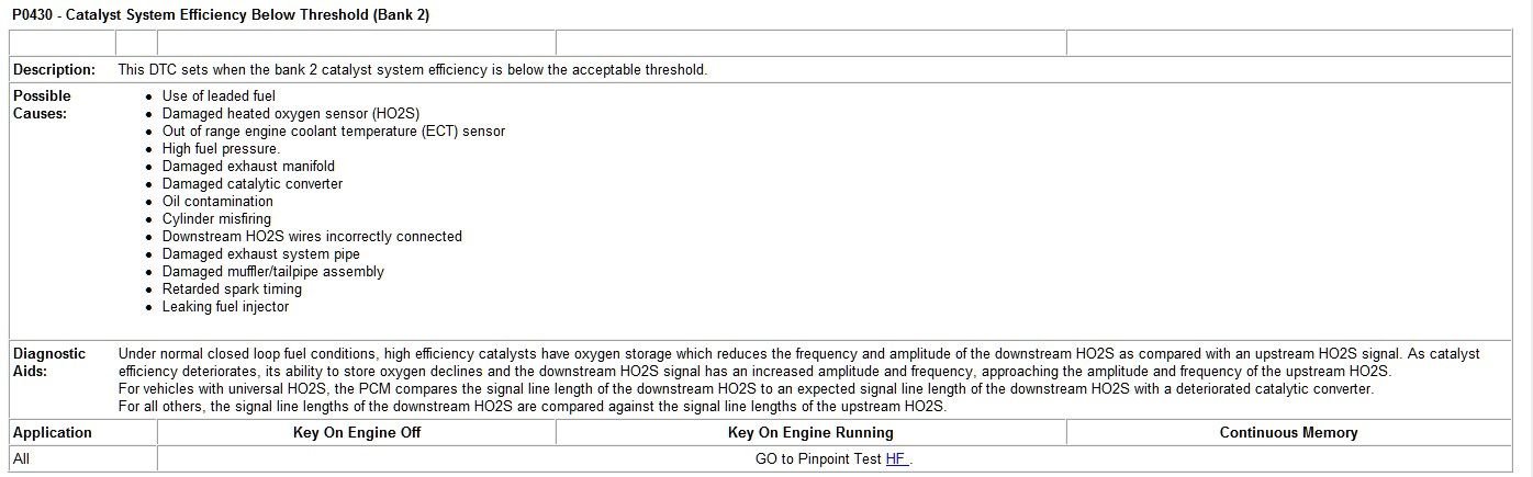

OE cats are the only way to fly, had too many aftermarket cats not lasting to bother with them. Here's some more specifics for that code but yes, typically when that code pops, it's usually a cat gone inert.
