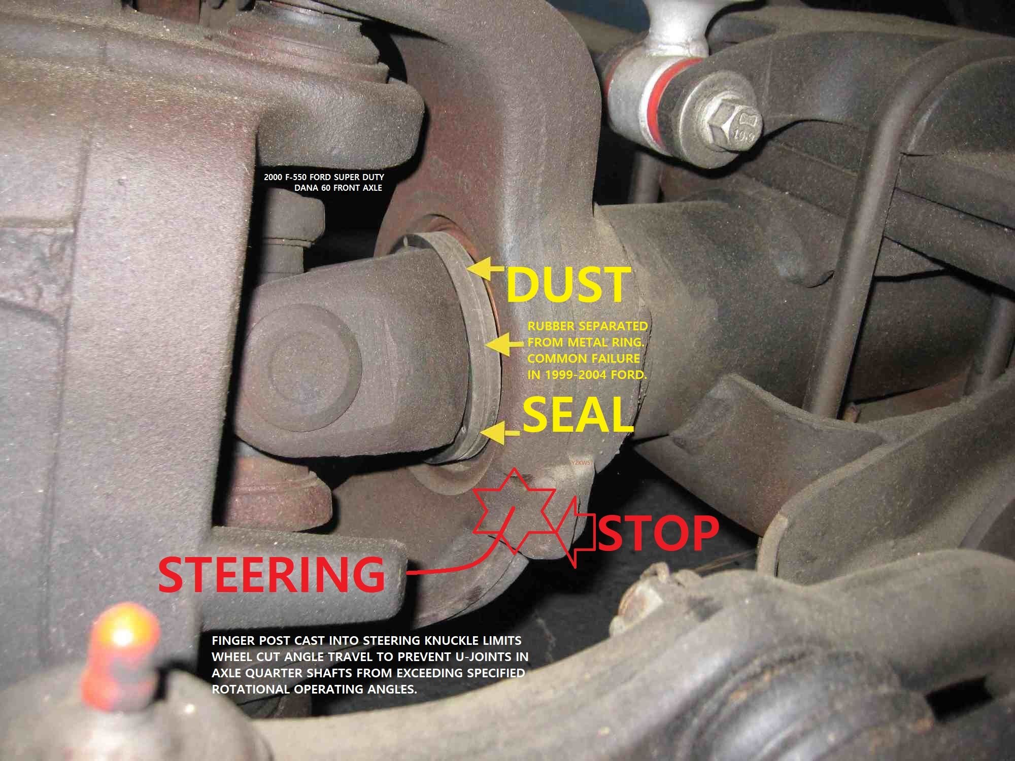

The steering gear box internals are what appears to limit the steering angle, there are no stops that I can tell. I suppose you could make a custom longer pitman arm that pulls the linkage farther than the stock one does, but most people go to a 2005+ coil sprung front axle if they want to tighten the turning radius, they turn tighter than the '99-04 leaf spring axles. My '99 F-450 4x4 has a very wide turning radius and I usually end up either "cheating" and pulling off the driveway into the grass in order to get more room to back trailers into the machine shed, or I make multi-point turns. A front hitch would help a lot too, you will take a lot less space to get the trailer in the garage.
