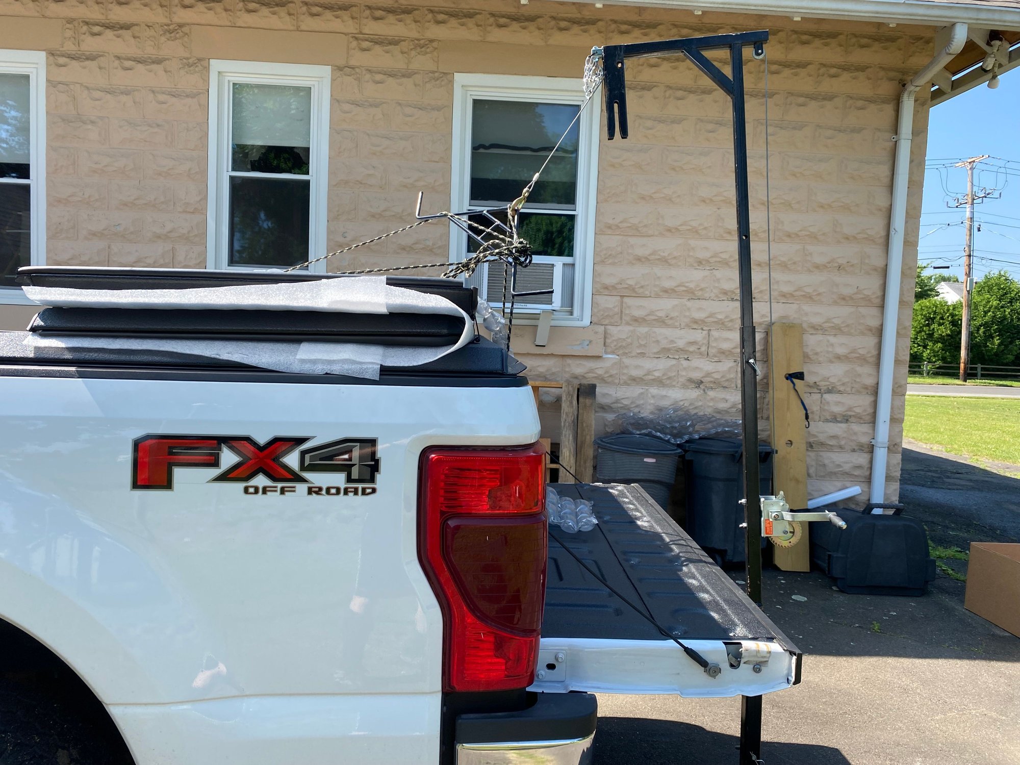

FWIW:
Some other, non-winch related ideas depending on what you are loading:
Depending on what you are loading a cable between the front bed tie downs and a come along will work and we loaded many a deer and other stuff that way by pulling it up a ramp.
Another option for loading things is a hitch mounted lift like I use to get deer in the truck, along with all kinds of other stuff. I have used mine to load all kinds of things form air compressors to my new tonneau cover. You can make an offset mount so it is off to the side.
Bob

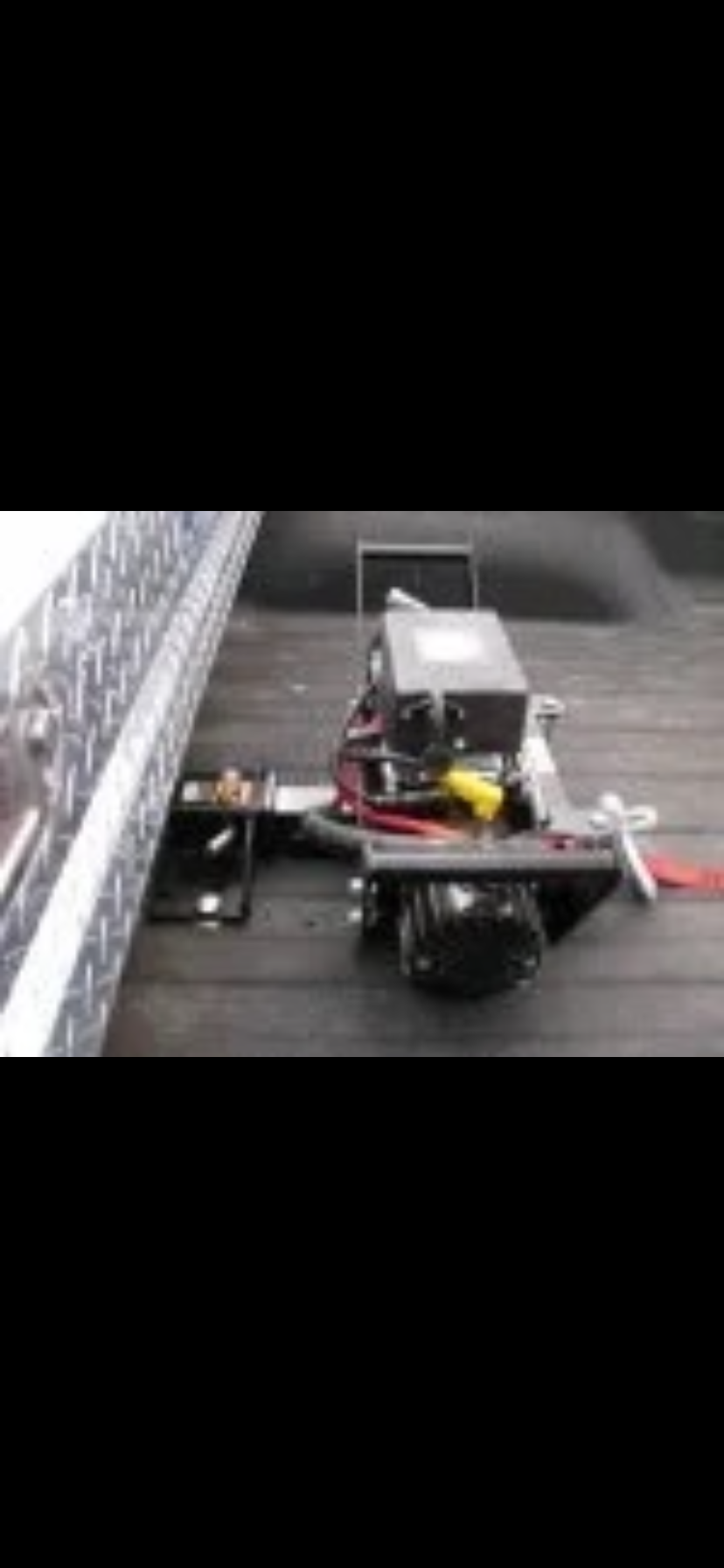

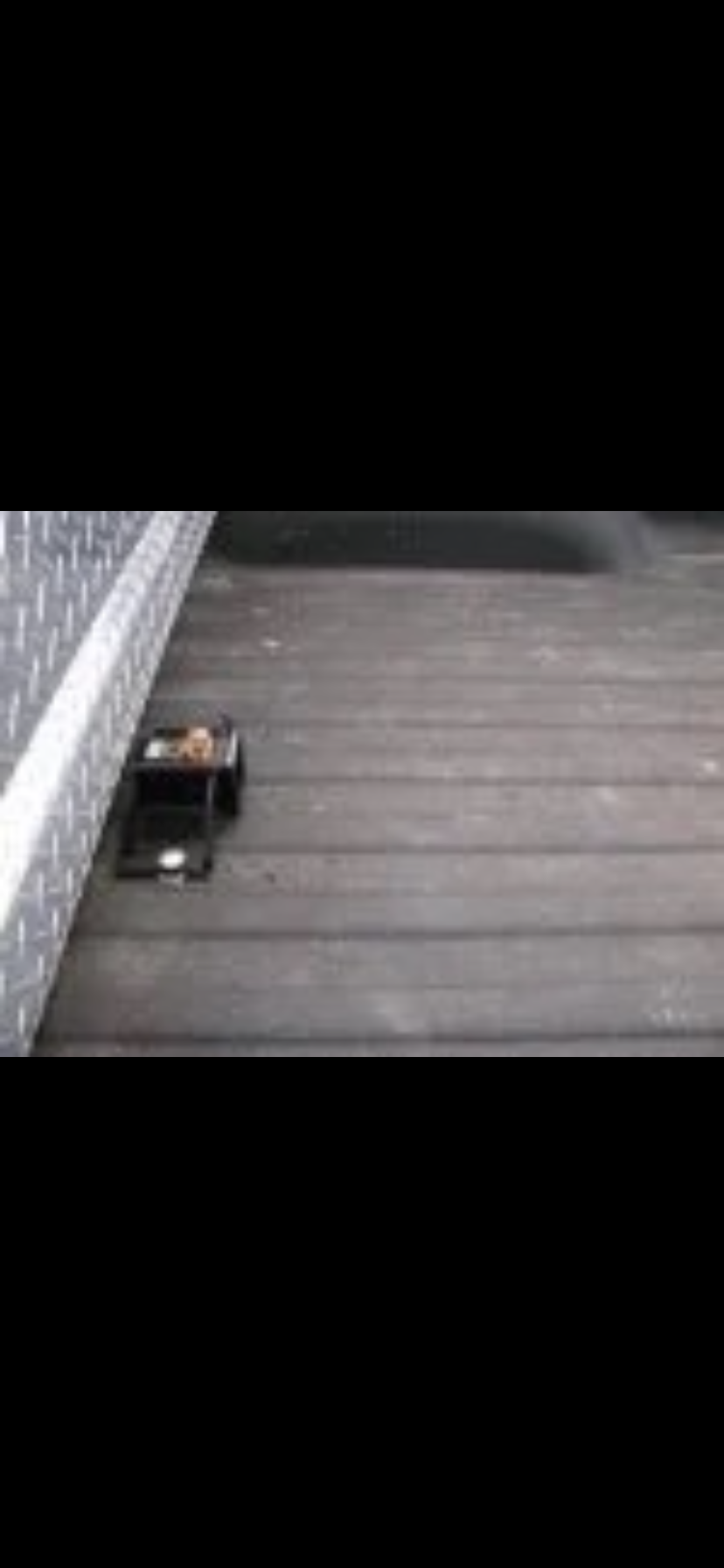

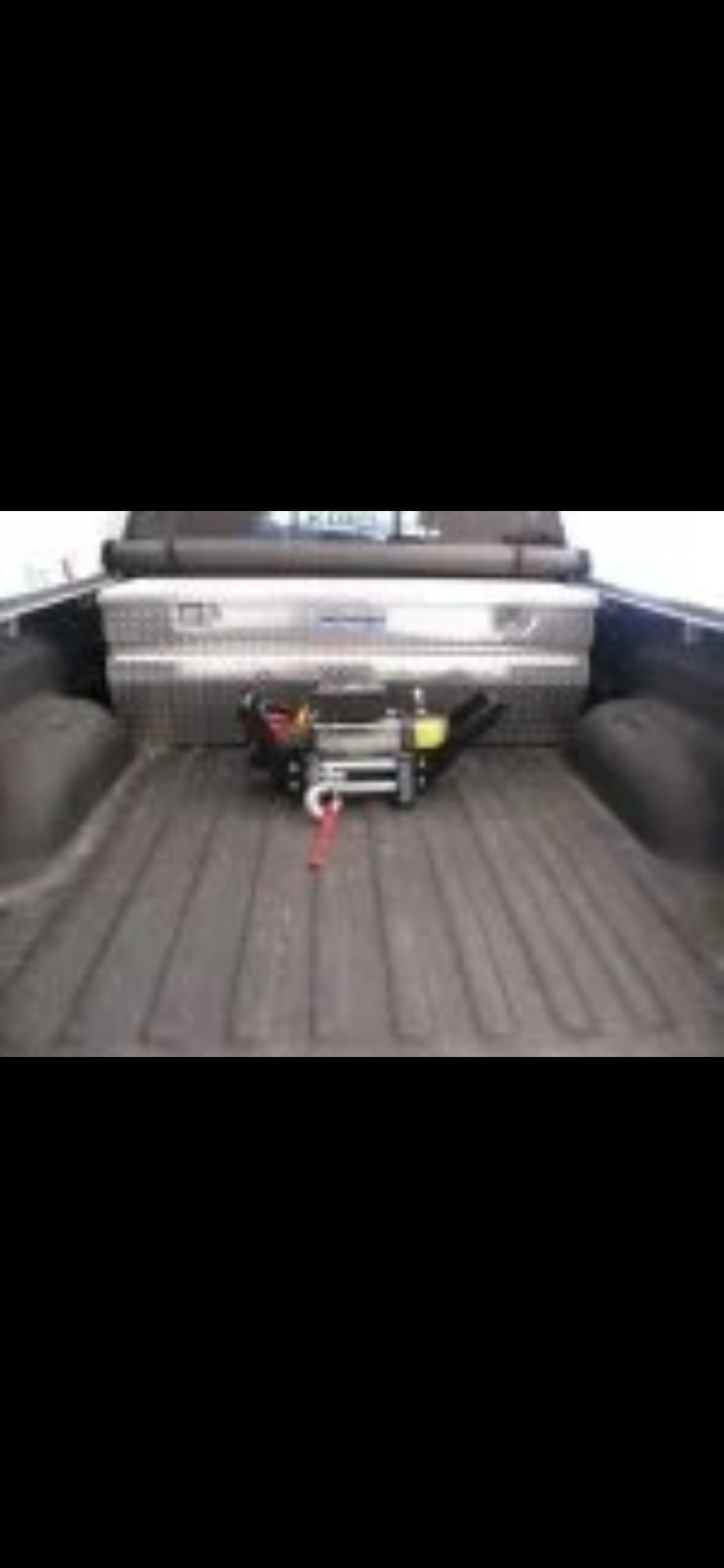

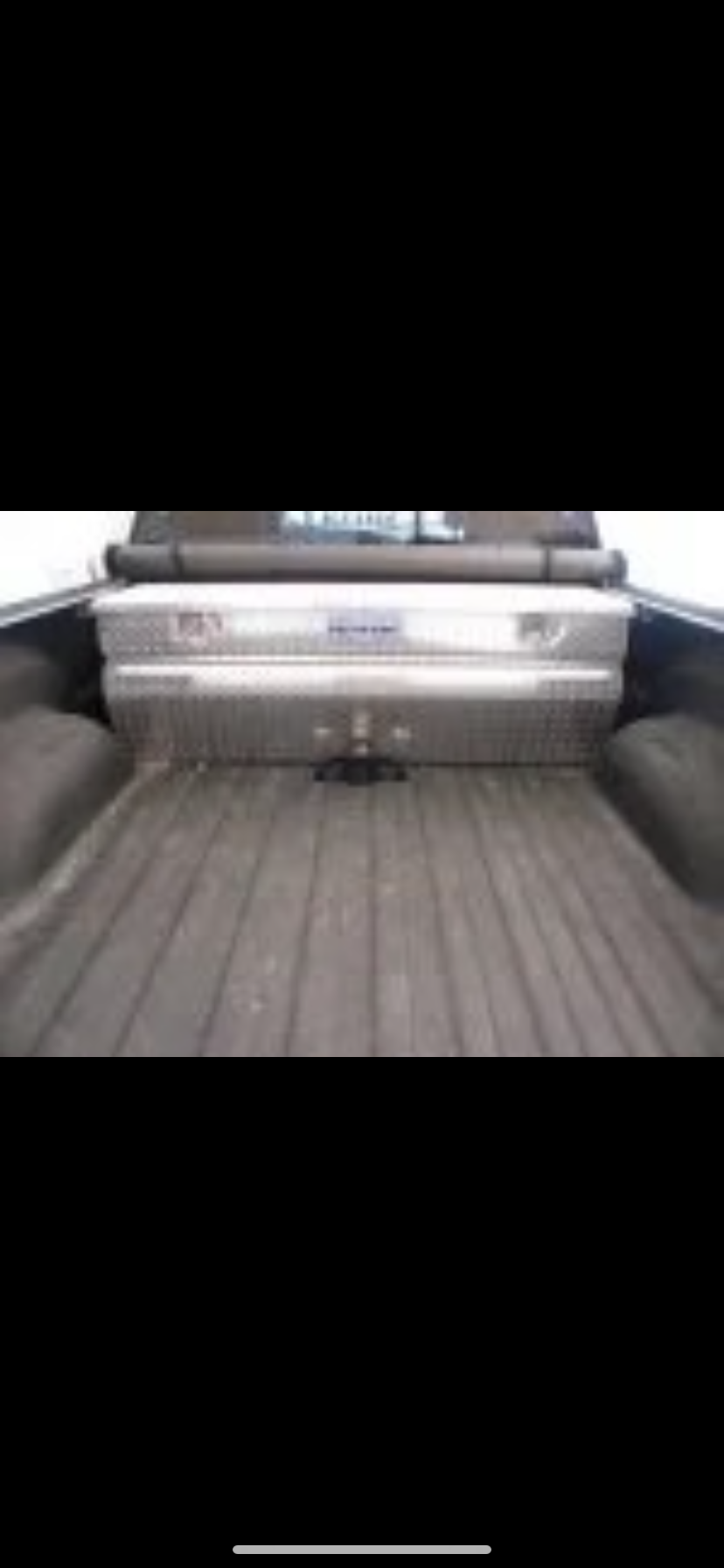

I found this looking around. Not sure if it was what you were looking for because your information for the use was not enough.
I do like the portable winch cradle that could be used for other locations.
Old Jul 17, 2025 | 12:51 PM
wabirch's Avatar
wabirch
4wd Low
Joined: Dec 2018
Posts: 10
Those pictures are very close to my planned layout. I am only pulling up a few hundred pounds that is set upon a moving dolly and being pulled up a ramp.
I do have a 8,000 going on a hitch mount cradle, for either front or rear use.
Thanks for sharing those pictures.

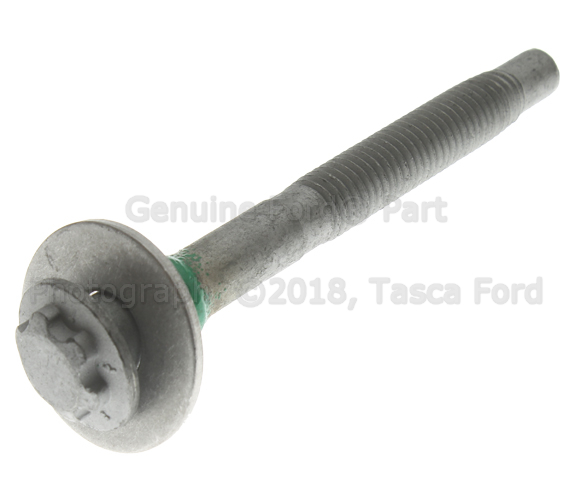

After looking at the need to drill for an under tool box location I think an easier solution will be a mid bed installation using the existing bed fastener.
Does anyone think I can cheat 1/8" (just over 3mm) from the bolt length of the shorter bed fastener (114mm I think) or should I use the longer bed fastener (130mm I think) and just add washers to take up the extra length of the longer bolt? I realize I have a half inch obstacle in the bed without the winch in place with using the longer bolt.
Here's what I am seeing for the two bolts. The longer bolt is for the tailgate end of the bed..
W718818S902 - Body: Mount Bolt for Ford: F-250 Super Duty, F-350 Super Duty Image
Mount Bolt
-W718818-S902
FordFord
Notes: PARTS: Part cannot be reused/reinstalled.
Description: 6.75 foot box, m14x130. 8 foot box, rear. Body mounting, crew cab, bed, rear. 6.75 foot box, front. 8 foot box, front. Body mounting, super cab, bed, rear. Body mounting, regular cab, bed, rear. 6.75 foot box. rear.
MSRP $12.50
$7.28
View Details
W719365S902 - Body: Mount Bolt for Ford: F-250 Super Duty, F-350 Super Duty Image
Mount Bolt
-W719365-S902
FordFord
Description: 6.75 foot box, m14x114. 8 foot box, m14x130. 8 foot box, front. Body mounting, crew cab, bed, front. Body mounting, super cab, bed, front. 6.75 foot box, rear. 8 foot box, rear. Body mounting, regular cab, bed, front. 6.75 foot box. center. 6.75 foot box. front.
MSRP $12.50
$7.28
View Details
