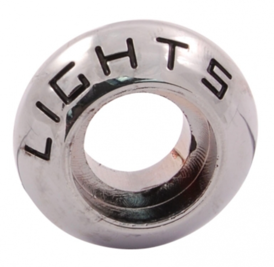

My understanding is completely different...
You press the spring loaded button highlighted below and pull on the **** at the same time. This releases and removes the **** and shaft from the switch.
With the **** removed, one can use the special bezel tools or a screwdriver to remove the bezel nut that threads into the switch sandwiching the dash and bezel.
Bezel Nut
Bezel Nut
Bezel
Bezel
Once the bezel nut is unthreaded, the switch and bezel are free from the dash.
Installation is reverse of the removal: Position the light switch behind the dash and the bezel in front of the dash. Thread the bezel nut into the light switch and sandwich the dash and bezel. Press the spring loaded button on the switch assembly and insert the **** and shaft. Release the button and that should be it.
If you need a new 55 light switch assembly, Dennis Carpenter has them on sale right now:
https://www.dennis-carpenter.com/tru...adlight-switch
Bezel Nut
Bezel Nut
Bezel
Bezel
joe was asking how to remove the ignition switch not the headlight switch but your post is correct for headlight switch removal as well
