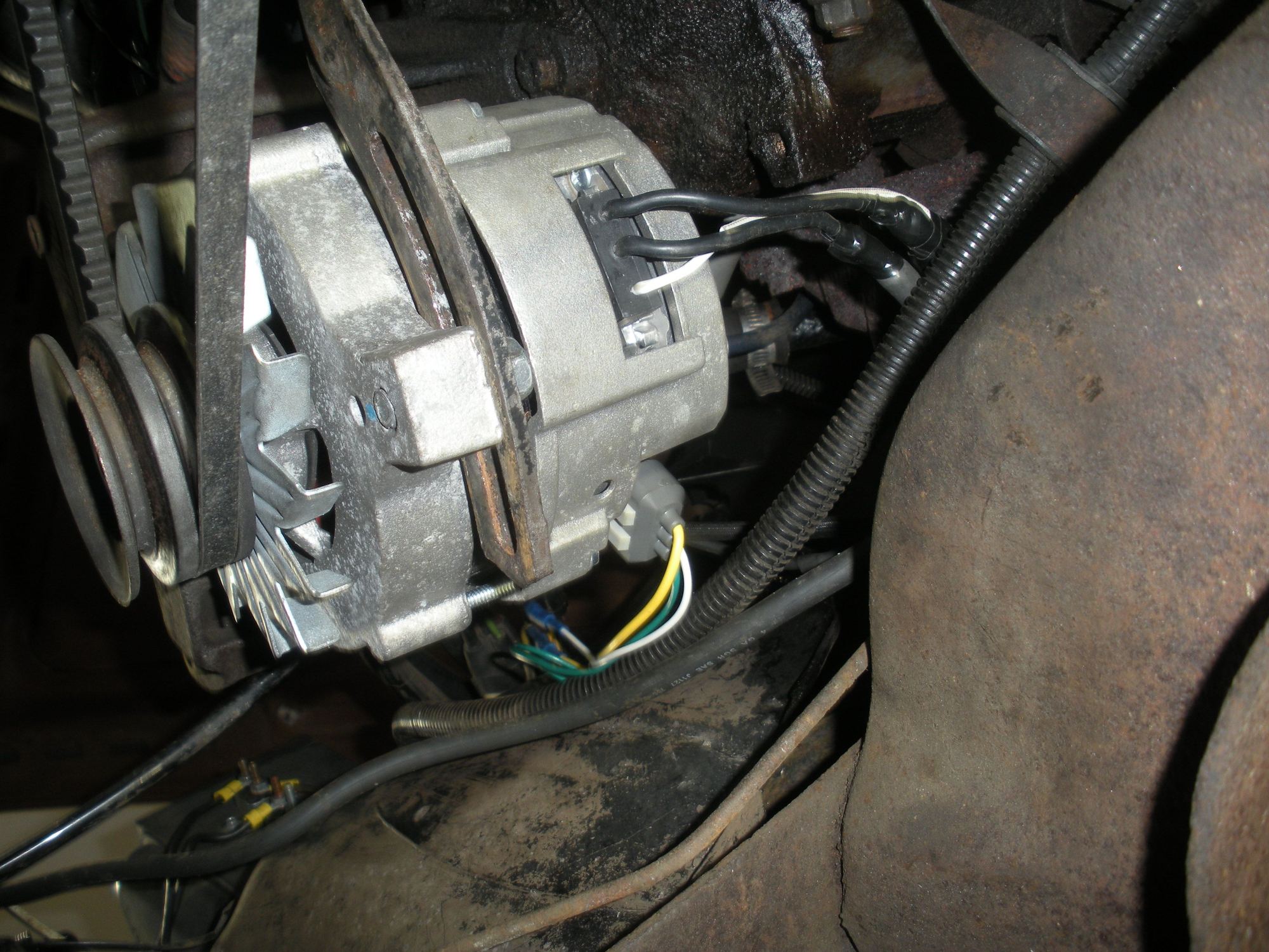

While we're on the topic of power, what does your Alt connections look like ? Have you upgraded the OEM 2G connectors to new improved ones ? The newer 2G Alt, comes with an integrated power connector, and you can splice in a new Voltage Regulator connector.

I have replaced the alternator connector in the past, but didn't do that same upgrade. That will have to go on the "future projects" list, as I've got a few other things more pressing at the moment.
