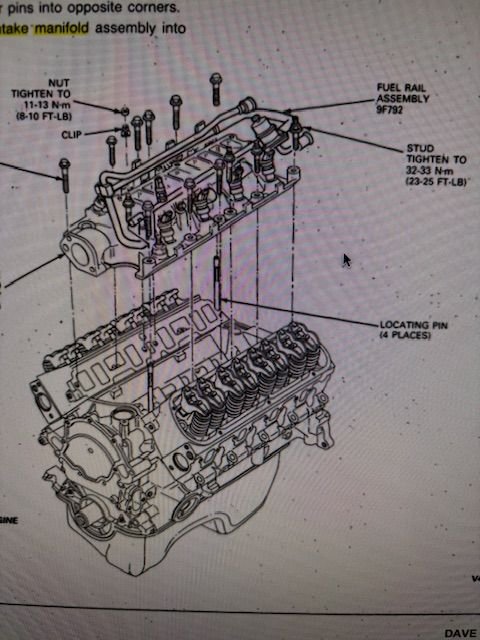

From the 1989 service manual:
How did you lose all of those bolts? They are probably all in the same place that you left them.
M6-1.25 x 21mm

Originally Posted by dremtofford
I have the lower intake on but the book shows the bolts but not the sizes. went to the hardware store and bought some studies and nuts now to get the bolts for the fuel rails.
Why would it show the sizes? You should already have the bolts. It does show that there aren’t studs in all the places that were mentioned to have them.
Good luck finding the fuel rail bolts at the local hardware store.
