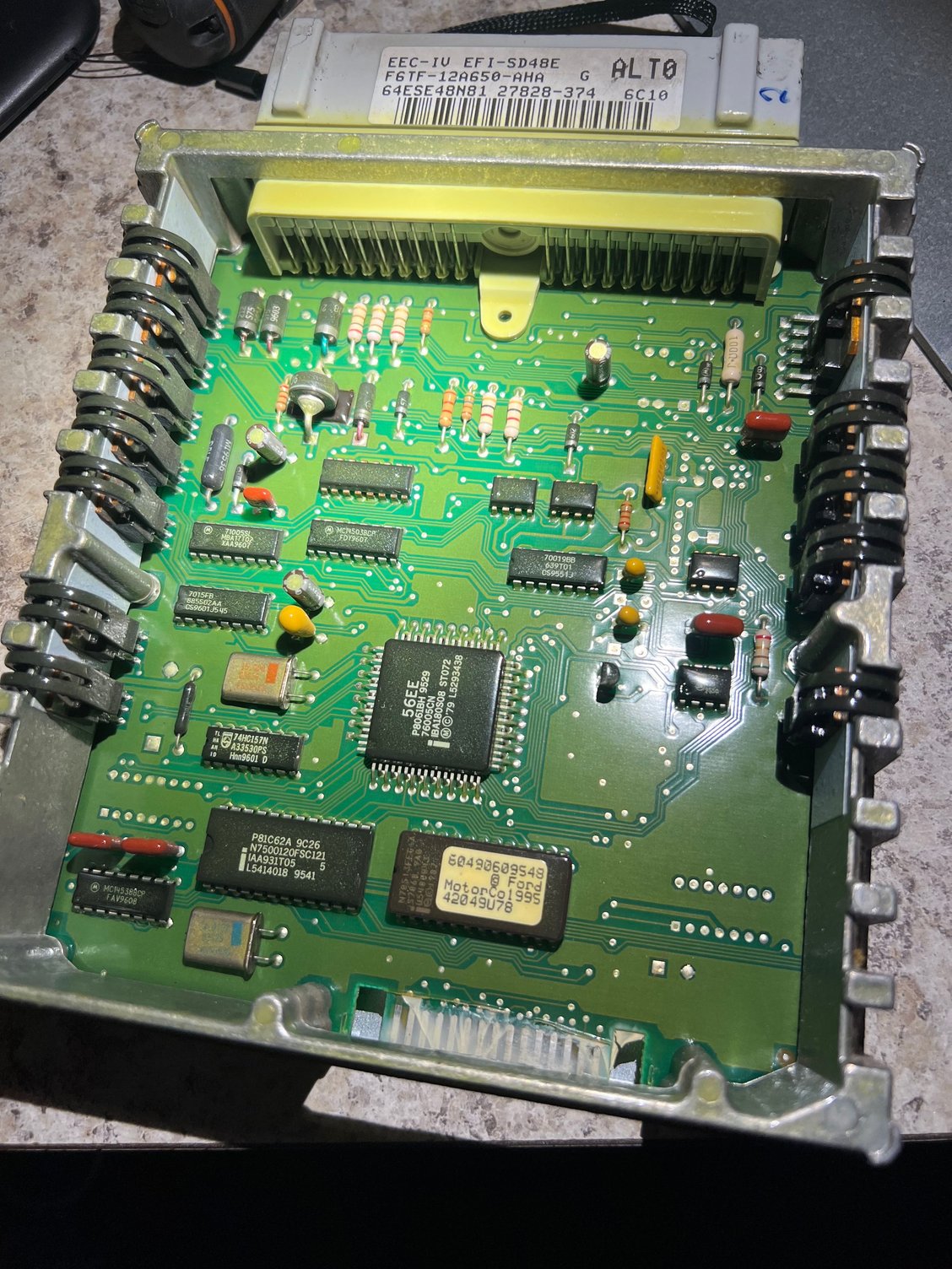

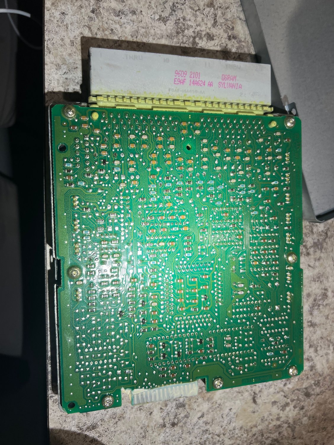

Old Jul 20, 2025 | 01:02 PM
DannycP's Avatar
DannycP
Trailering
Joined: Jul 2025
Posts: 20
Originally Posted by Mark Kovalsky
Then chance are the PCM is bad. If nothing is wrong there should be a code 11, which is the system pass code.
Hey Mark, pulled the PCM and inspected for any leaking capacitors and didn't really see any at least to me. Judging by this photo is it possible for you think I can rule this out or should I still send it off for testing? Thanks in advance
