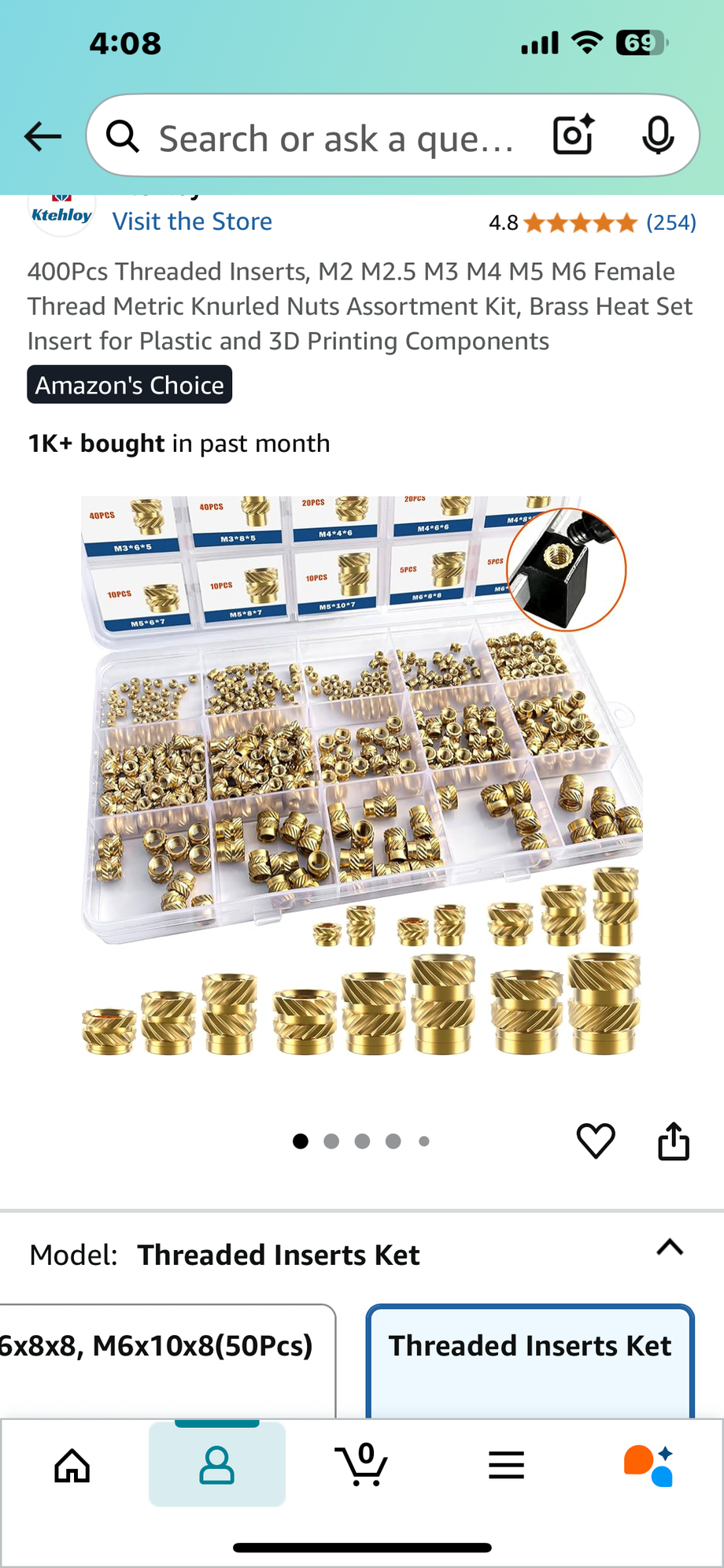

Or one of these…shop by size….i use them all the time…designed for plastic holes….simple
