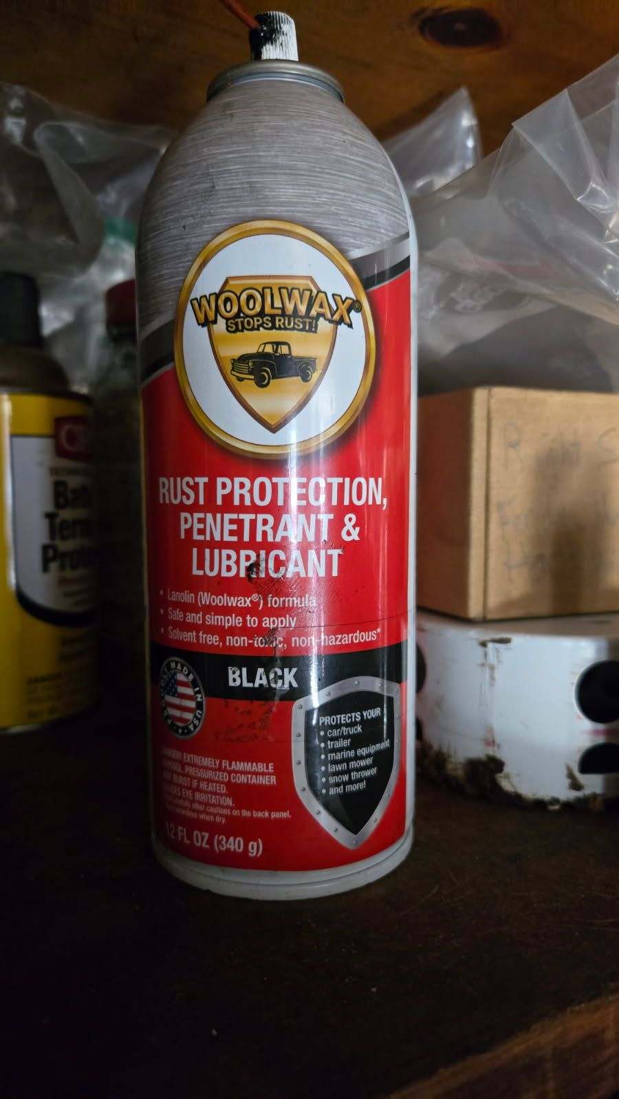

Last year I ordered two cans of their black Woolwax in spray cans to try it. IMO, it's better than Fluid Film and doesn't drip like Fluid Film as Fluid Film is thinner. I will buy some canned black with the extension wand to get into the closed parts of the frame and under the bed where the crap Ziebart caused the bed frame channel to rust on the end of the channel. After I retire, I want to pull the bed. Get it on stands to get at what corrosion is there which I believe is minimal but it is there on the inside.
Then I am going to buy the 2.5 gallon jug of black Woolwax, apply to the frame with a brush to the insides of the bed and underneath the cab/bed after some brief spot prep. I will definitely do a new thread on that.

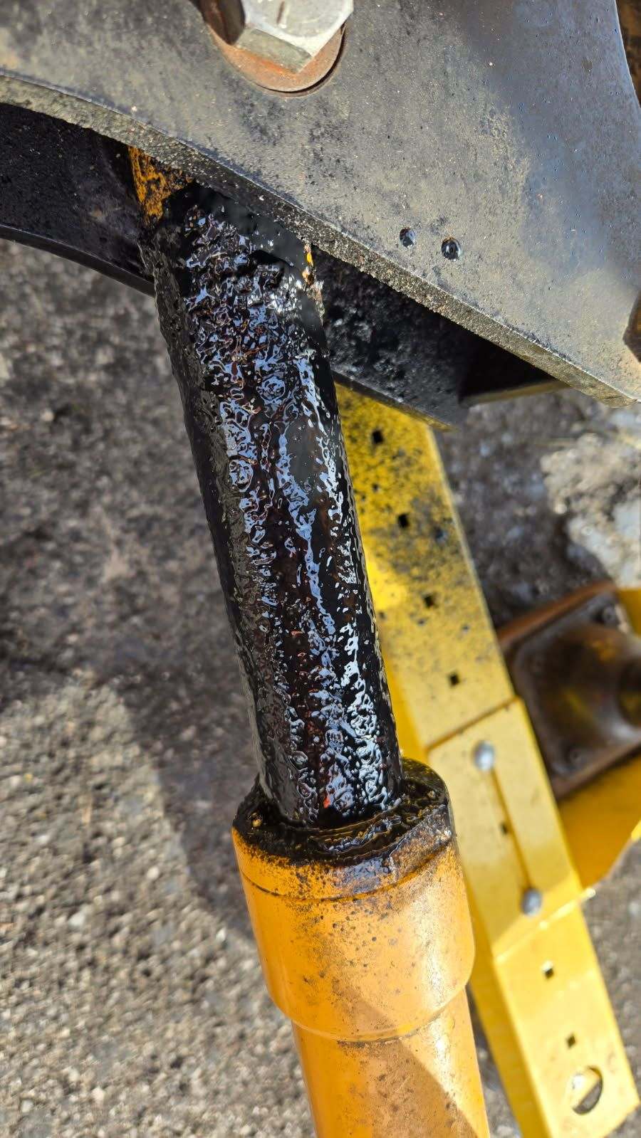

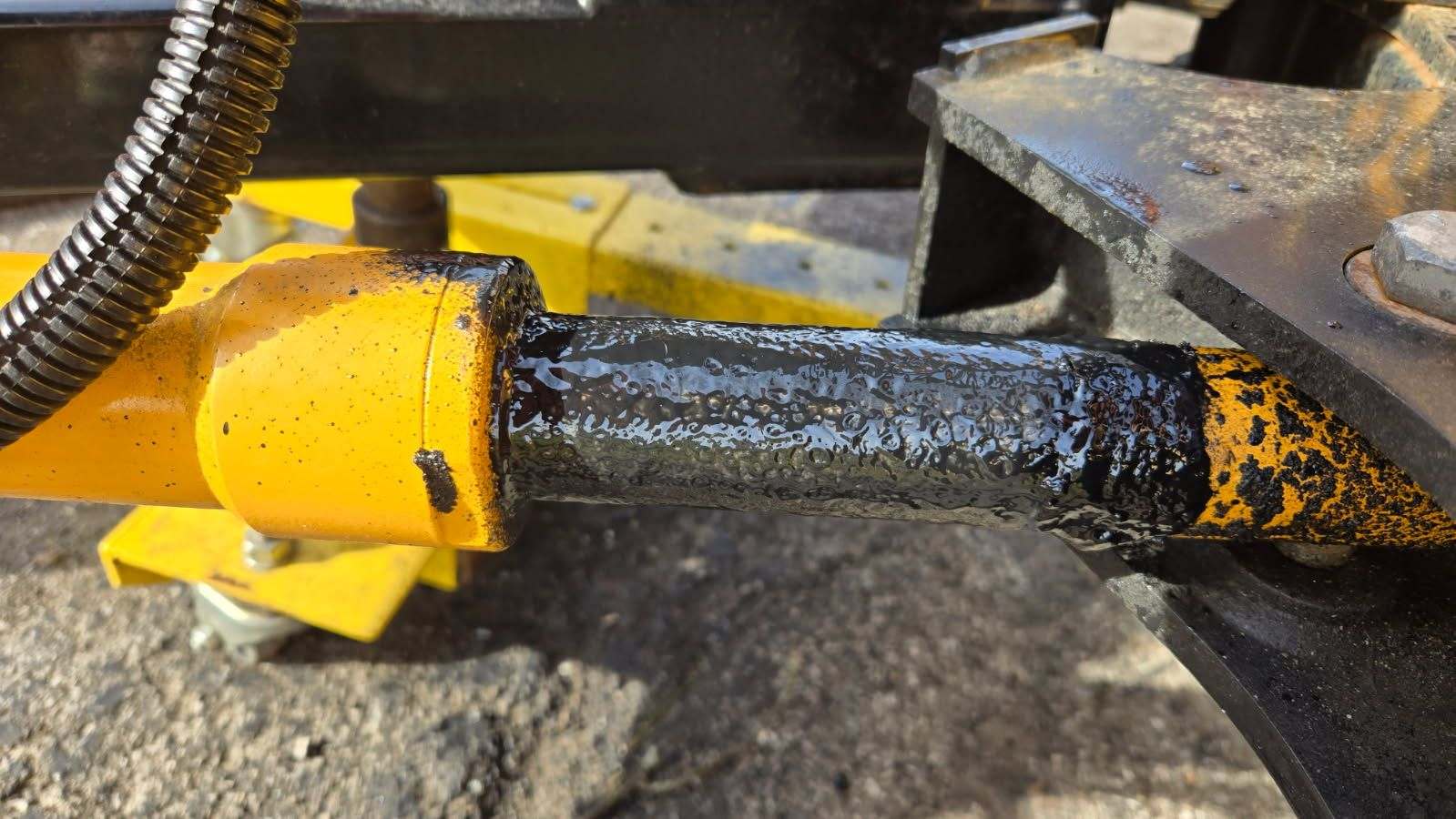

This is when I just sprayed it on my plow rams... it was still wet there.
This stuff covers way better than Fluid Film that I used to spray on these.

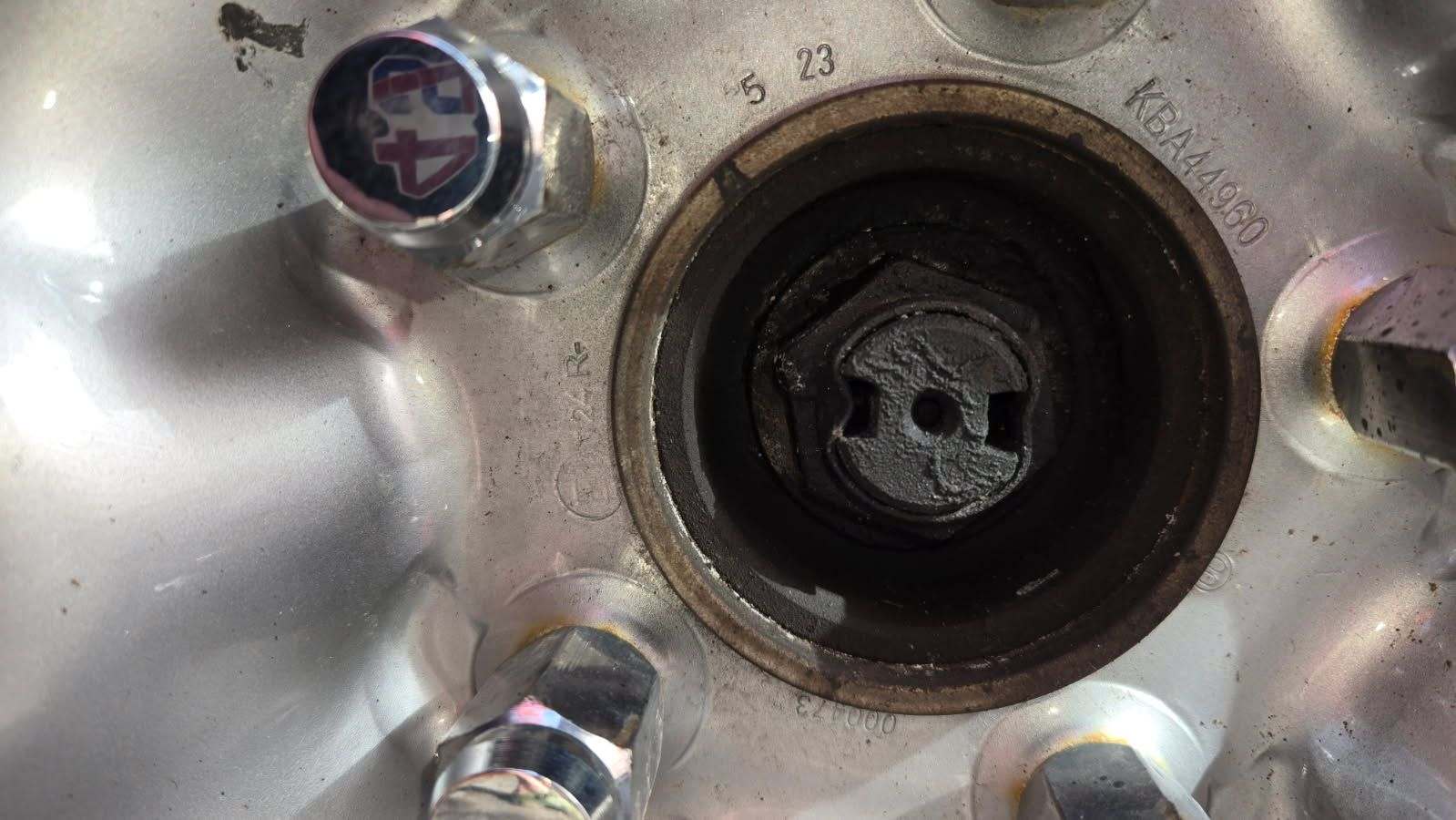

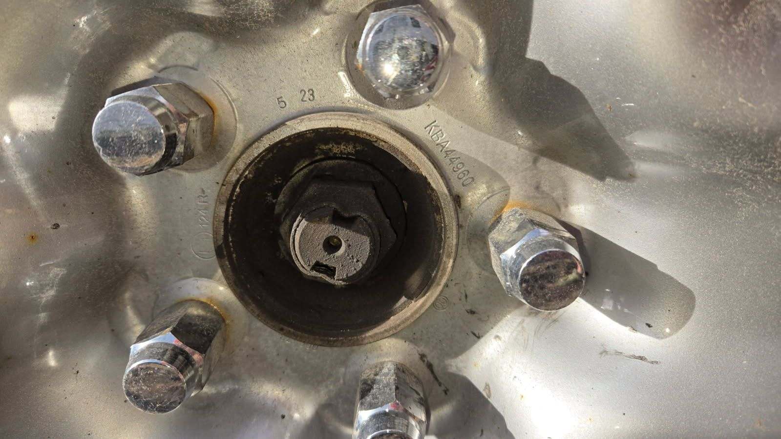

Here's my wife's car after this past winter... sprayed it on her bearing nuts since the factory plastic inserts on the factory wheels would not work on the steel wheels I bought for the winter tires.
I highly recommend this stuff in conjunction with the oil spray... it's some tenacious schtuff...

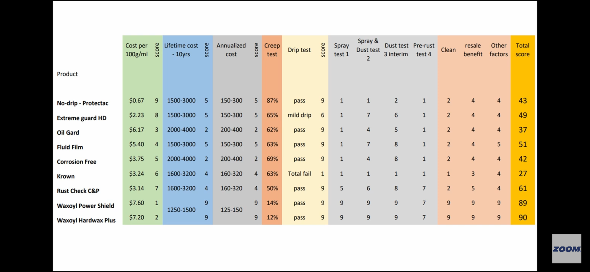

The stuff I’ll be using didn’t make this hit parade….but like the video says…some protection is better than no protection.

Either did Woolwax... there's another company I saw that's located in Rochester... but I'm good with Carwell for my truck. I like the fact they spray inside the rockers to keep it from rusting inside out and it creeps to get into all the crevices and cracks inside...

These are the pics I posted above... I took these the day I sprayed them this year, March 19th...
I took these today...
The plow sits on a dolly off to the side and my younger son plays basketball... must have hit it... just reapplied with some more. This sits in the rain and the Woolwax is unaffected. Much thicker than FF IMO...
