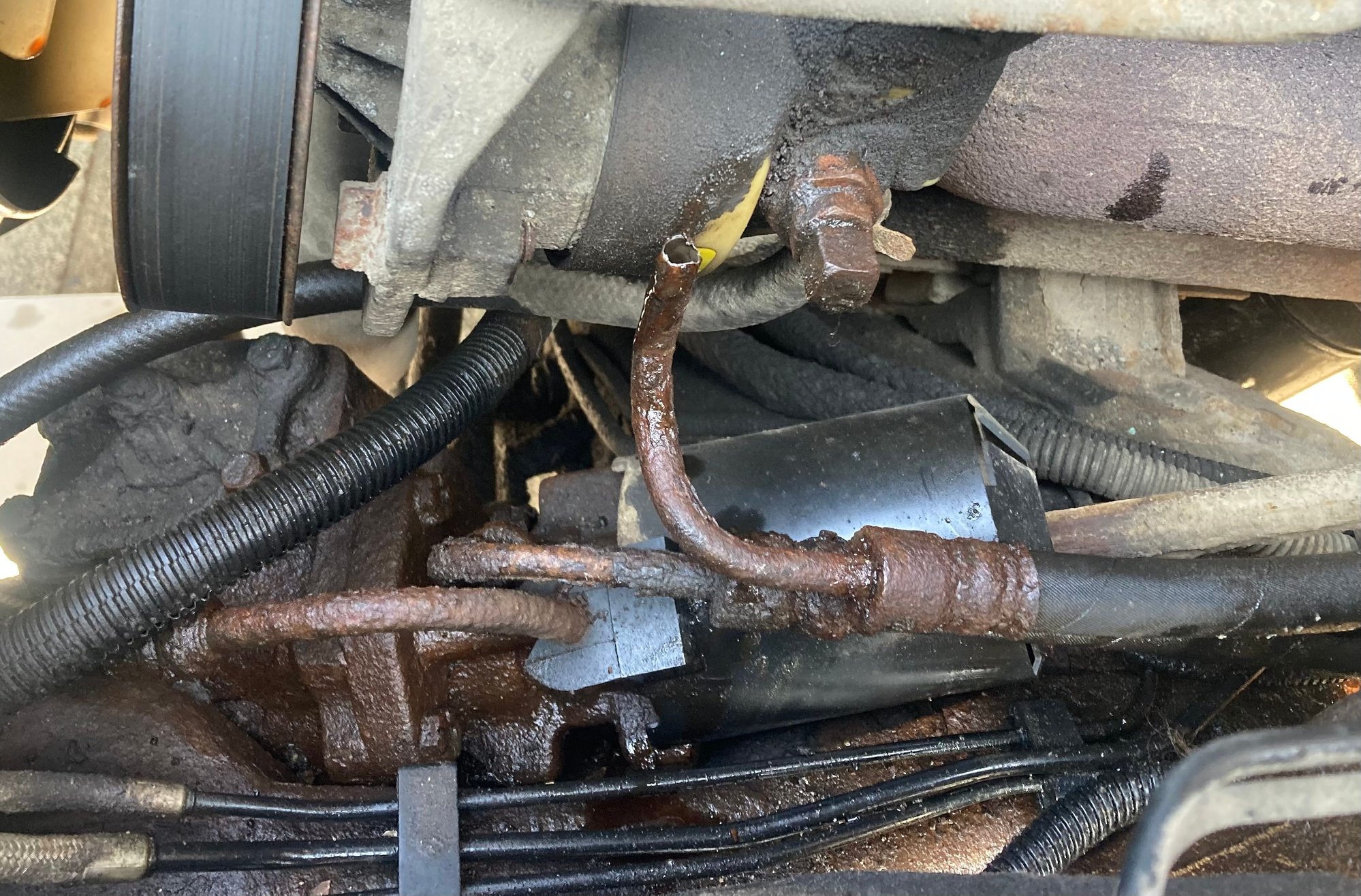

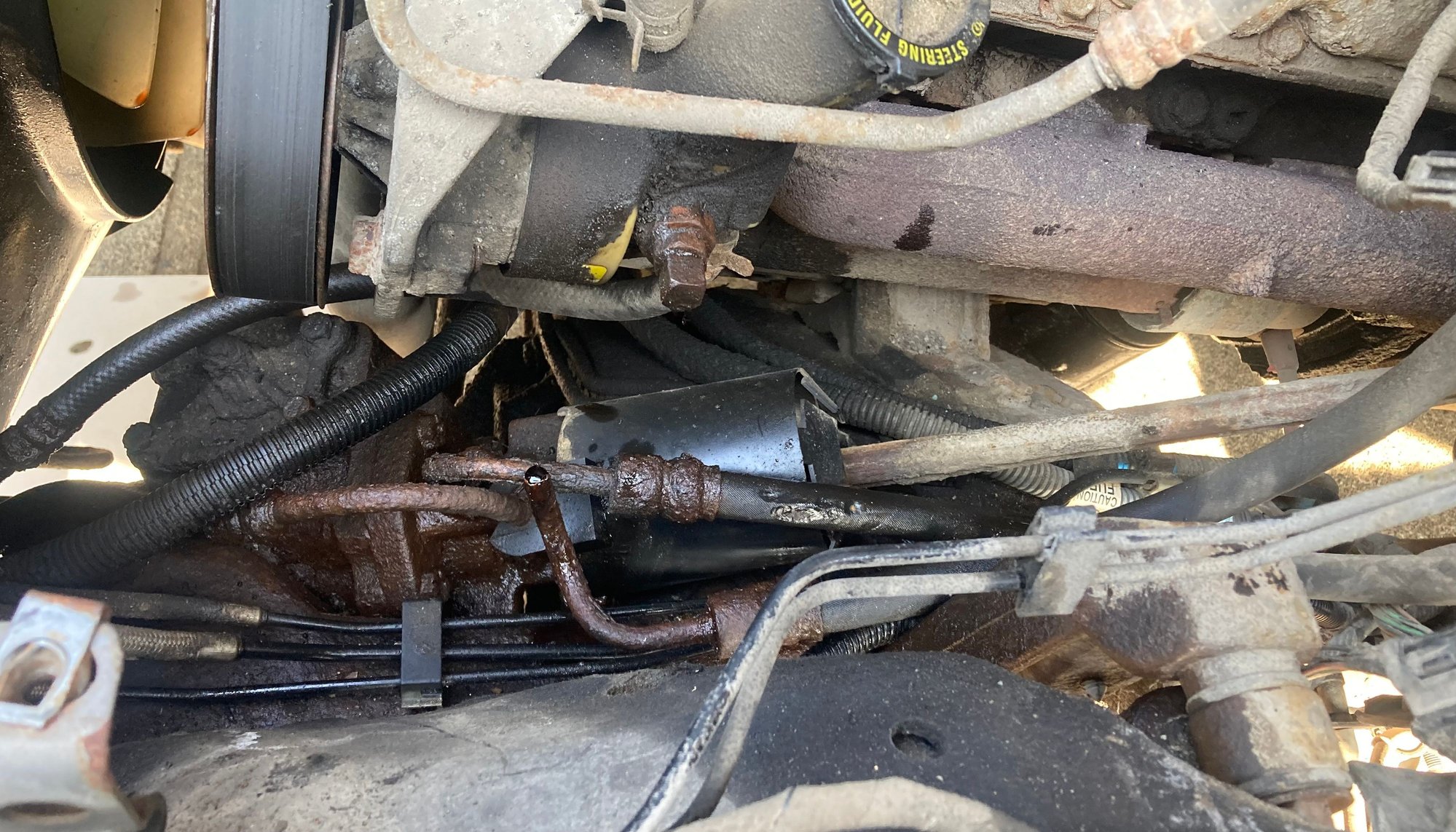

The metal tubing on my power steering lines on my 2002 F250 were totally corroded and fell off at the fitting.
This 7.3 l Powerstroke has the hydro boost system where power steering and the brakes are connected.
I highly recommend inspecting the metal tubing on the ends of all four lines. To properly see the lines you must remove both battery and air boxes.

The issue was the tubing going into the master cylinder was fine but unless you take those boxes off you won’t see the other sections of tubing. I was just trying to give others a heads up.
