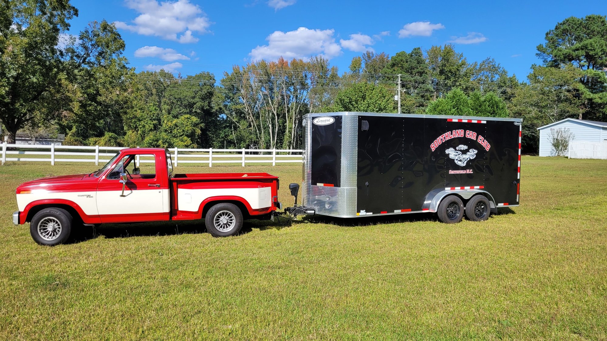

I say all this as I have a 81 F100 flare side 4x2 with a 300 six, NP435 granny 4sp to get a heavy load moving, Advance Adapter Range Splitter over drive where I can split all gears making my 4sp a 8sp transmission and 2.75 rear gears and 235 / 75 / 15 tires. Truck was setup, trailer brakes, to be back up to pull my 20' open deck car trailer of about 5K.
I have not pulled car trailer but have pulled the car clubs 20' enclosed trailer and I only pull it back roads, farthest out was 50 miles 1 way but most is 20 miles round trip.
If not for the granny gear and able to split gears it would kill my truck and no way I could use over drive as max speed is 55 MPH on the roads I travel and that is 1800 RPM.
Would it be better with 3.73 gears, why yes it would but I dont go far and pulling and like the gearing when empty so not going to change it.

This is what I pull on weekends

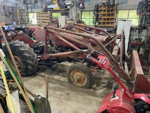

I don't see myself ever towing the tractor more than 20 or 30 minutes from my house, at more than 55mph, a more common load for it to potentially tow is a single axle utility trailer with thingns like tents and tables and chairs, or a bounce house or two, probably no more than 1500lbs. Unfortuantely I don't know what gears are in it right now, but i'm not opposed to trying to do a gear swap on it, this i'd be less scared to try it on than my JKU that the bank still owns most of. This wouldn't be my daily, and so if I had to spend a week doing some maintinence on it it would be fine, and I've considered the idea of carburator swapping it to remove the efi problem.
This is the tractor in question, this was before I got it and started working towards fixing it.

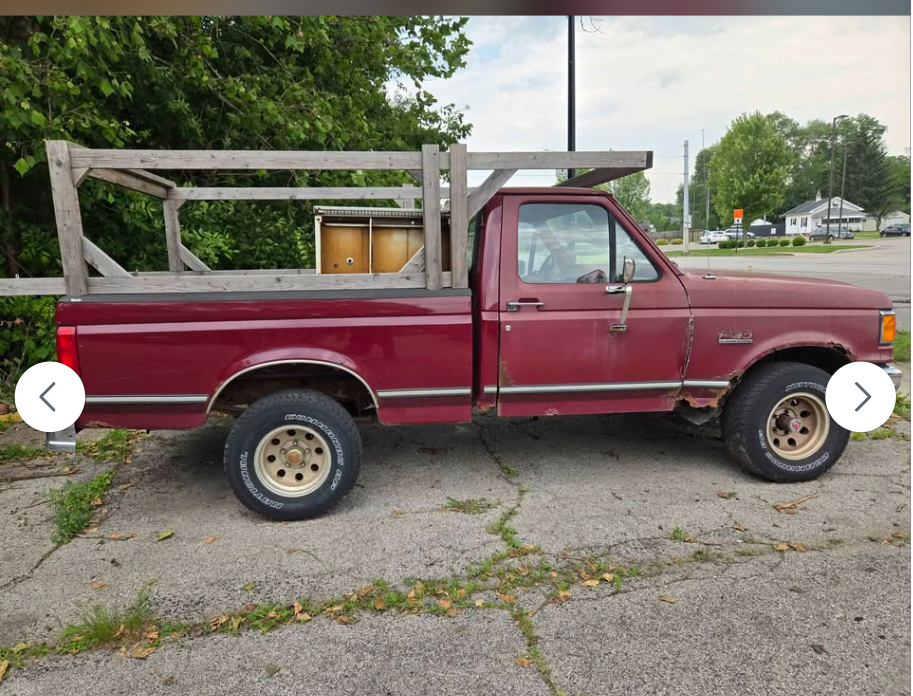

This is the truck in question by the way

The trailer would have to be pretty HD to haul that tractor that adds to the total weight being pulled.
For sure brakes on both axles and controller in the truck and WD hitch to make it happen.

Structurally that cab is toast. The bottom rockers are gone which will mean the the front cab mounts are probably gone and the radiator core support will no doubt be toast also. Probably make a good parts truck though.
I had a 89 F150 2wd that one time I pulled my 66 Caprice on a car trailer 80 miles. I know the car weighed 4765lbs + probably 1800 for the car trailer. While my truck had the 302/AOD with 3:55 gears, I was living life at 4000 rpm on any hill while trying to maintain 55 mph. It was just too much for the truck.
Try to find a F250 in the same vintage and it would probably better suit your intended use.

That cab is pretty much toast. Looks like the cab to bed gap is wider at the top,, and that leads me to think the cab mounts are all gone. Id pass. I think your concept is good... but look for a better truck.
