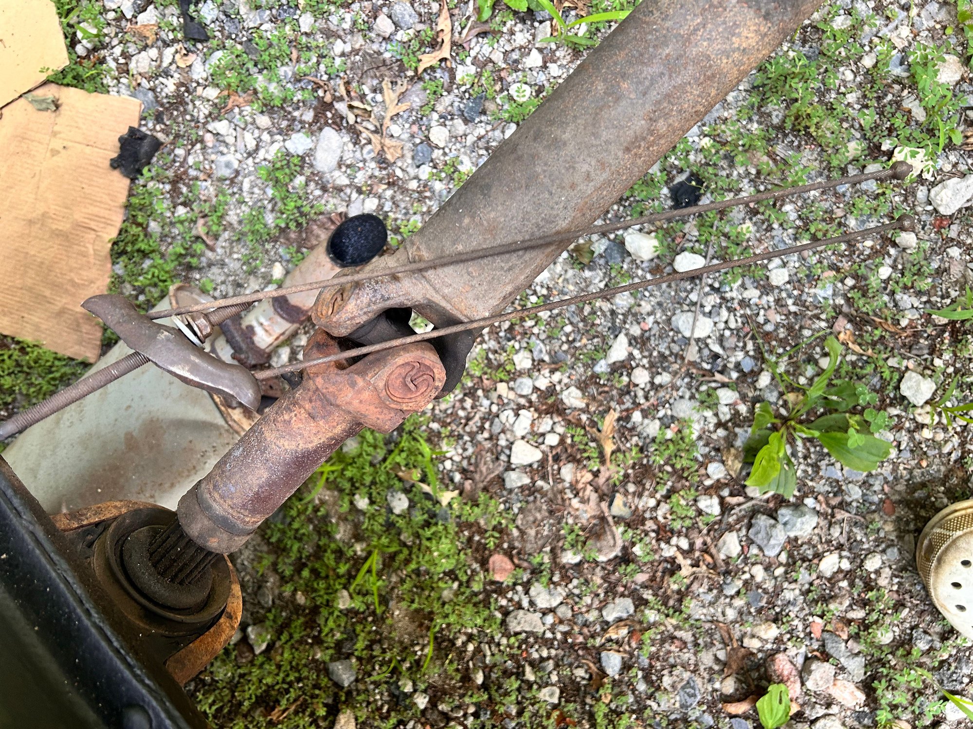

What is the originial question? What did I miss? Did the OP edit out his question? All I see is a couple pics of some extentions for the PARK brake cables.
As I recall, he had or bought a truck that had funny feeling brakes, and after pulling the bed for some reason, found the brake lines were plugged shut behind the cab back .... hence discussion brake lines, etc. I see the pictures, but I don't believe was any pictures before his edit. I don't think he even mentioned brake cables.

Likes: 5,789
Well those are e brake cables in his pics and the thread says nothing about plugged brakelines. But no big deal, because as alwasy you guys have him all new "brake" lined out. Lol
