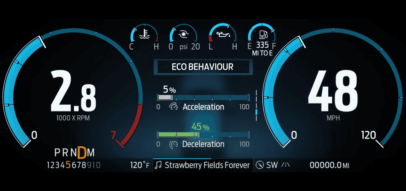

Is there a way to get the numeric RPMs to display in the RPM "gauge"? Exactly like you see with speed

Not to anyone's knowledge, but a very good idea!

The Forscan gurus here haven’t been able to do it yet (if it’s even possible). I believe the F150/Rangers are capable of it though.

my 22 f150 displayed a number
i didnt think i would miss it...but I DO
hey ford listen up

Numbers also show up on our 23 Expy! I hate that our 25 F350 has nothing in that spot!
