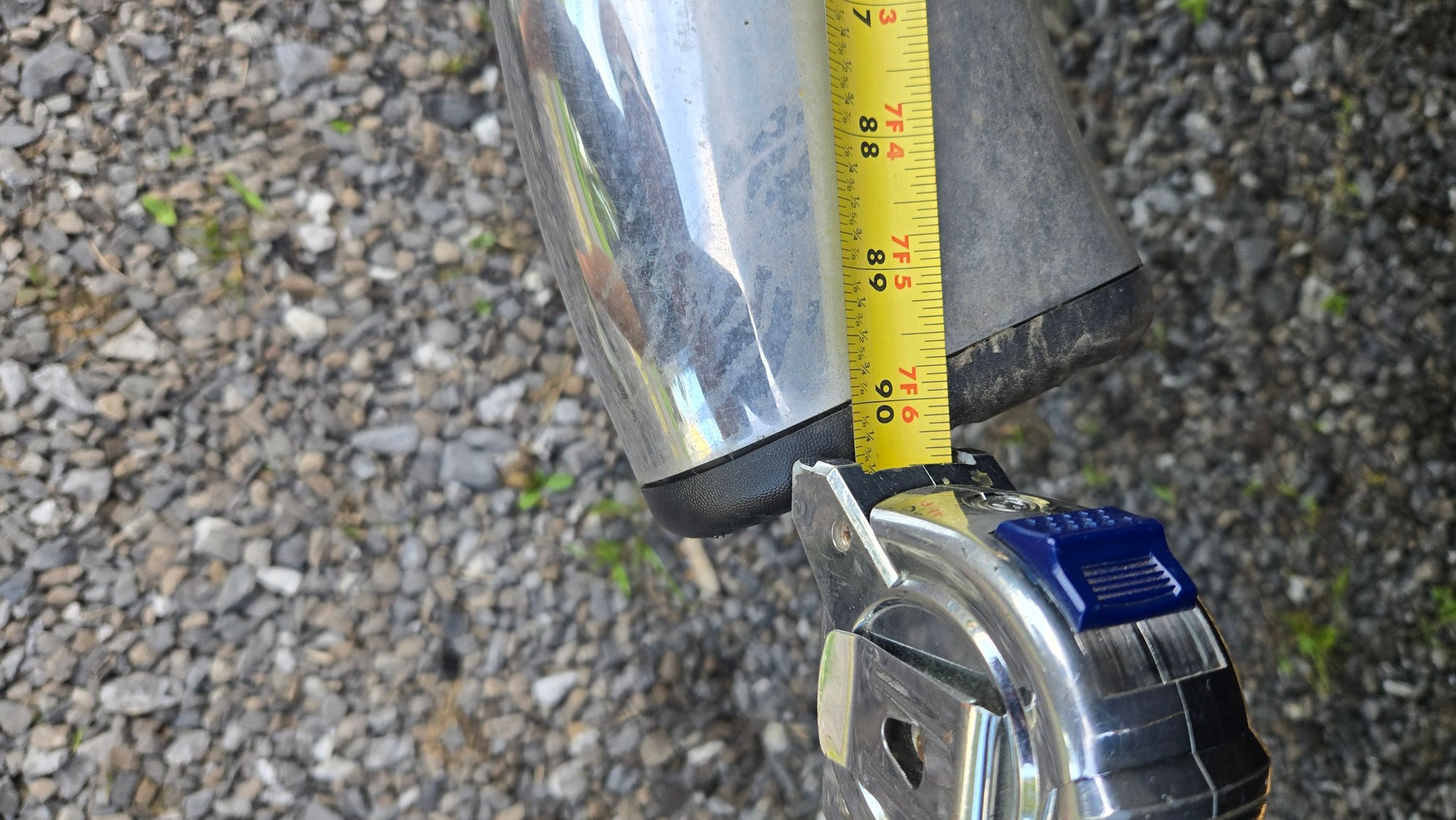

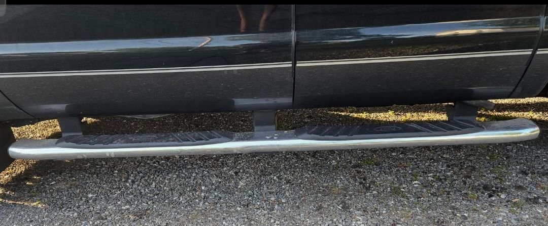

Okay just took measurements...
The running boards are just over 90 inches long...
I measured from about the center of hump on the mounting plate to the other...
Center of front plate to center of middle plate... about 36 inches.
Center of middle plate to center of rear plate... just over 35 inches.

I should probably look for a set off an extended cab. 90” is approximately the start of the rear wheel well. Middle of rear mount to middle of center is about 21”. Middle of center mount to middle of front is around 23”.

I'd say so. You're welcome and good luck.
