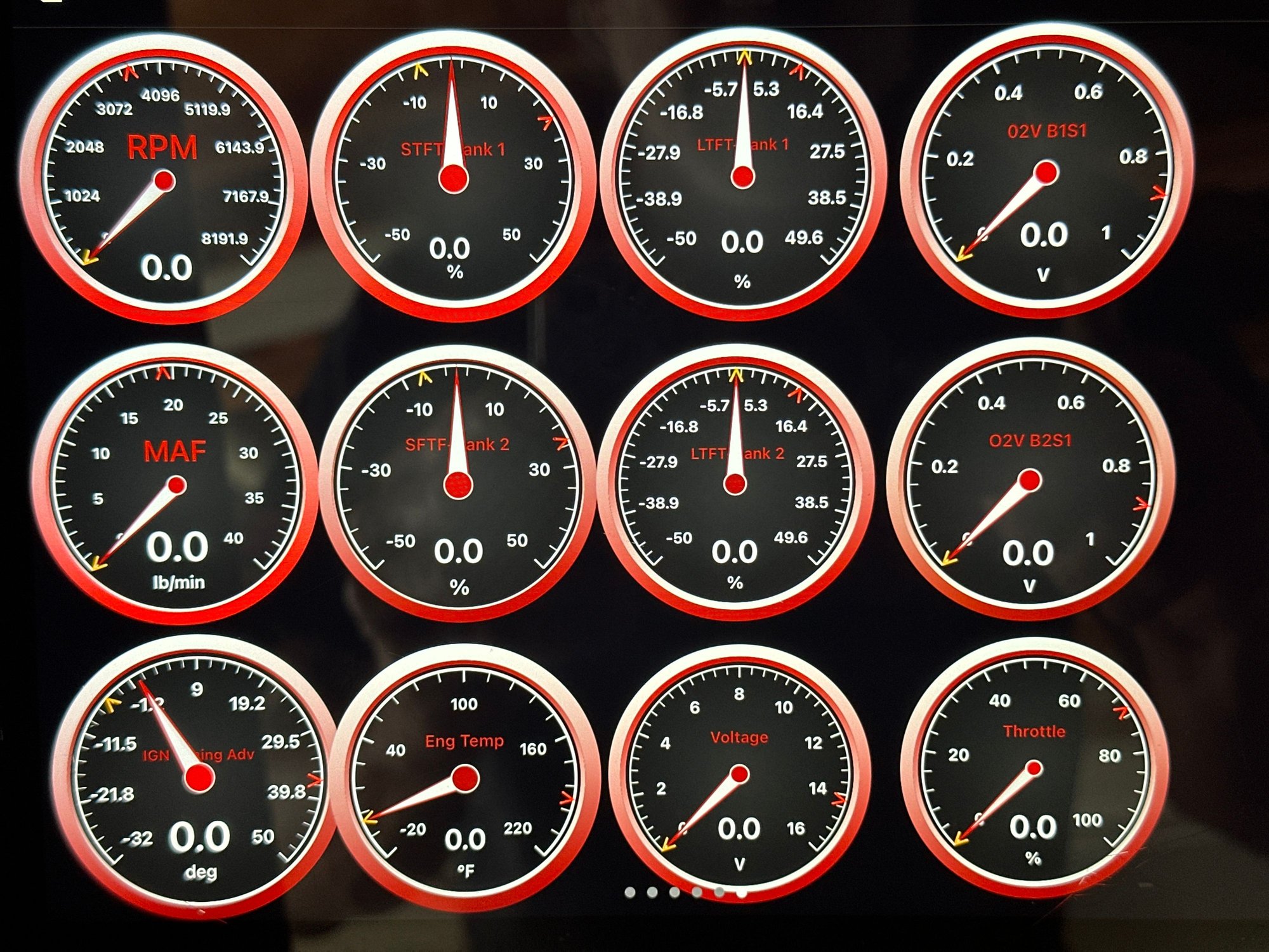

If you wanna really keep up on it and have the peace of mind behind knowing all systems are operating at their peak, get an OBD2 for the rig, install one of the apps,( I have OBDFusion) and periodically run tests. It’ll pick up even subtle things you’d pay a mechanic 3 hundo to do. Example, just today I ran the diags on mine cuz I just got new exhaust installed. Turns out, my Short Term Fuel Trim Bank 1 percentage was off slightly. Going by the steps my Master Mechanic (ChatGPT-no ****) advised, I cleaned my MAF Sensor and gotdamnit if that didn’t fix this little issue. Cost me about $9 for the cleaner and maybe a couple hours. What do ya think some crap like this woulda cost us dropping our beloved Excursions off at a place where to the fool workin on them wasn’t even born when ours was? On the ChatGPT thing, homeboi told me what dashboard to build on the OBD2 app and how they all play a part in painting the overall health of all systems.if ya have never used it, it’s free. Both the app and the site. I wouldn’t know jack. Here’s a pick of the gauge config I was instructed to build.

Thanks for the tip on OBDFusion. I do have an android head in the dash and I bet I do have an ODB2 reader somewhere. Looks like a very good tool.
Great that we use the same mechanic .
